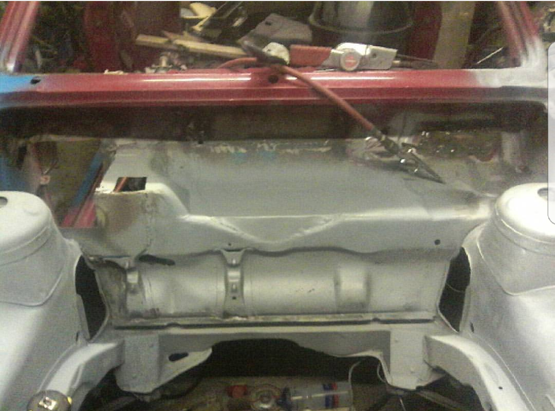

I have repaired and fixed the rust hole on the bottom left side of the windscreen just needs abit more tidying up.DSCF1299_zpshce51avy.jpg
ive also finished smothing the hole where the carbon can thing was in the engine bay. i bent the piece of metal to suit the bends in the engine bay. i still need a layer of filler but you get the idea. HAHA
Other things that have happened.is that i have welded up the patch for smoothing the place where the heater originally went,
Still need to grind down the welds and fiberglass and filler it obviously but its getting there.
i have also patched up the hole where the wire use to come through to the engine bay.  still need to grind it down and filler it aswell.

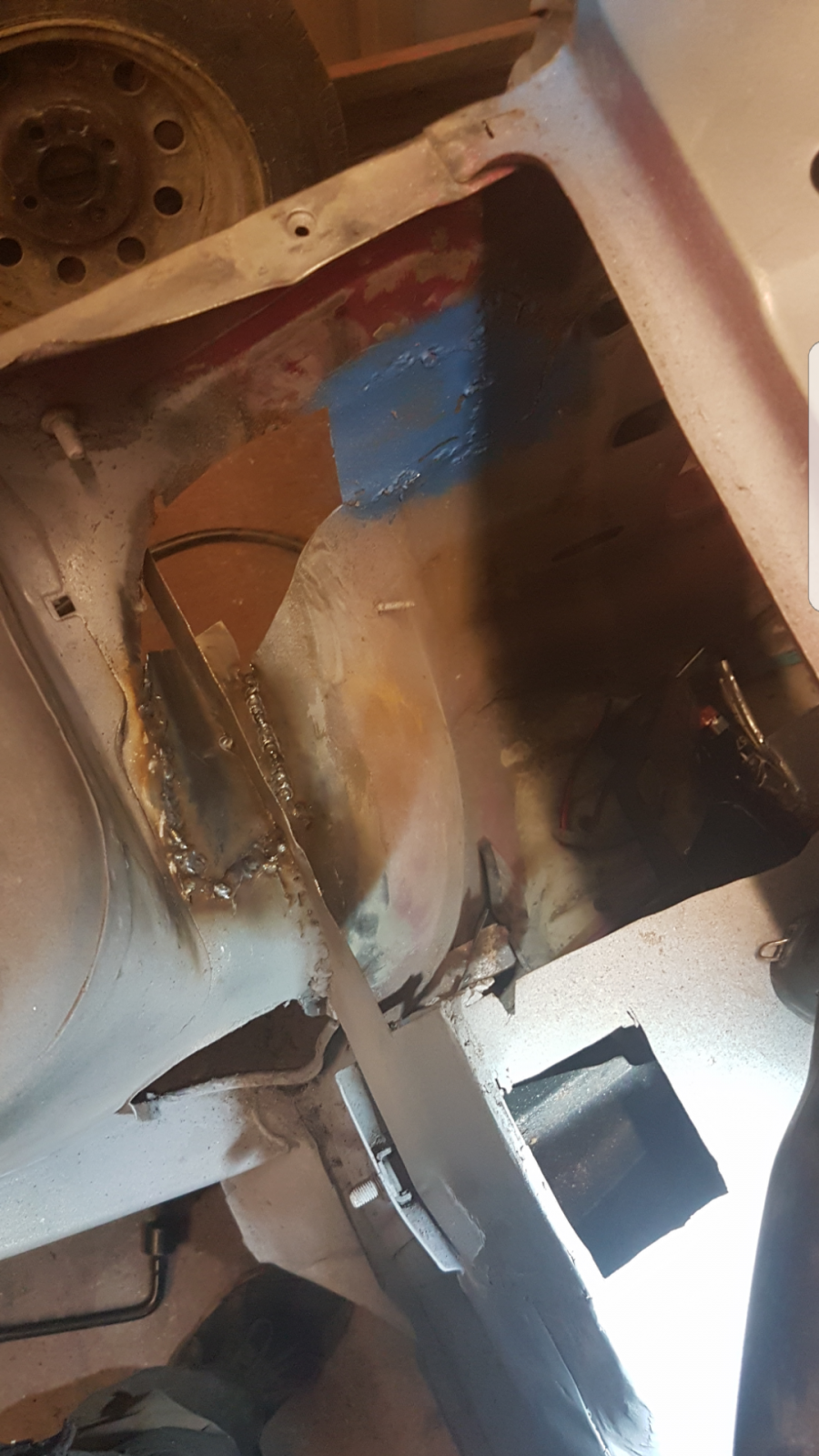

Other things i need to do is patch up where the battery use to live as it was completely rotten through
DSCF1293_zps56dqhauc.jpg.
Middle section all welded up now on to the battery tray and the wire hole

Fab'ed up and welded in the new battery tray  and brake servo mount from scratch.
red oxide'd yhe bay to stop the rust coming through. servo and pedal box fit nicely under the new section. most of the welds grinded down and welded most of the holes in the engine bay and started on tucking the wiring and cutting out all the wires i don't need for the engine.

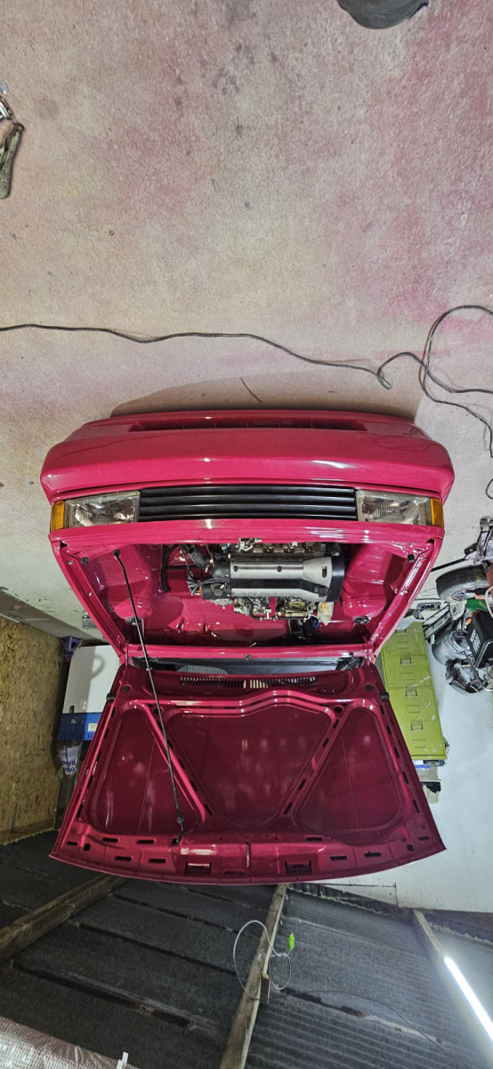

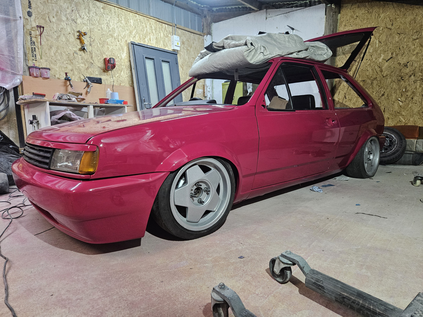

Bit of a jump in time this is how the car is sitting in 2025 hoping to see some shows this year
Engine bay is smoothed and AFH engine swaped on twin webersl 40's
