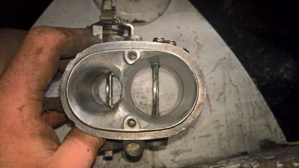

My brother has a mk2 Polo GT and I have started working on the spare throttle body. There are a lot of improvements to be made, firstly the infamous "dewedging" which opens up the throttle body but the throttle butterfly spindles can be slimmed down quite a bit to further open up flow. The mouth of the throttle body is quite angular in places and could be smoothed out and made into more of a trumpet shape for better, smoother airflow.

Photo is of the nearly finished GT throttle body. It has a nice smooth radiused entry into the throttle body for smoother, less turbulent air flow (standard has very square edge) throttle spindles have been slimmed down for less restriction to flow and the wedge removed.
