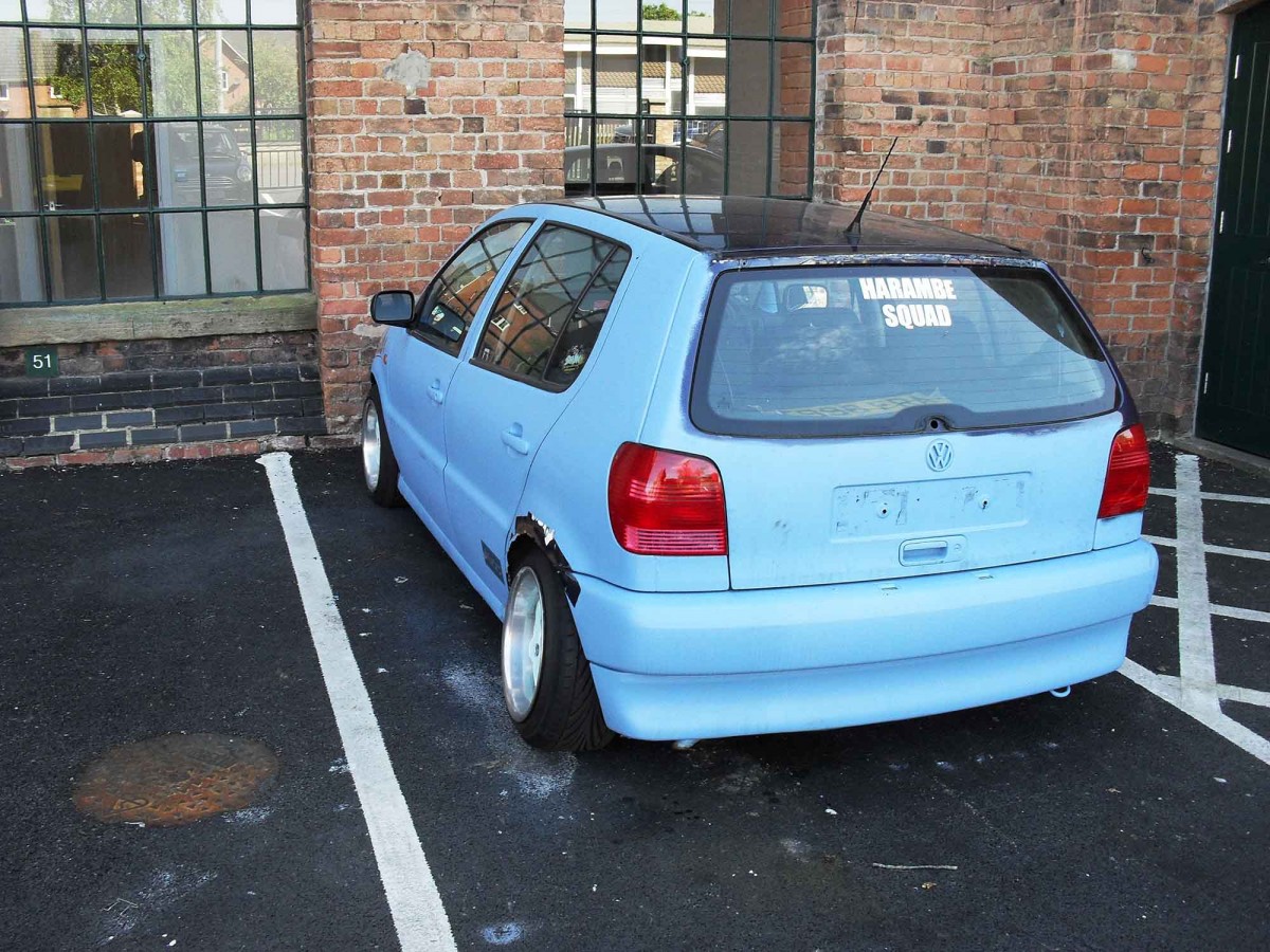

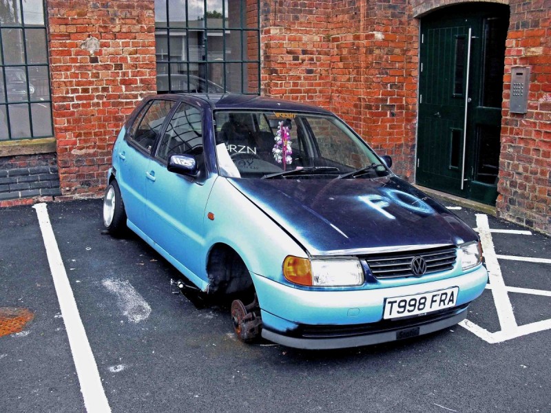

So after seeing this offender sat on her discs for the past three months I have finally tracked down her owner and made the purchase :D
1.4cl petrol - 1999 - 70,000 miles - camber
4 coilovers, nice rims, upgraded rear lights, couple of rusty arches, no MOT.

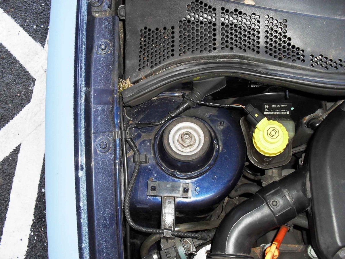

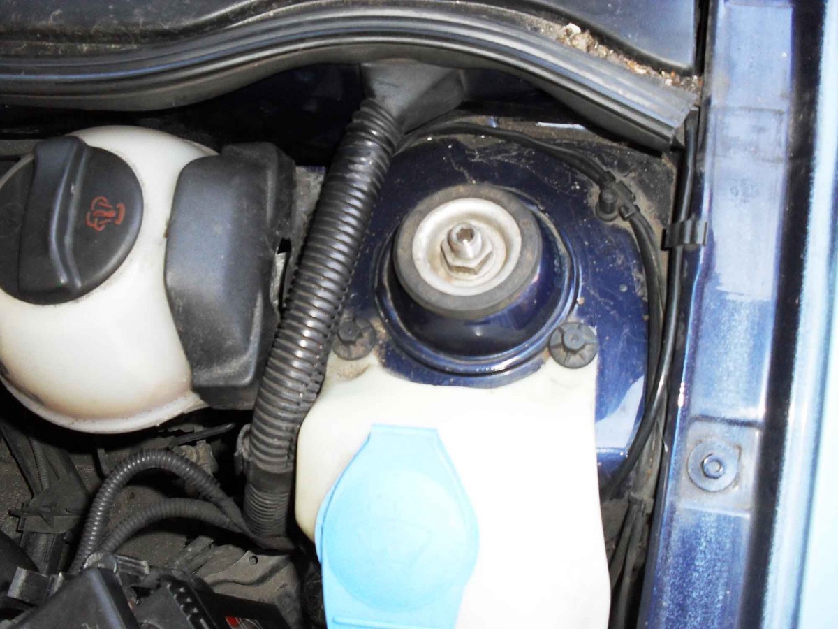

  • The strut mounts (metal washer type part that goes inside the engine bay) have been lent to her previous owner's friend and I can't find replacements anywhere online.

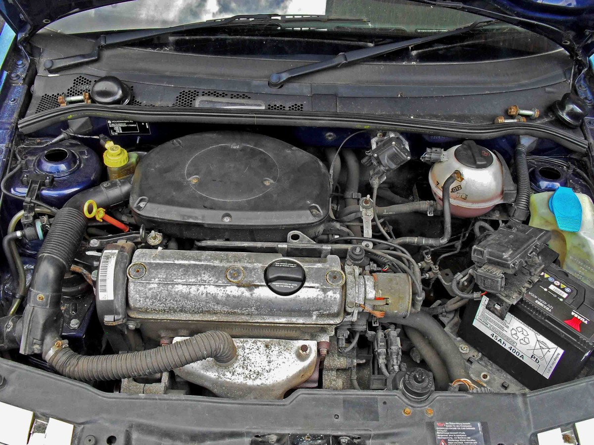

  • Engine had a misfire but I was blessed with an easy fix by changing a corroded spark plug - note that the lead needs changing too; just need to get to the scrap yard.

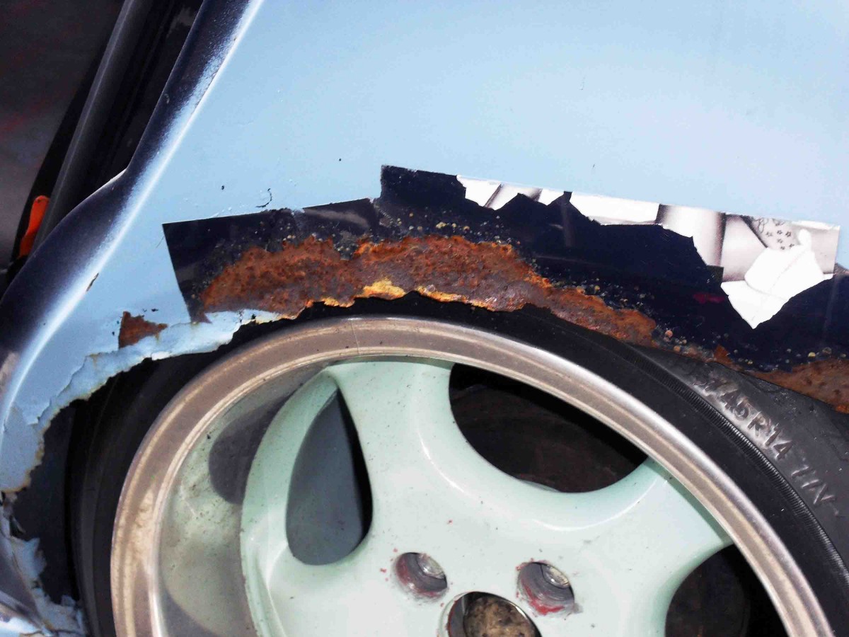

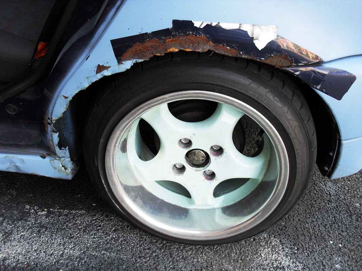

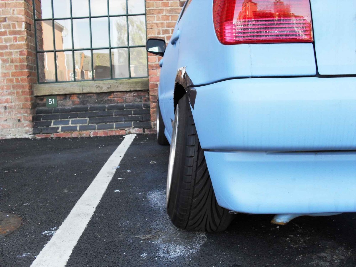

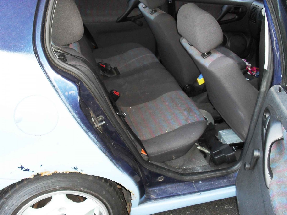

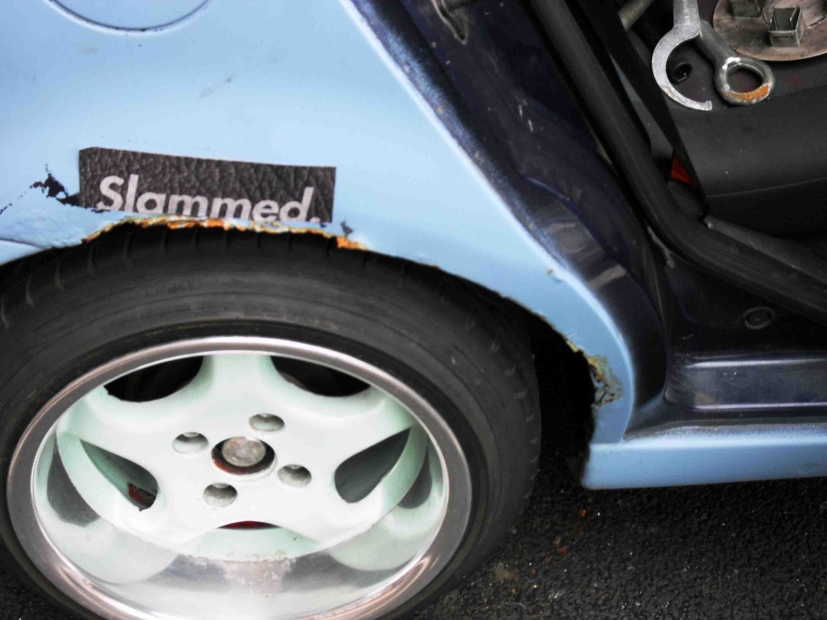

  • Likely to need at least one repair panel for the NS rear arch; although I'd prefer to get some 1mm steel welded to the original body and hammer/roll the arches out myself if possible.

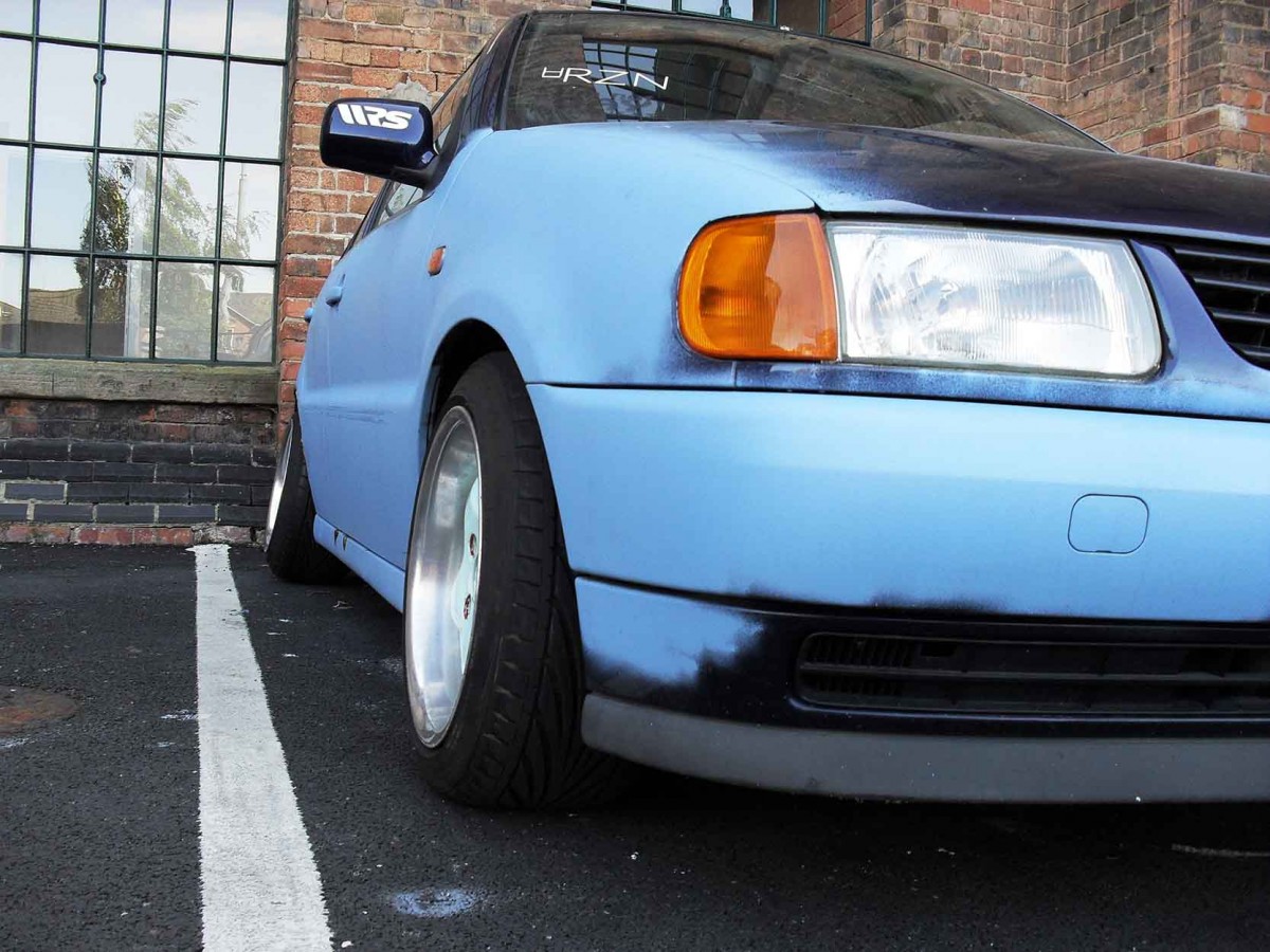

  • Bonnet has lacquer peel. Can probably pick up a clean bonnet for less than the price of restoring this one.

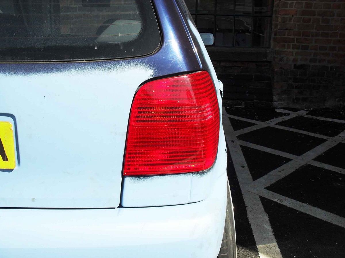

  • Paint looks good for rattle can job, not seen much overspray, needs matching and finishing off.
MOT booked for Friday morning (32hrs from now)

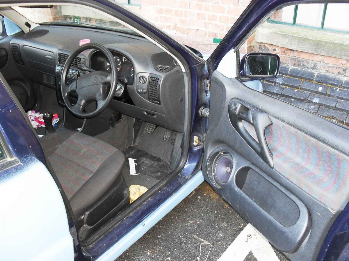

  • suspension and rims on
  • tape up the sharp rust
  • secure the battery
  • attach rear number plate
The lad who I bought it off loves polos but only has a provisional; planning to take him out in it on Friday and get him to write down the reams of info about the car which he has told me but I've failed to remember.

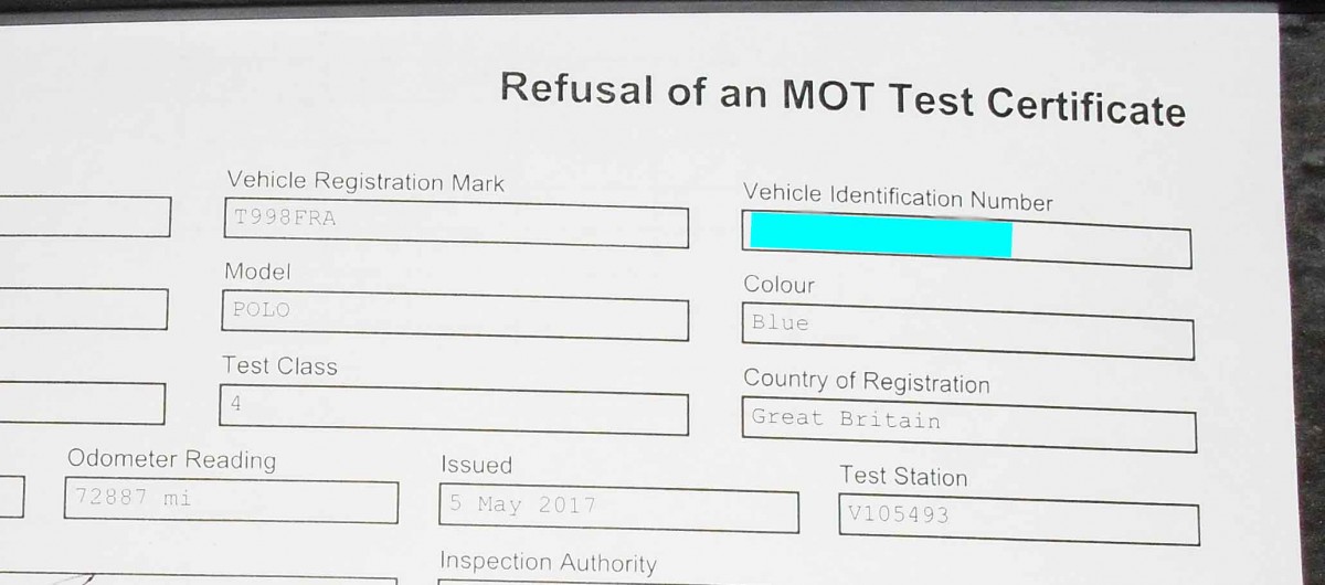

  • So, went down to the MOT center and came back with 2 advisories; and 13 failures    Not sure I agree with them all, but I'm not a tester.   Update on work carried out pre-MOT in nex
  • Yes but they're not a priority wheel bearings brake lines welding MOT arches Great motor for her age. The amount of pre 2001 polos golfs and passats you see on t
engine bay looks good to me, how to I get a cold high flow filter in here though :unknw:
Your brave - looks like it needs some serious love.
So, went down to the MOT center and came back with 2 advisories; and 13 failures :pardon:
Update on work carried out pre-MOT in next post.
Failures
  1. Windscreen has a sticker or other obstruction encroaching by more than 10mm within zone 'A' offside Front [8.3.1b]
  2. Stop lamp not working Nearside Rear [1.2.1b]
  3. Battery insecure [1.9.1]
  4. Windscreen wiper does not clear the windscreen effectively [8.2.2]
  5. Seat belt anchorage prescribed area is excessively corroded Offside Rear [5.2.6]
  6. Seat belt anchorage prescribed area is severely distorted Offside Front [5.2.6]
  7. Seat belt anchorage prescribed area is excessively corroded Nearside Front [5.2.6]
  8. Brake pipe excessively corroded Nearside Rear [3.6.B.2c]
  9. Brake pipe excessively corroded Offside Rear [3.6.B.2c]
  10. Brake pipe excessively corroded Offside (front to rear) [3.6.B.2c]
  11. Shock absorber insecure Nearside Rear [2.7.2b]
  12. Rear wheel bearing has excessive play Nearside Rear [2.6.2]
  13. Rear wheel bearing has excessive play Offside Rear [2.6.2]
Advisories
  1. Front number plate cracked
  2. Offside rear tyre has cuts in sidewall

Basically the camber has destroyed both rear bearings, so camber is coming off for now which means sitting her on steels until her arches are flared.
Not sure about how to go about getting the camber back later without ruining the new bearings. Most camber uses an adjustable control arm, but the 6n has a fixed axle.
