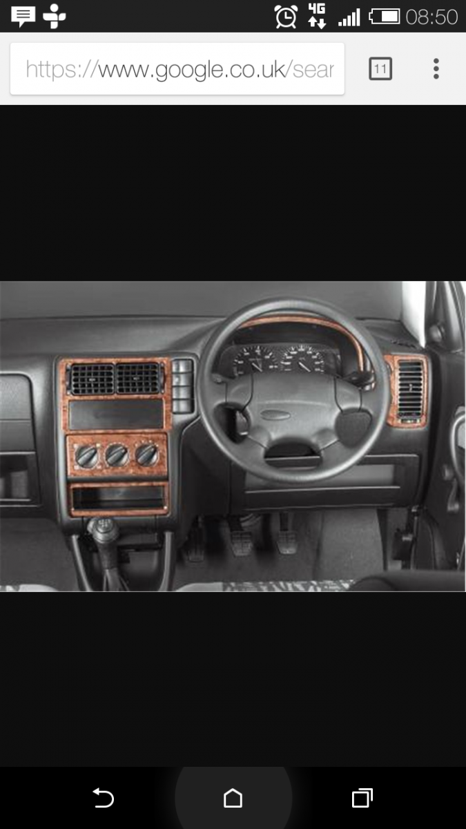

Any chance that anybody now about swap the dashboard on polo 6KV saloon/estate?
There is a two different type of dashboard fitted on this model.
I like to know is there any possible to change the old model to new with any issues.
I have all parts , mean complete new model dash and want fit to my vw caddy mk 2 (last model) which based on polo 6KV.

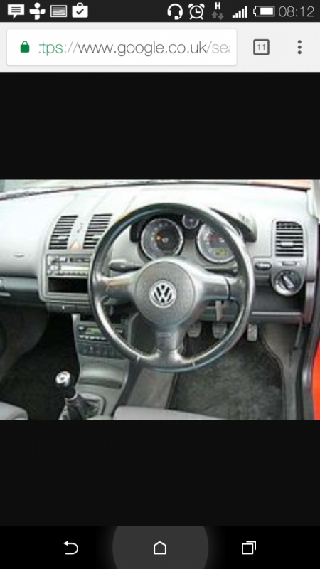

Others have swapped the dash in a 6N1 for the 6N2 one, here's one example
and I think @r10tz0r converted his dash from the early to later version
I did the 6n to 6n2 dash conversion, it all fits physically only problem is having to rewire the connectors on the plugs and source the correct clocks that will work. the amount of work required varies depending on which style of loom you have
