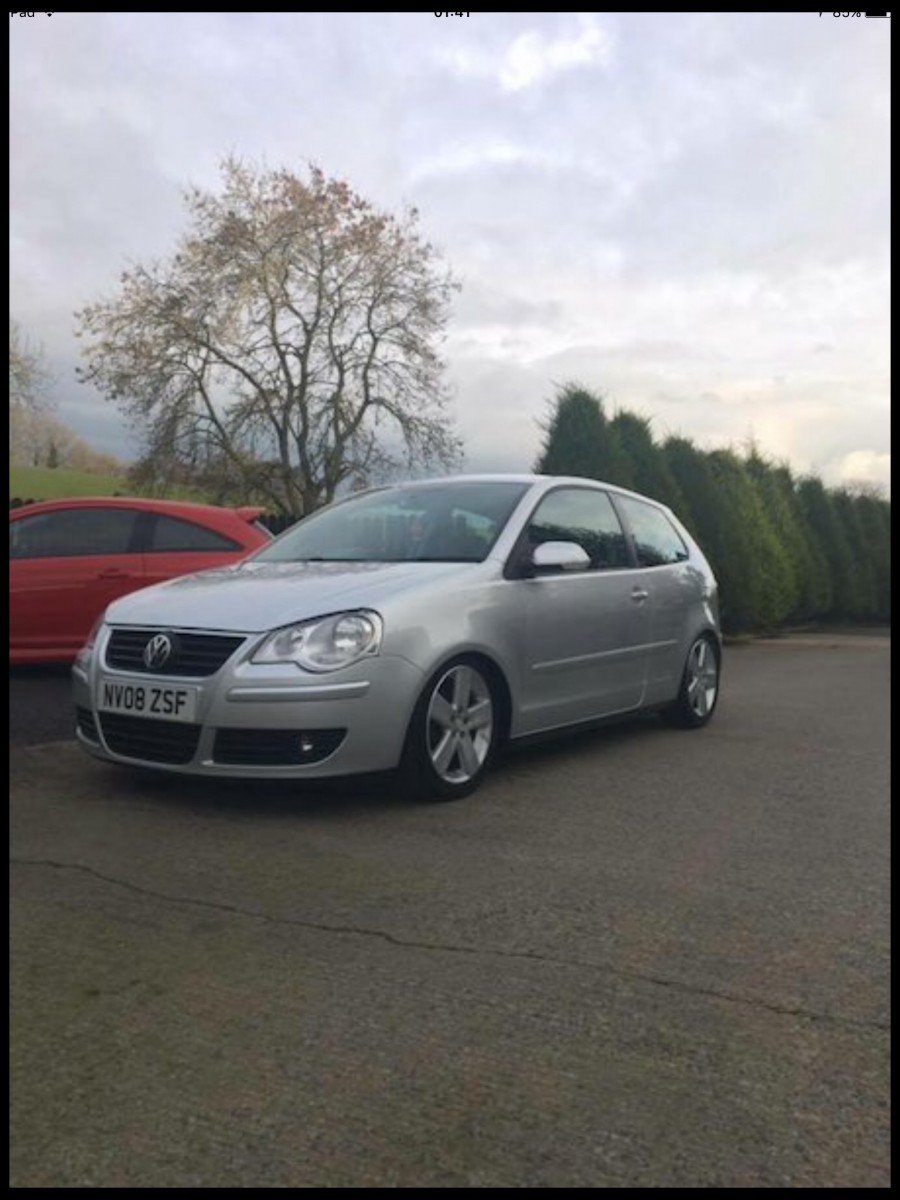

Hi,
im new on the forum after recently picking up a 2008 1.9tdi polo sport pd100.
im very happy with my car, it was a private sale and when I test drove it the abs light came on. The owner was shocked and I managed to talk him into writing me a warranty on abs just incase it wasn't the sensor.
ive had the sensor replaced as the scan came up showing front passenger side fault code. The wheel bearing was also replaced at the time. The light went off for all of 6 hours.
Usually the light comes on right away upon starting the car. However, if it comes on while I'm driving the speedo will dance around, then the abs will kick in, followed by the light coming on and then all returns to normal driving just with the abs fault line on.
my mechanic isn't sure but he's leaning towards abs pump, even though it's warranted I don't want to replace it for no reason I'd rather get to the root of the problem.
Has anyone had any experience like this? I was thinking maybe it's whatever method the sensor is using to read the speed is danges somehow although it's a new sensor?
Thanks for your help.IMG_2039.thumb.JPG.3fd73b9d5ab005d0078ae8ec2d13f752.JPG
