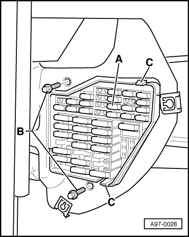

    First Welcome to the forum.   As yours is a 2002 9N1 or MK6 (on this forum) the central locking isn't done by a vacuum pump, it's all electric, the chances are it doesn't have central lockin
As yours is a 2002 9N1 or MK6 (on this forum) the central locking isn't done by a vacuum pump, it's all electric, the chances are it doesn't have central locking, if it does the fuse is #50 15Amp
This is for a LHD so yours will be a mirror image of this
Fuse #50 is the fith one up on the column nearest to the "B" in the picture.
