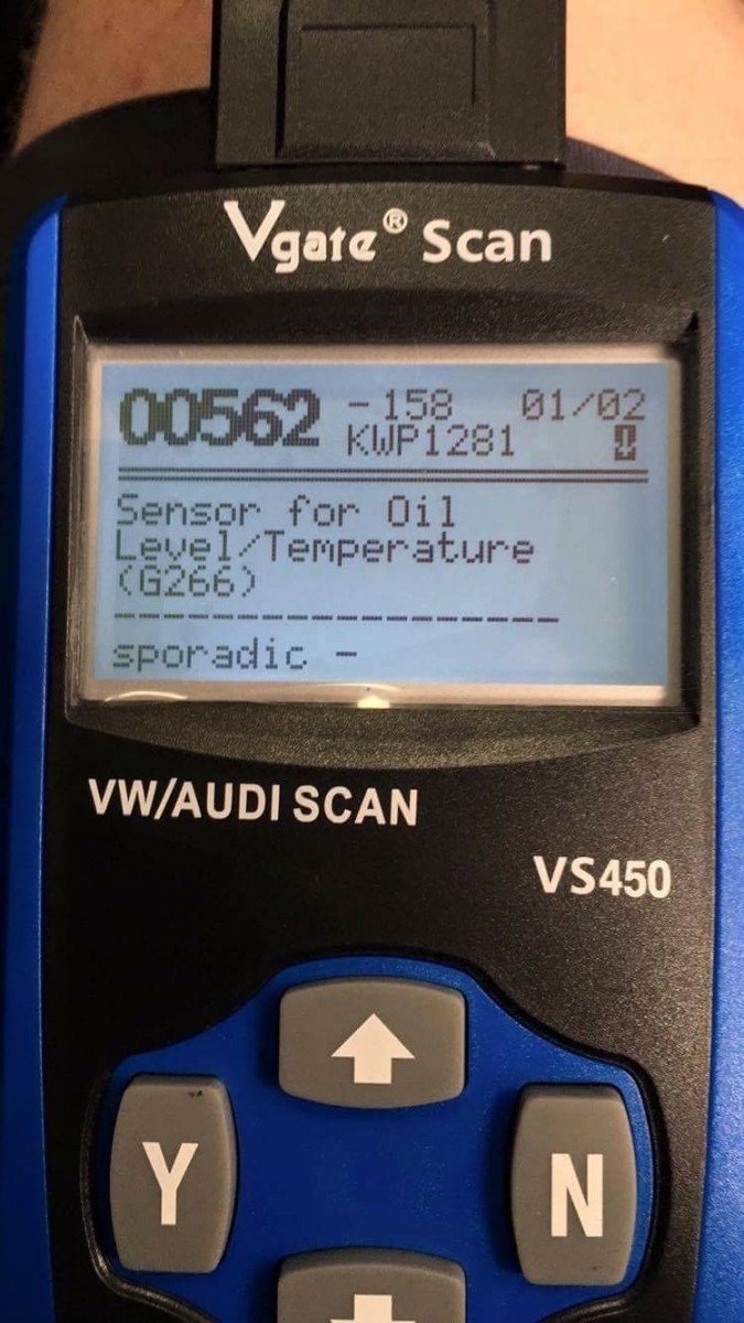

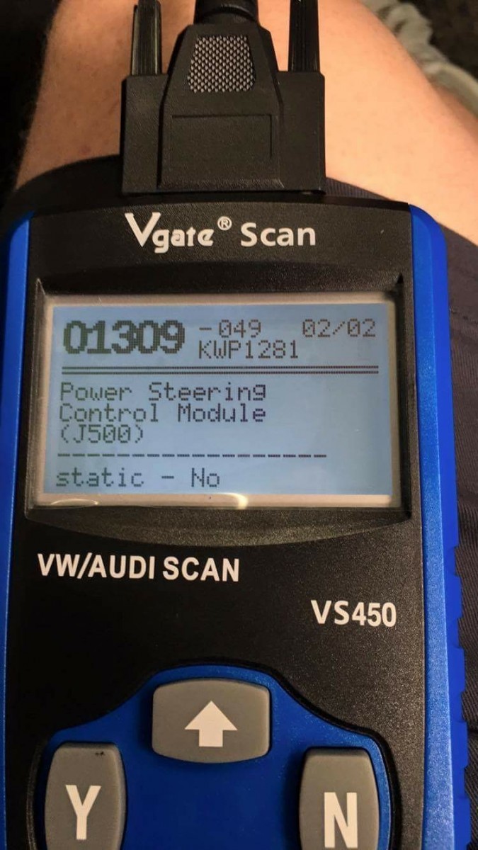

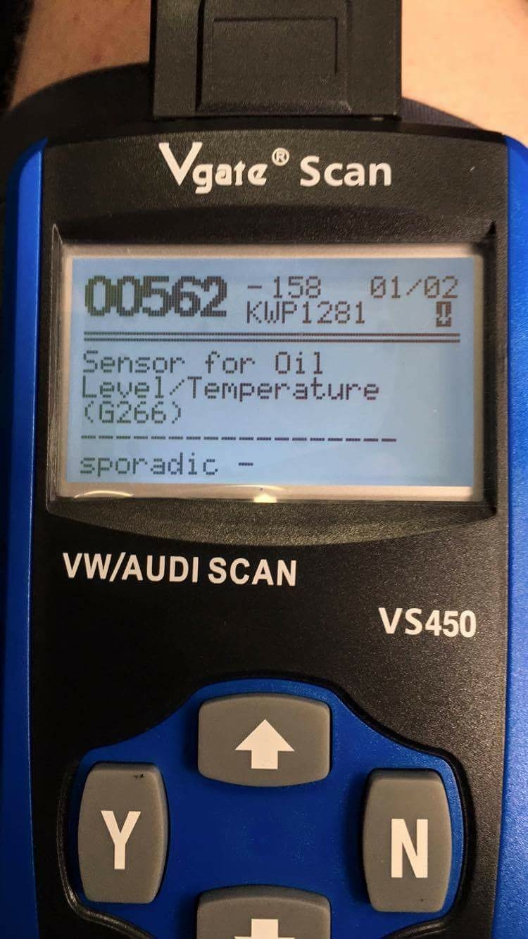

The new pump unit didn't work. Anyone got any ideas? I've got the following codes..
Cheers
