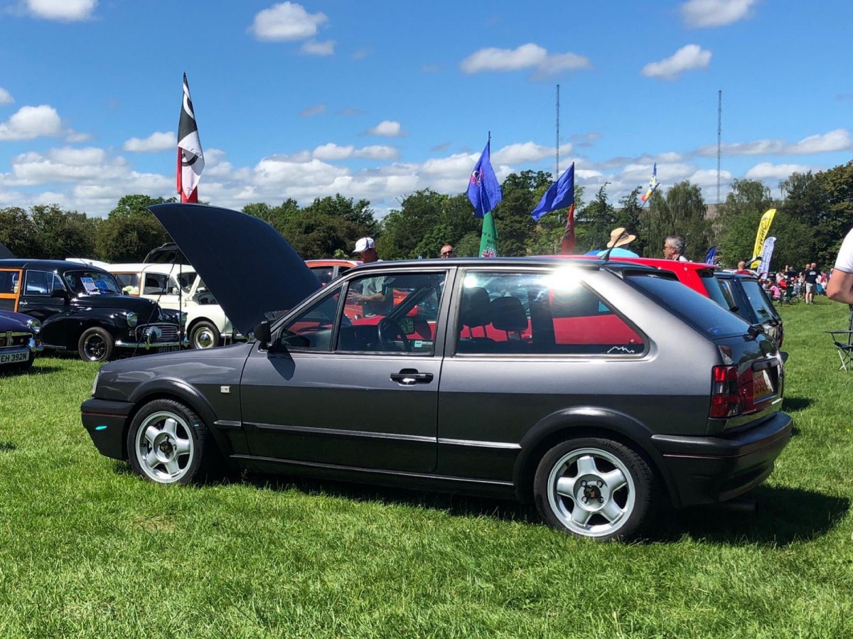

  • Well, I think I've reached the point where it's done. Easy to drive, fast, fairly comfortable. It works well, and I'm tempted to leave it as it is. This position has taken me 15 years and four month

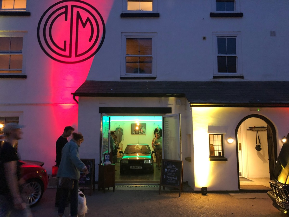

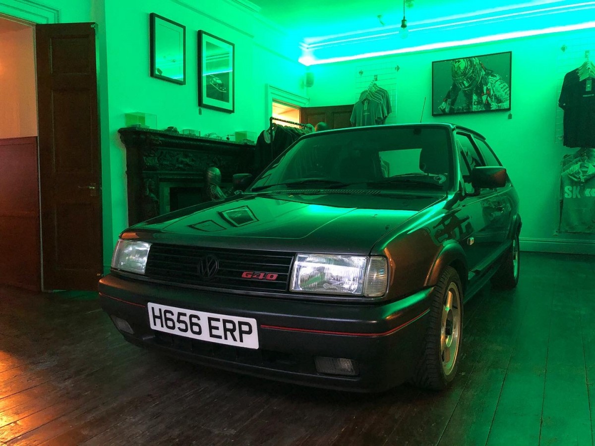

  • Took it to C&M last night for the StrassenKultur evening and… well this was awesome.
