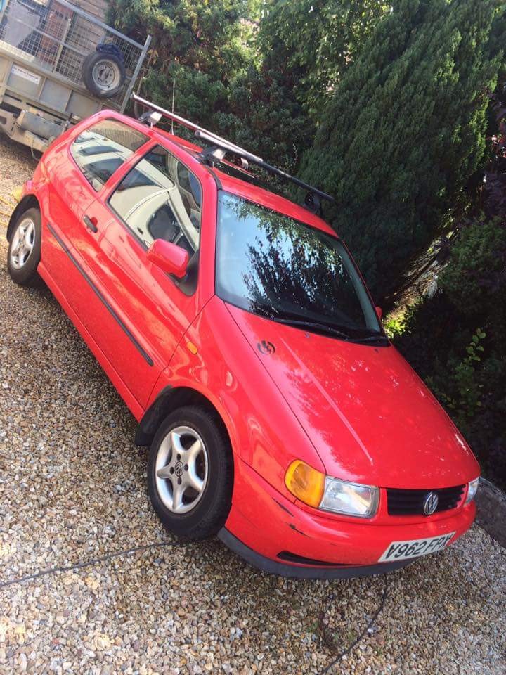

So bought this about 2 weeks ago now.
Polo 6n 1.4 8v in red, had 2 owners since new and has full service history, 85000 miles and not to bad condition.

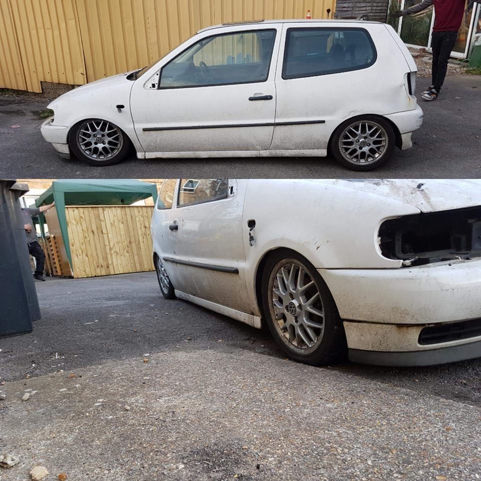

now i had bought a 6n a little while ago to break for parts
bought for £200 and manged to get off it
- 6n2 gti wheels with 4 good tyres
- coilovers
-Tinted rear lights
-clear side lights
- smoked side indicators
- and a few other random bits for another project of mine
so all in all money well spent, ended up making £100 on the car and still manged to keep all the parts above :D

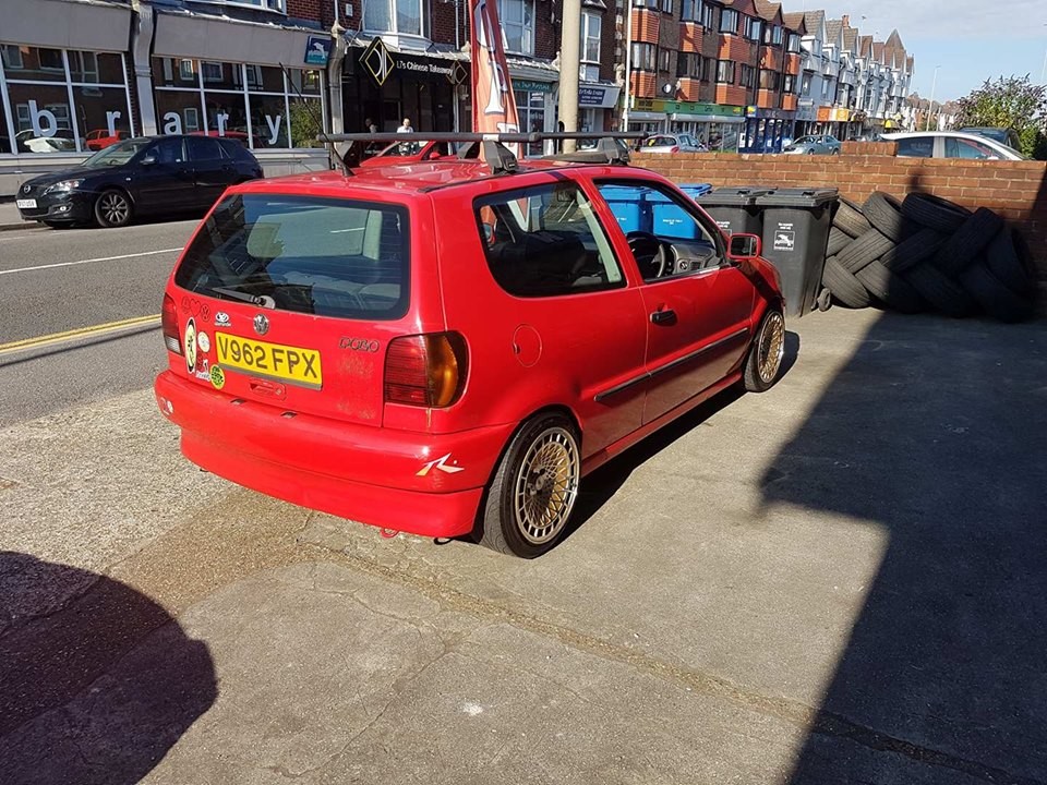

So anyway back to the car, so bought the car like this at 12 on Saturday
Got to have a quick look back

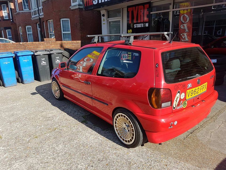

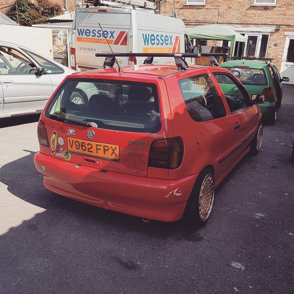

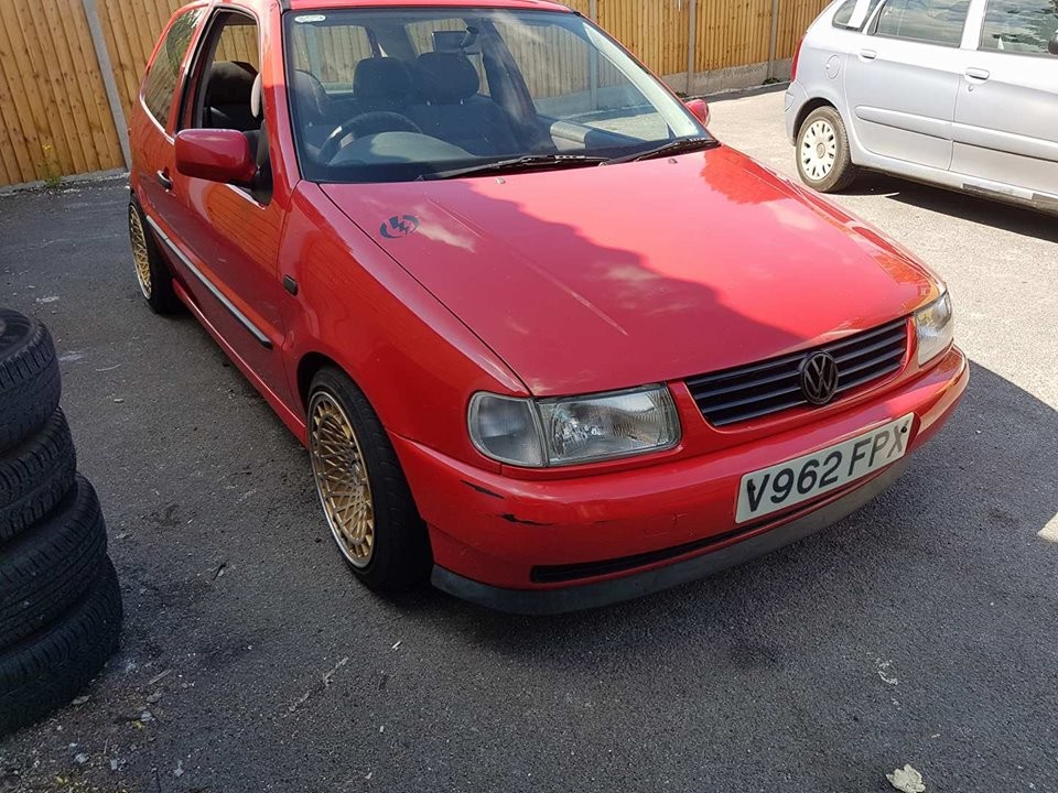

then 5 hours later after fitting everything i had it looked like this
19970890_10155617013640798_2007518307_n.jpg.7e462da962e2a699d6551dc346750b34.jpg20196924_10155644406159201_38708533_n.jpg.3a58db1a5de29737a37de1c81c197c13.jpg20196982_10155644444914201_1326846835_n.jpg.9991ee4183ac69aa00620c108b556247.jpg20227367_10155644445299201_2005415649_n.jpg.55d73ac8393837fd03267f2870988b59.jpg20271807_10155644445359201_42346261_n.jpg.652e6093c6a83c1dab1c62f4c26f503e.jpg20272094_10155644445104201_1015403931_n.jpg.04015231af466f929f82e0bcf90c535e.jpg
Happy with everything so far but needed more, a lot more!
Had a few problems with the rear rubbing like a bitch so had to go back to the drawing board.

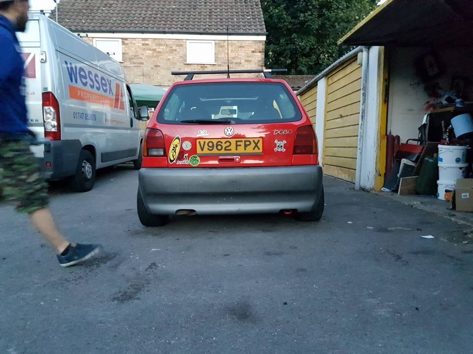

Ended up finding so 16v bumpers, front, rear and spoiler all for £50 but needed some serious TLC as the paint was F$$cked.
Managed to get the back and fitted the rear one which ended up going on like a dream no issues what so ever. While i had the rear up i thought ill add a little camber not to much (will add better pics soon) 8>)
Painted it up just roughly because car is getting completely re sprayed soon just didn't want to drive round with a grey bumper. (Again more pics to be added shortly)

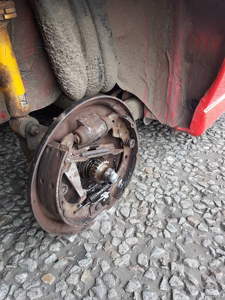

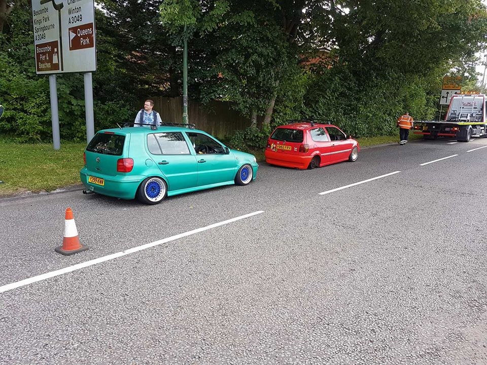

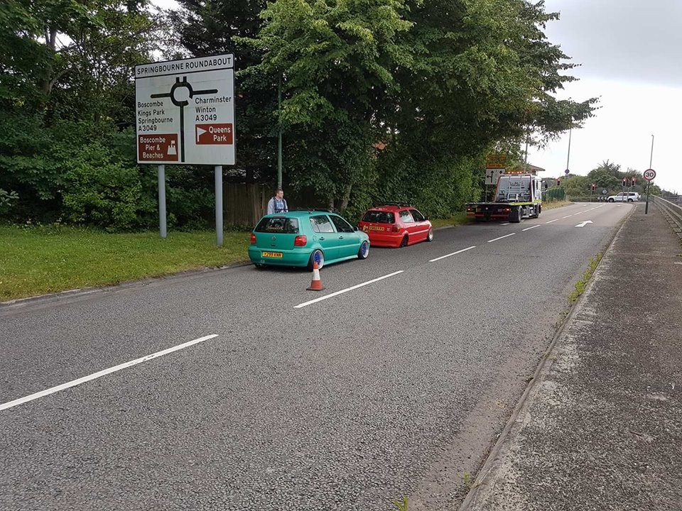

    After leaving the garage after fitting the 16v rear bumper and doing the rear camber this happened      So as you can see the wheel decided to come off while i was driving home
After leaving the garage after fitting the 16v rear bumper and doing the rear camber this happened :sleepy::sleepy:
20272125_10155644389309201_231892387_n.jpg.ef9c8df5e253a893e2d4504c2bf85fd9.jpg20206144_10155644389464201_1395264072_n.jpg.60b5eccb23aeb0730b19e5094bf484cc.jpg
20271941_10155644389459201_141204559_n.jpg.3f7ab7a76340d65b5fbad6ec30e3f686.jpg20271972_10155644389329201_1075902816_n.jpg.0866b550cb3b04f2622adf9f63bbc49f.jpg20206438_10155644406084201_842204484_n.jpg.7a41b4d482dc36c30842cfa819b7ff49.jpg20272161_10155644406064201_1992224549_n.jpg.d1b3f12108070823a4d85a9dbb2e0875.jpg20187578_10155644406124201_966740803_n.jpg.1baffa74c8e5c4344cc183cc0dadce08.jpg

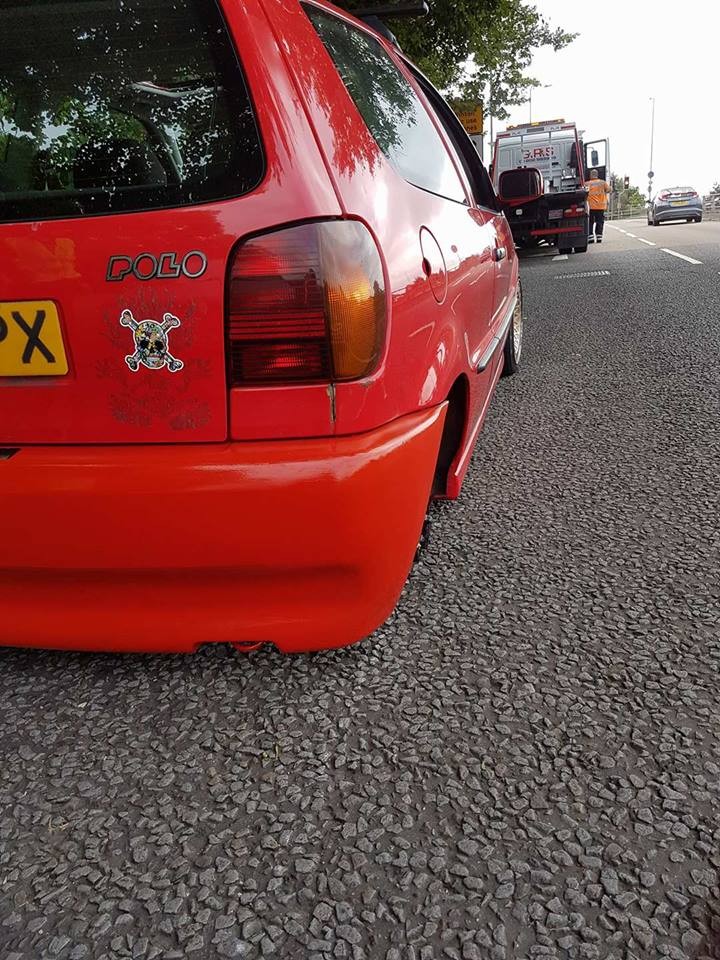

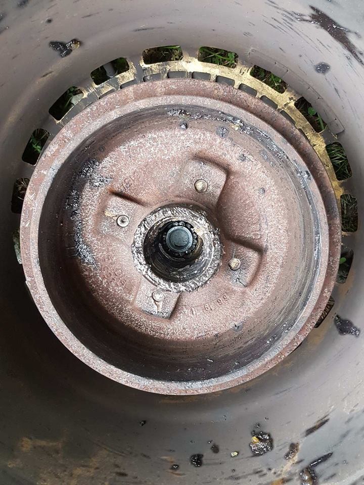

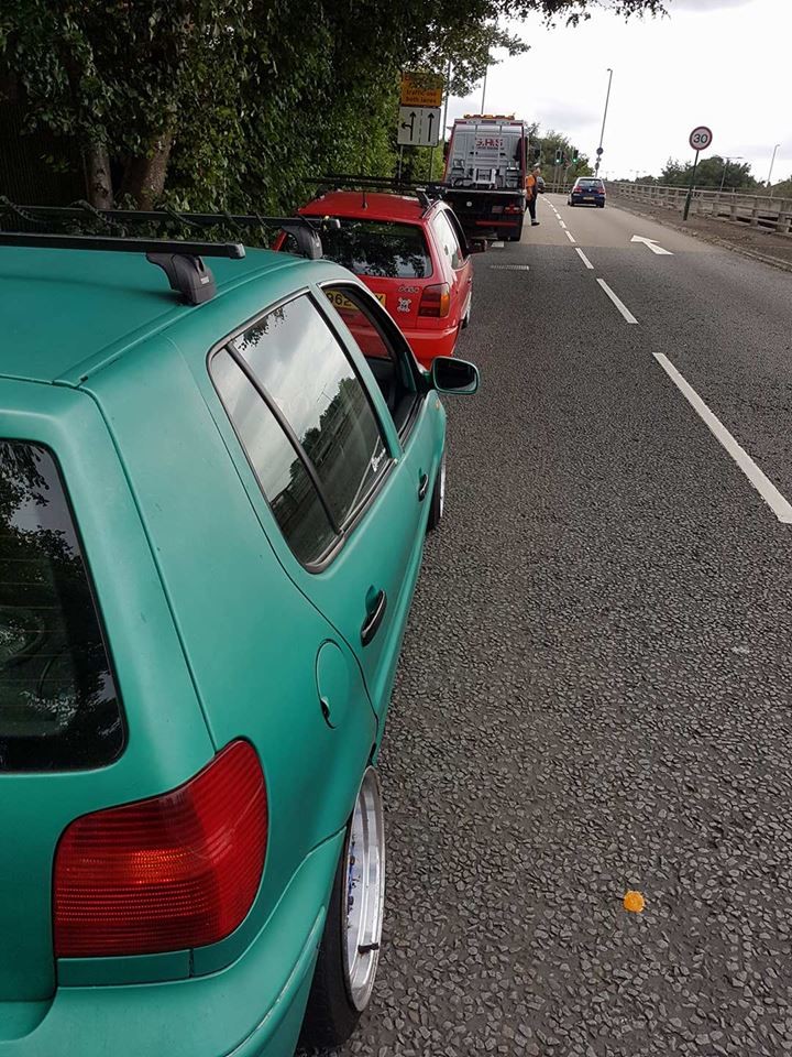

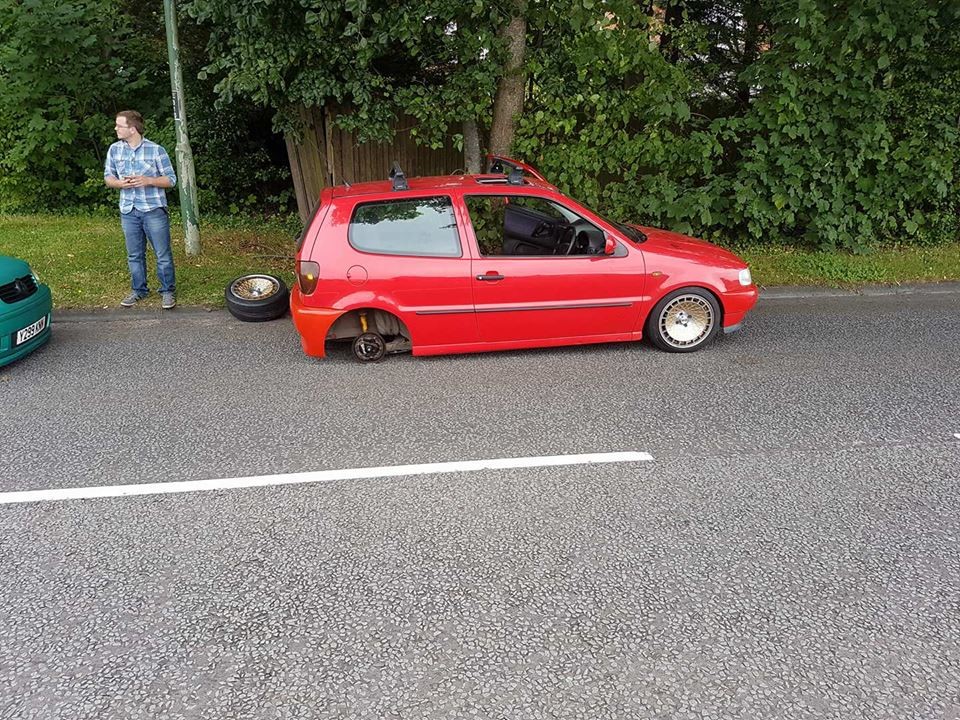

So as you can see the wheel decided to come off while i was driving home luckily i had slowed down just before it came off because i thought i had broken a drive shaft or something else cause i heard a massive bang.
As i started to pull over my wheel decided to F$$k right off down the road, hit another car on the round about lucky no damage just abroken wheel trim.

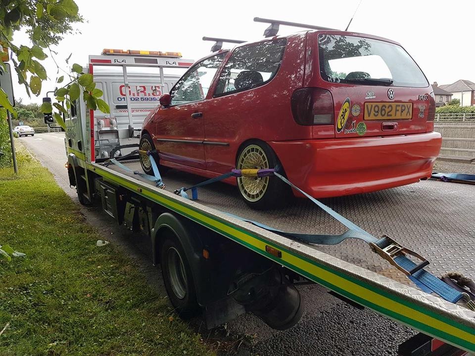

Managed to get the AA to come recover me within 45 minutes which was good.
Ended up finding out what i had done wrong for all of this to happen and no it wasnt because i didnt do the wheel bolts up.
It was because i didnt know the the nut on the end of the hub is suppost to be finger tight and i done it right up as tight as i could, which ended up seizing the bearing and causing the stub axle to melt and snap.
learnt my lesson the hard way!
Got 2 second hand hubs for free from a mate the next day fitted them up and now we are all good and back on the road.
