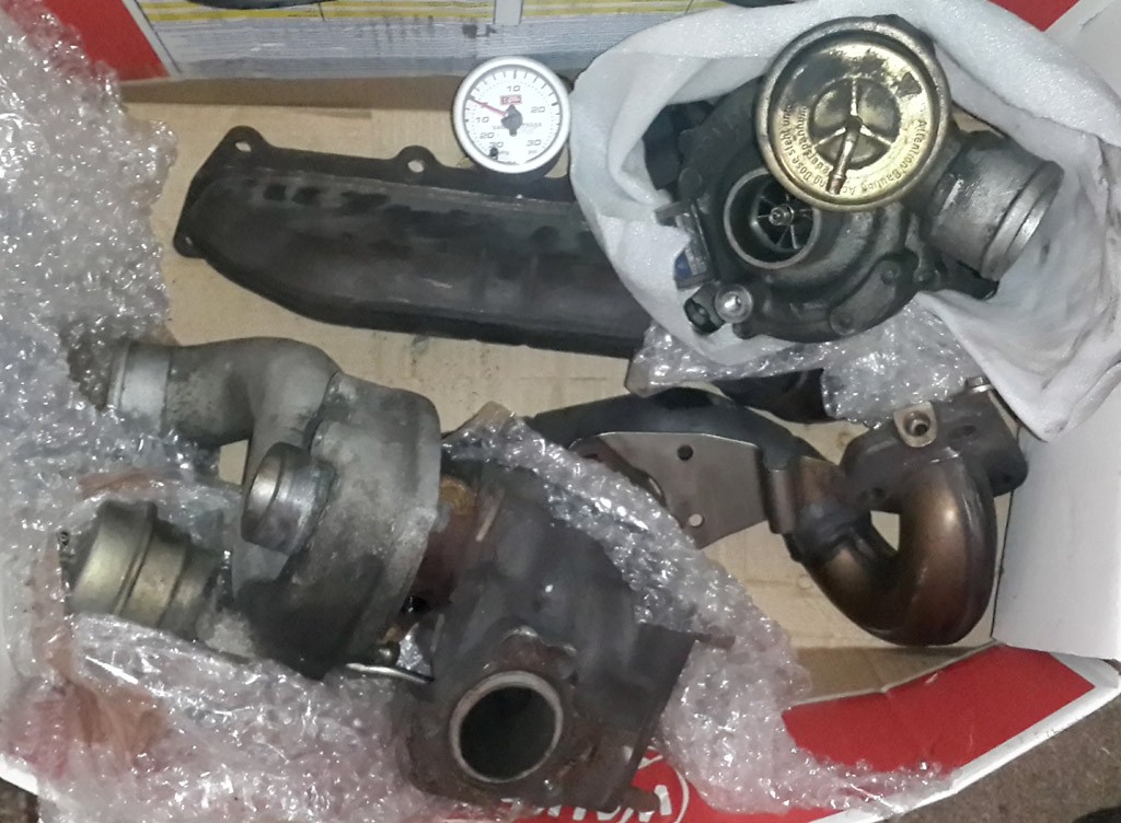

at long last we haz turbos and misc turbo ingredients \o/
Still awaiting exhaust flanges for the turbos and a few other bits, but can't do much with them for the next week or so anyway due to work, but it's a step in the right direction.
