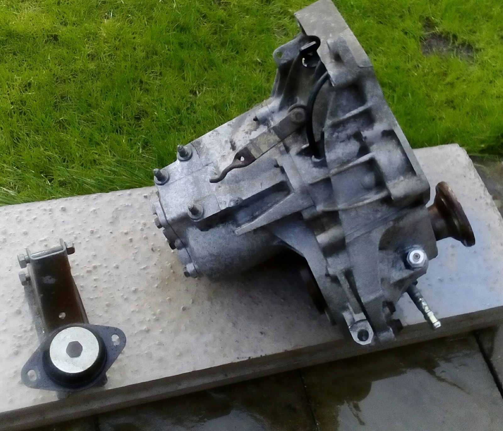

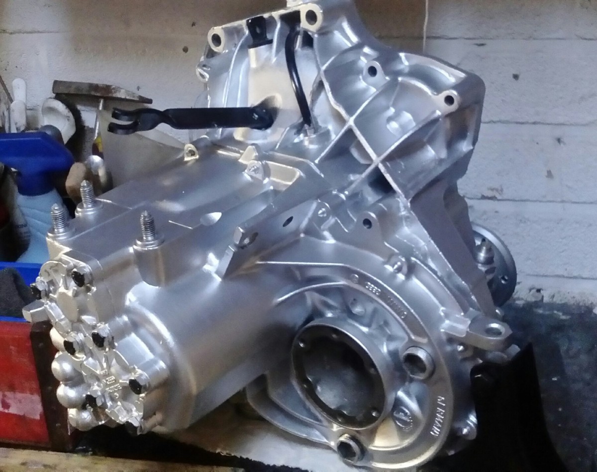

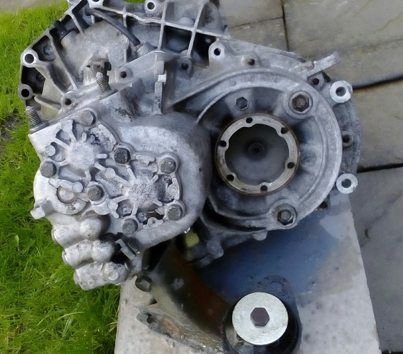

Gear box gets a good clean before painting. I got a 8p 5 speed that I was going to use but been advised not to on here.

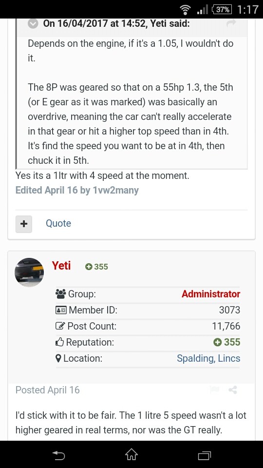

not sure why you wouldnt fit a 5 speed mate...
Sounds like bad advice, did they want to buy the 5 speed too......
Well I had the 5 speed sitting in lock up for a while and I asked on hear should I replace the 4 speed for my 5 speed 8p gear box.  You all said don't bother??
best thing i ever did to mine ...much more relaxed and confortable to use on longer runs
This is why I didn't fit it.
Edited by 1vw2many
up to you mate
i like mine - relaxed cruising and with the 1300 /1400 enough oomph to pass on the motorways etc in 5th
could always leave it in 4th if you dont like it lol

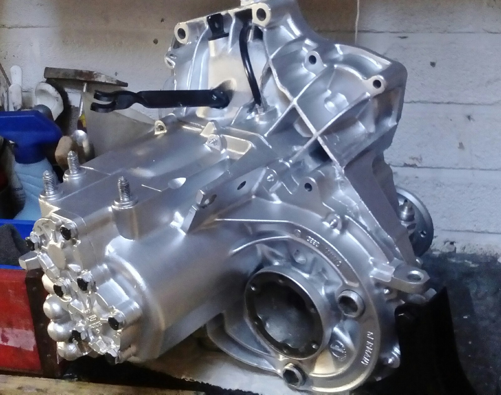

Well it's bolted up and back in car now.  Never mind I can still use it in my 1.3 cl when I need to fit a new clutch etc.
4 speed cleaned and bolted back to engine. Looks alot better.

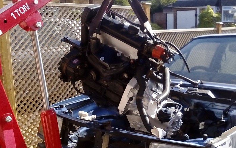

At last low mileage replacement engine going back in ..
Edited by 1vw2many

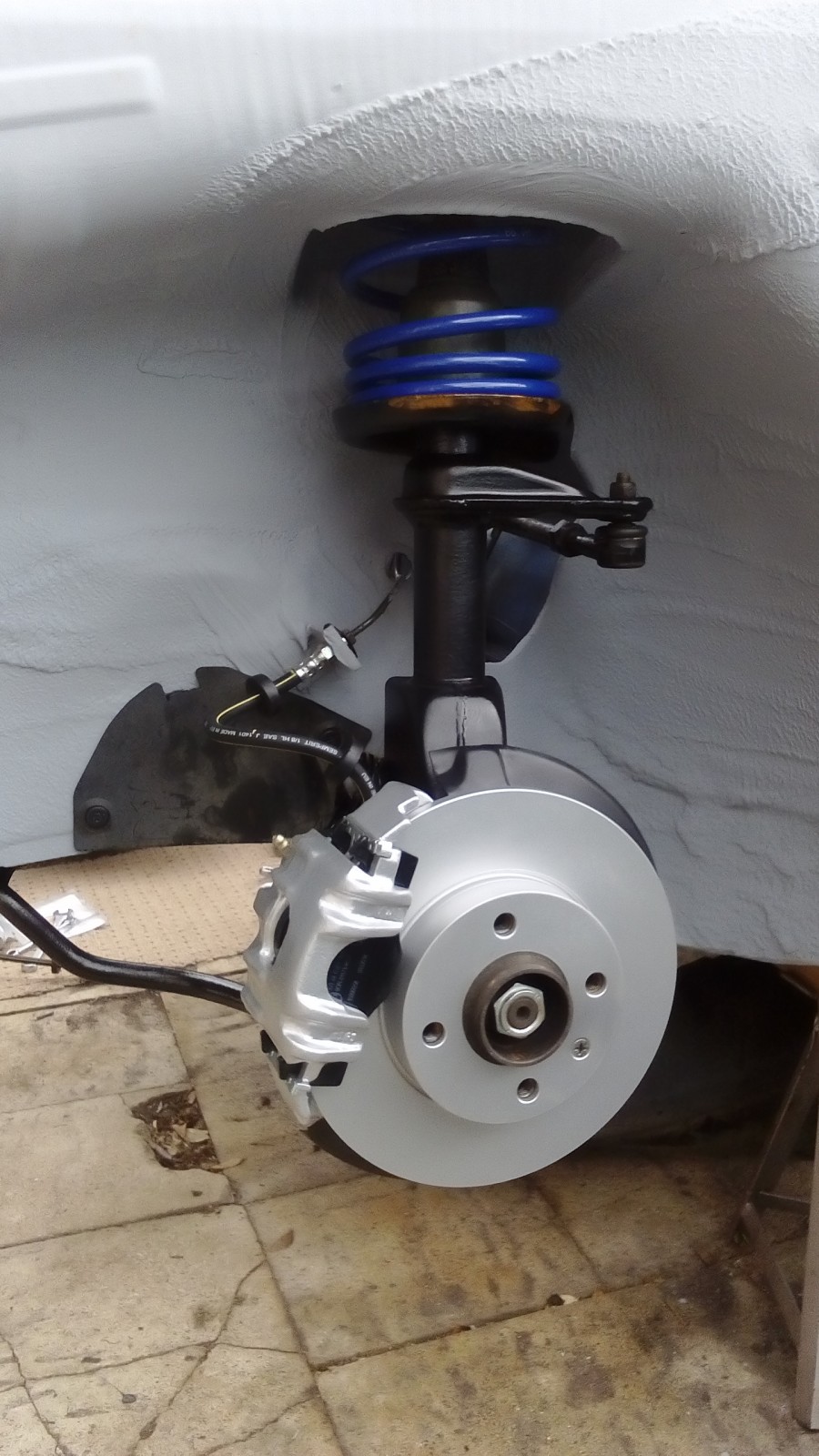

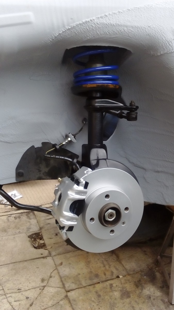

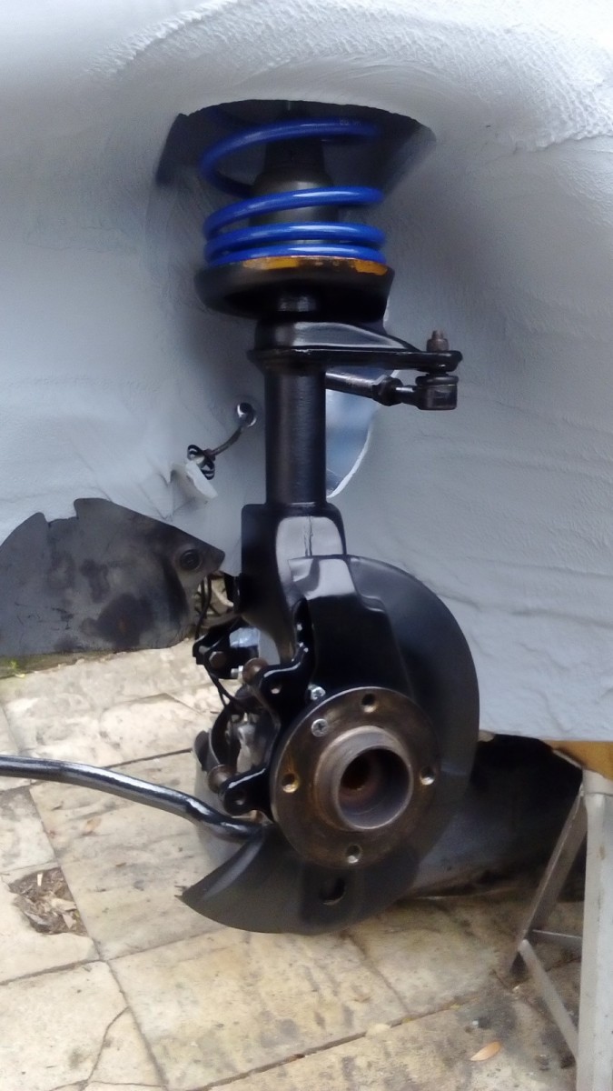

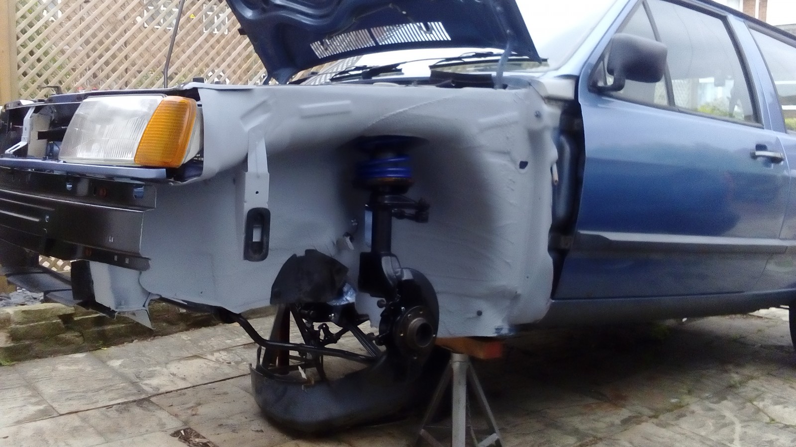

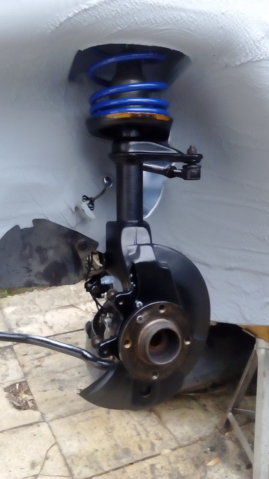

Freshly painted struts and arb steering arms etc with new  upper and lower bearings and back plate,  AP lower springs and shocks. New hard brake lines installed.
Edited by 1vw2many

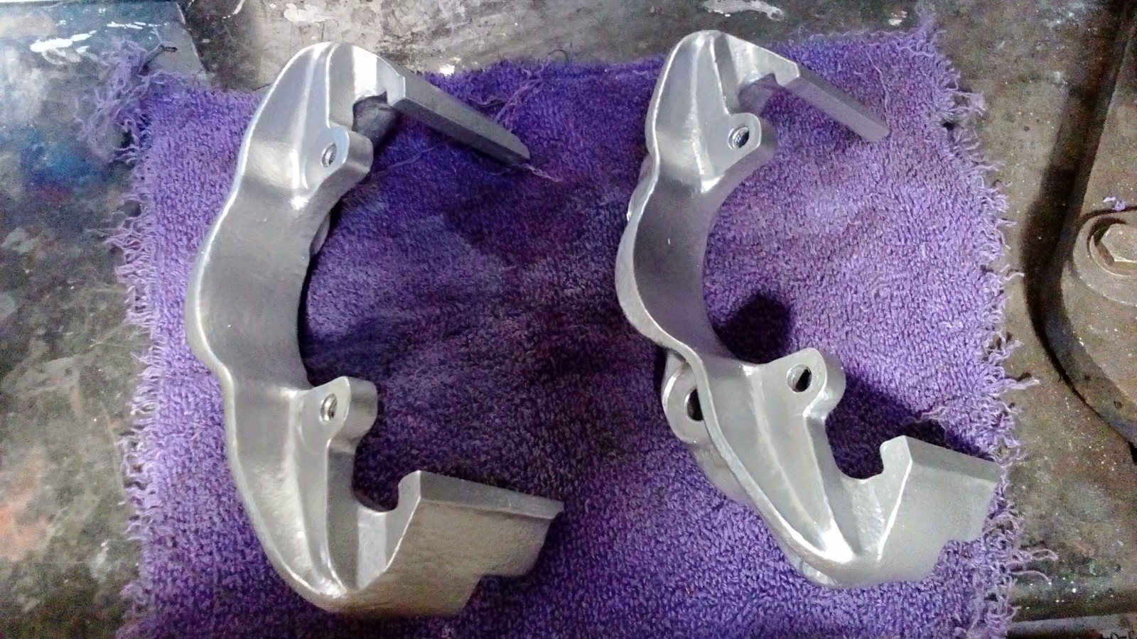

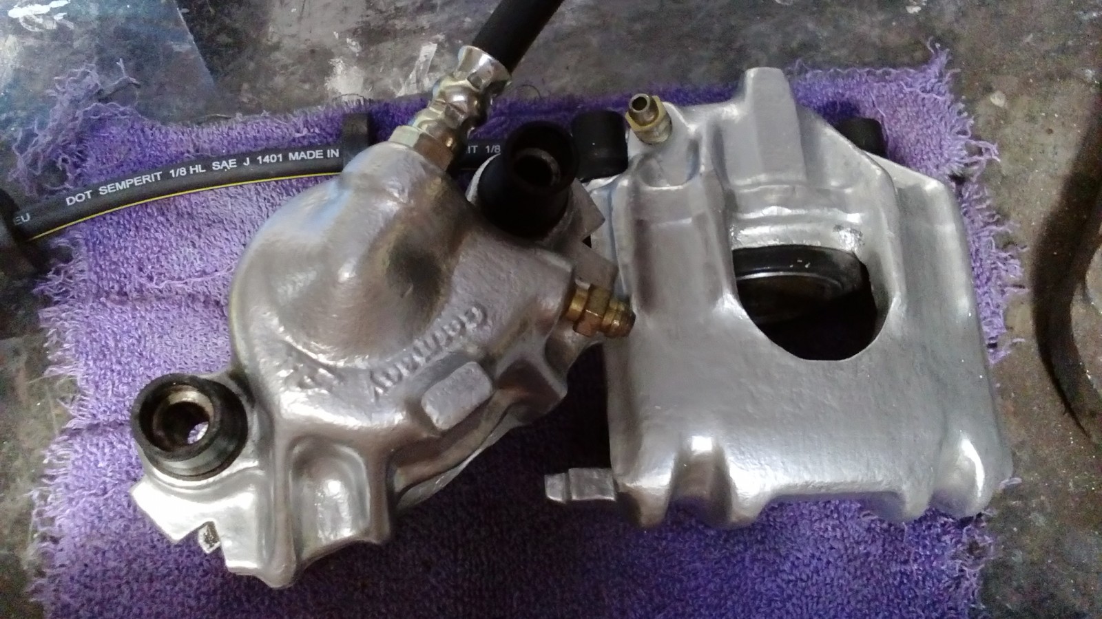

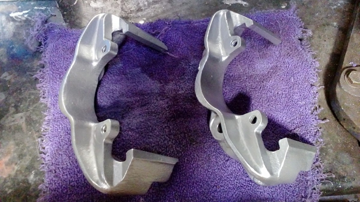

Brake callipers got a strip down clean paint and new piston seal kit and nipples and brake pipe.

Front end looking much better :D

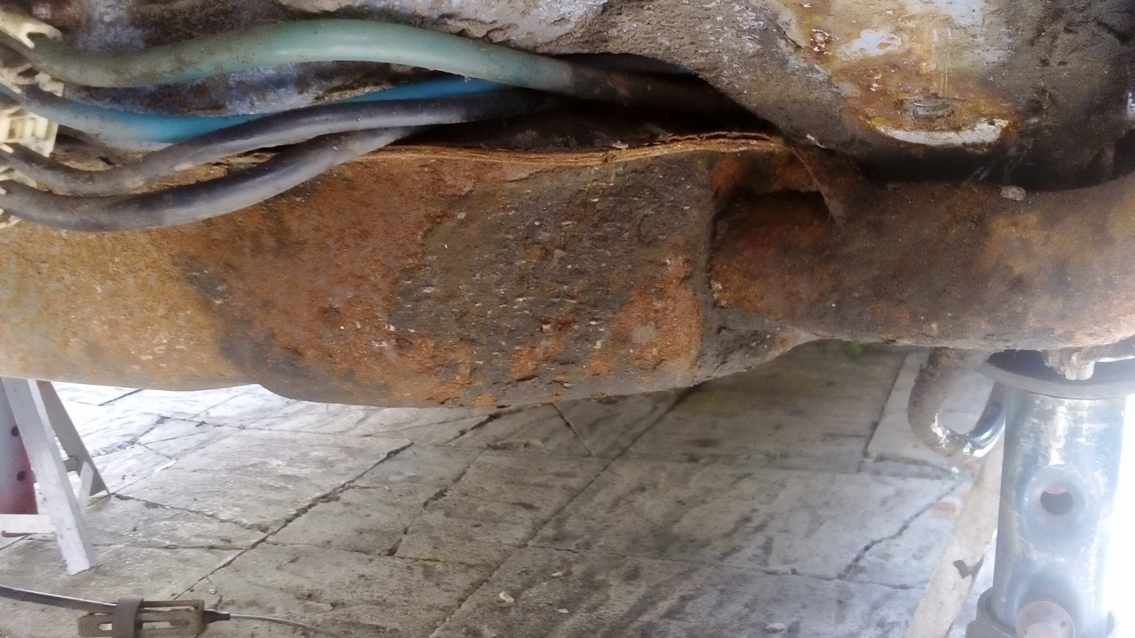

Time for back end now check out this photo. That's well crusty..

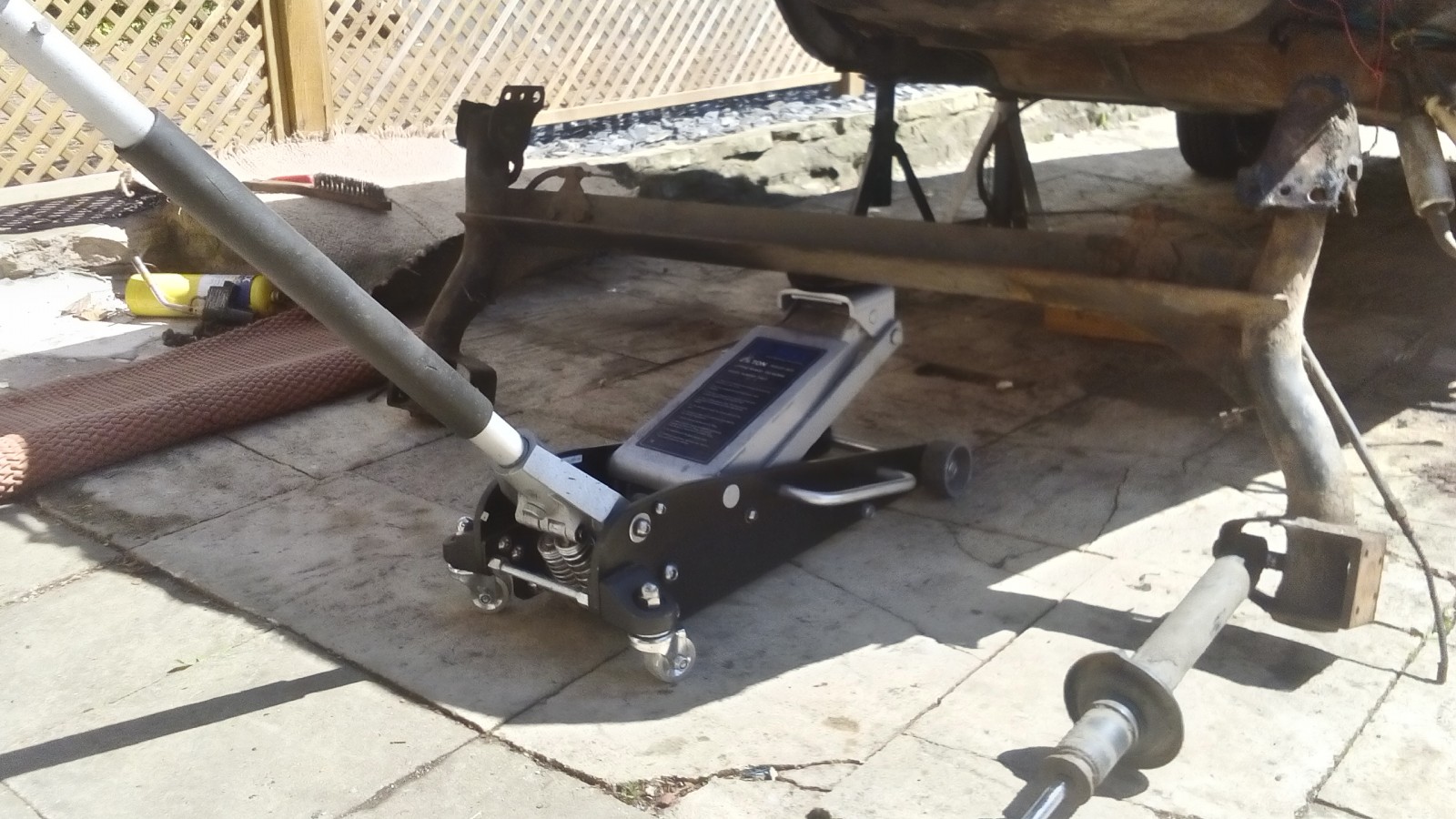

rear beam,  brakes, shocks, springs all removed ready for stripping back to metal. With new replacement parts.
Edited by 1vw2many

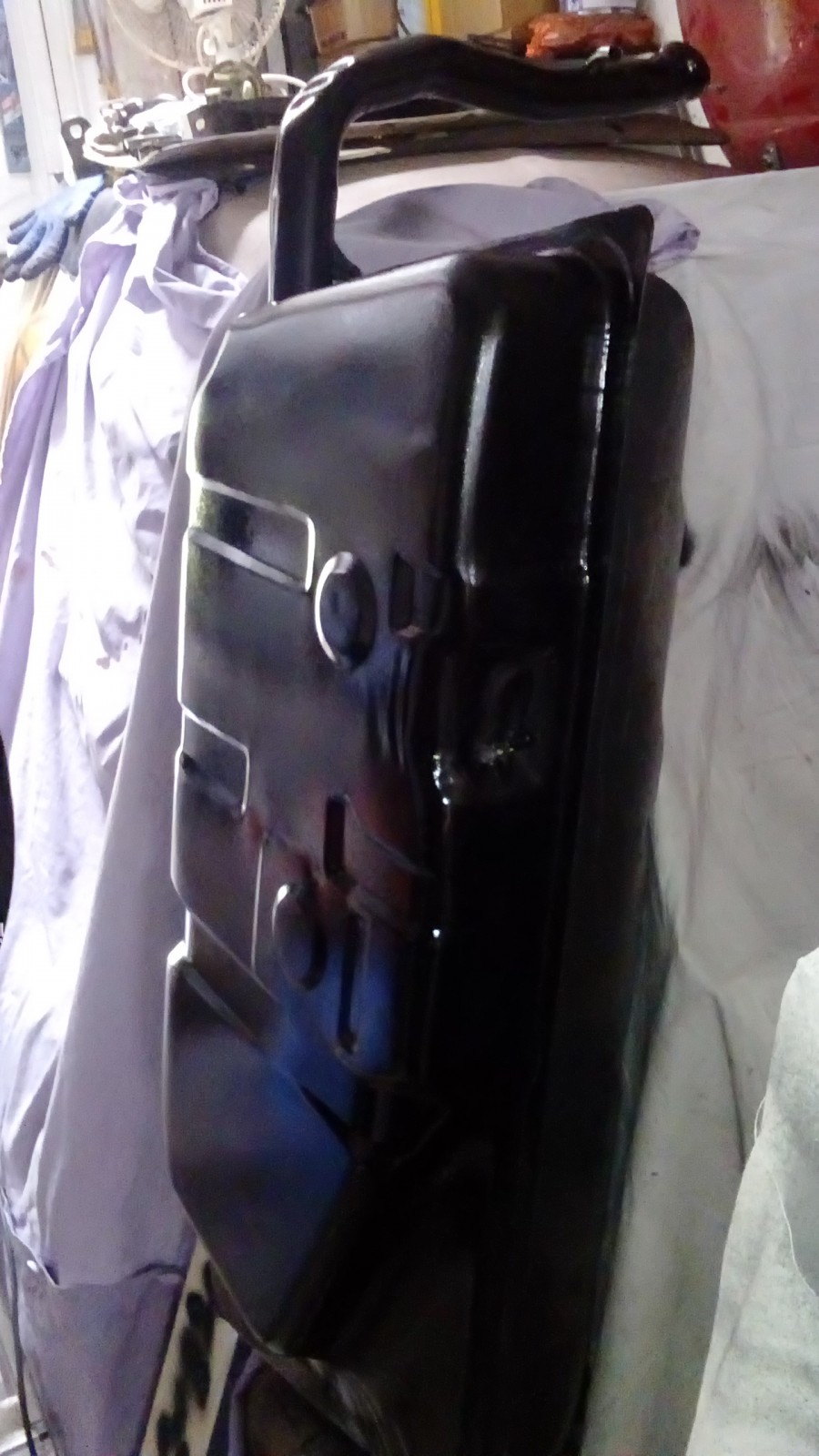

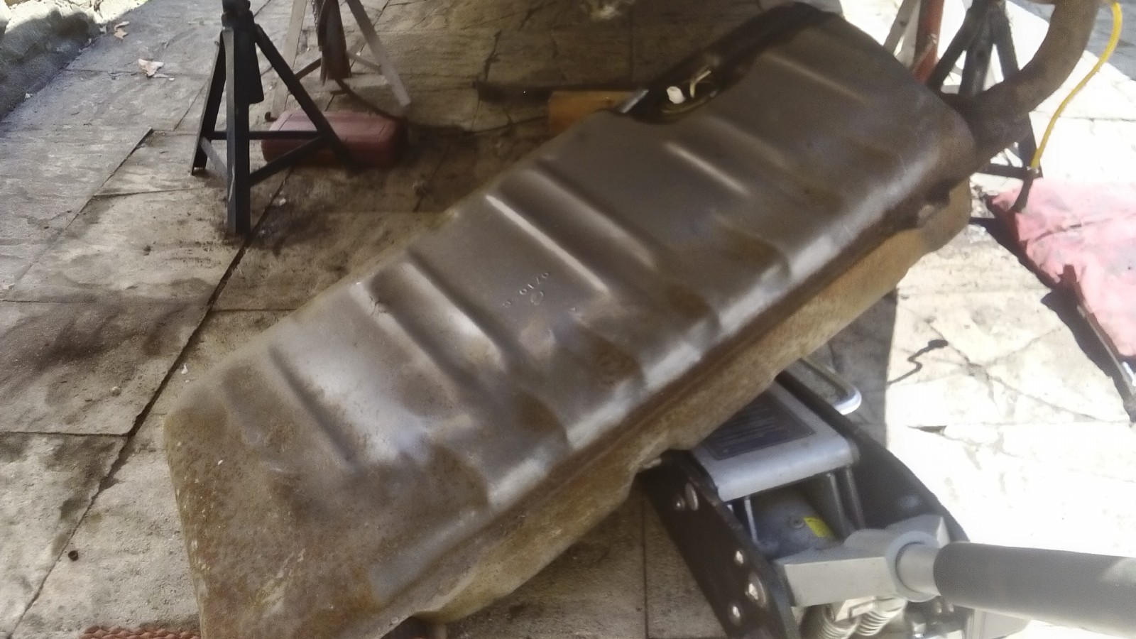

Out came the rusty tank. Some may say it looks ok but its was leaking from the lower neck . I have new replacement tank been prepped for epoxy paint.
Edited by 1vw2many
New petrol tank been taken back to metal and sprayed 3 coats of black epoxy 121..
