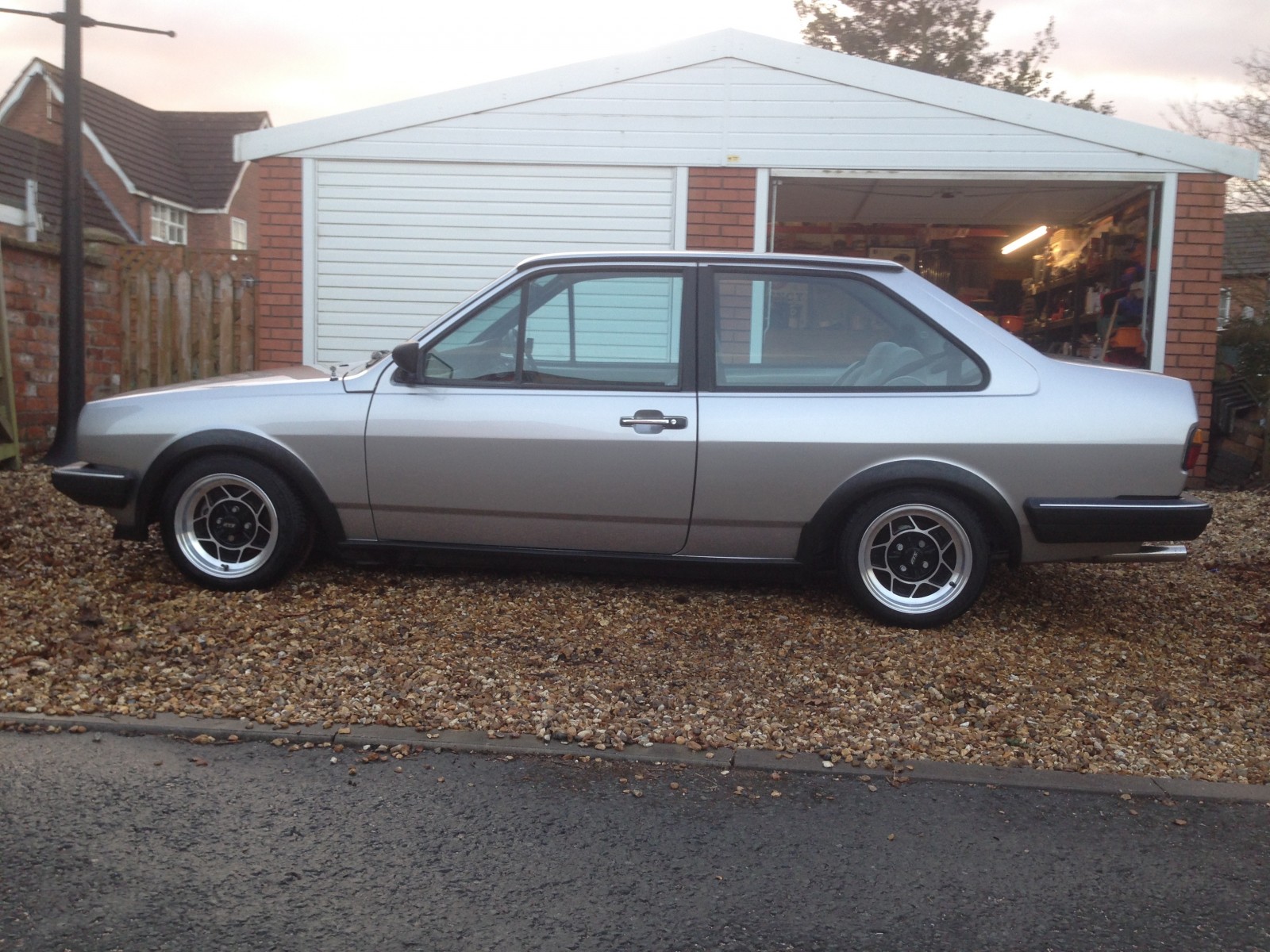

It's been a while that I have posted or done anything on my car it's been a hard few years in life. But had enough and I want the car finished and ready for me to get married in.

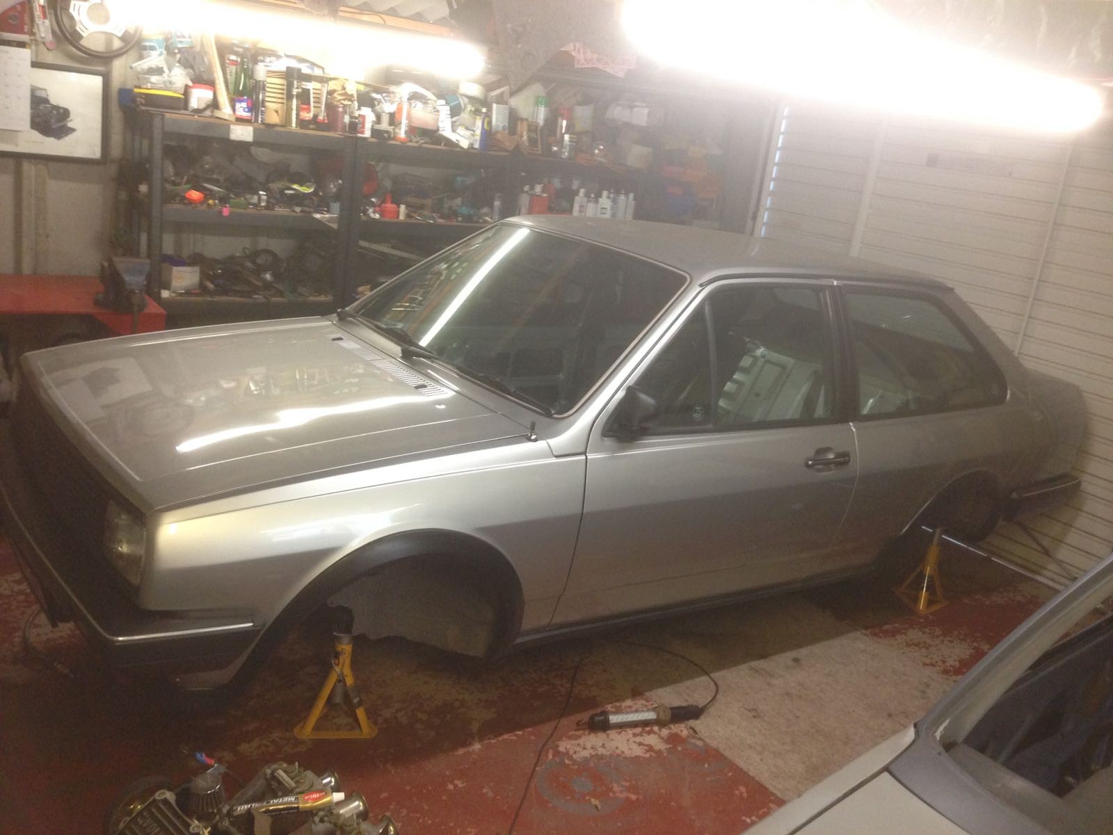

This was the old one I got this from Phil J, unfortunately, dies from rust.near seat belt points.

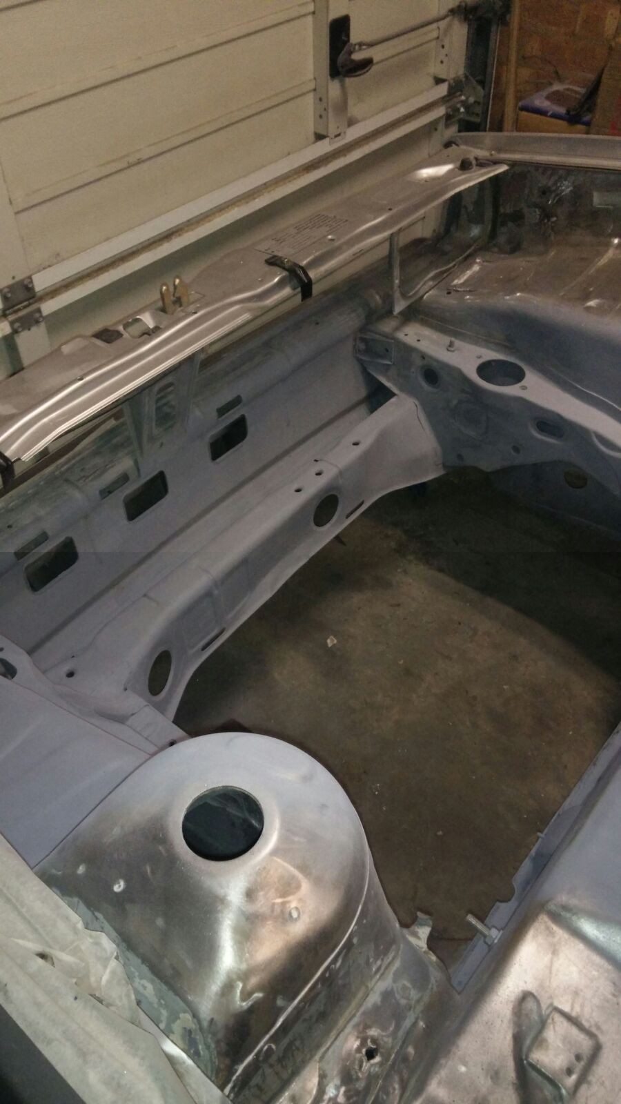

New Shell no engine no suspension just a bare shell
What is used to look like

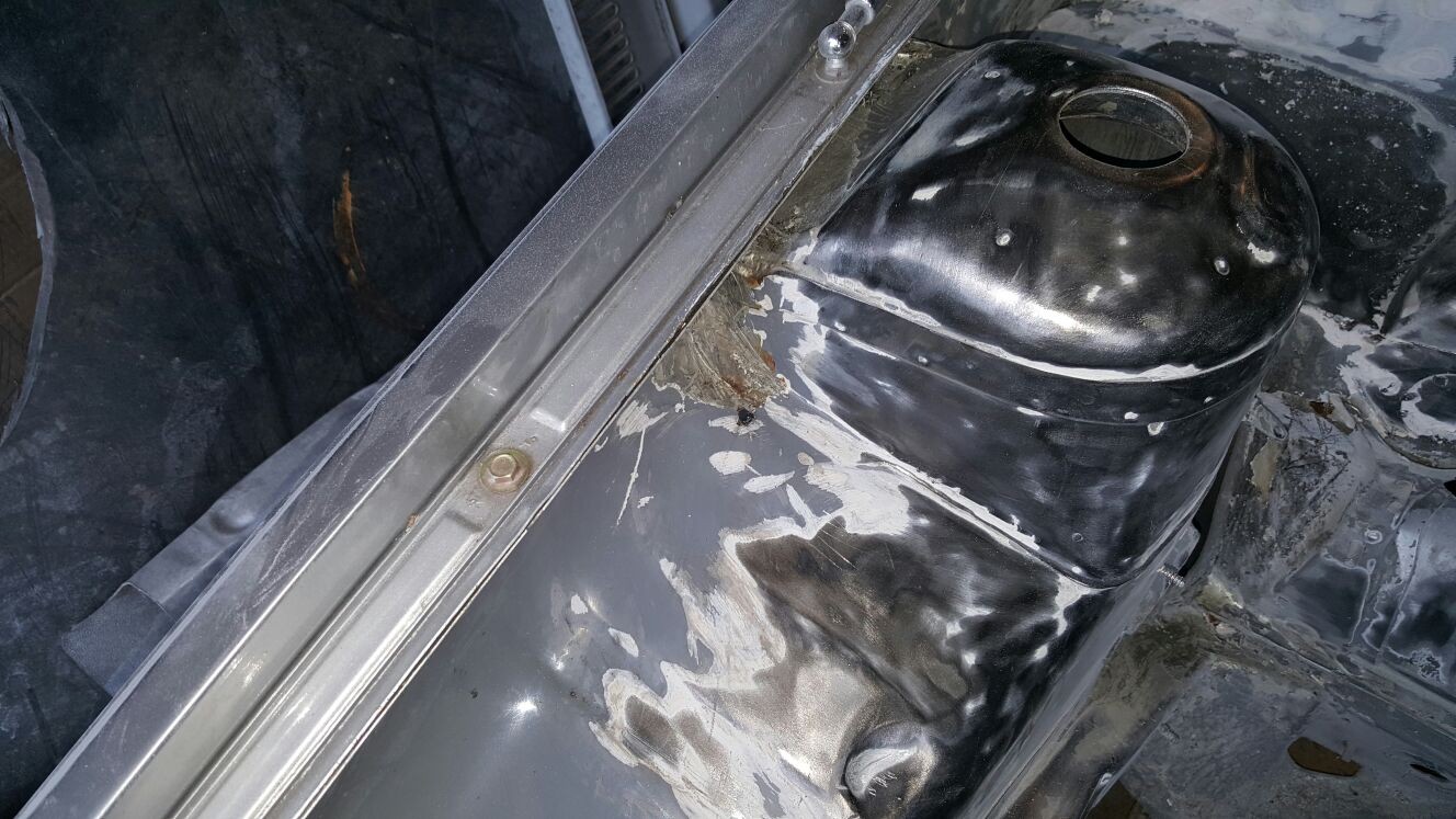

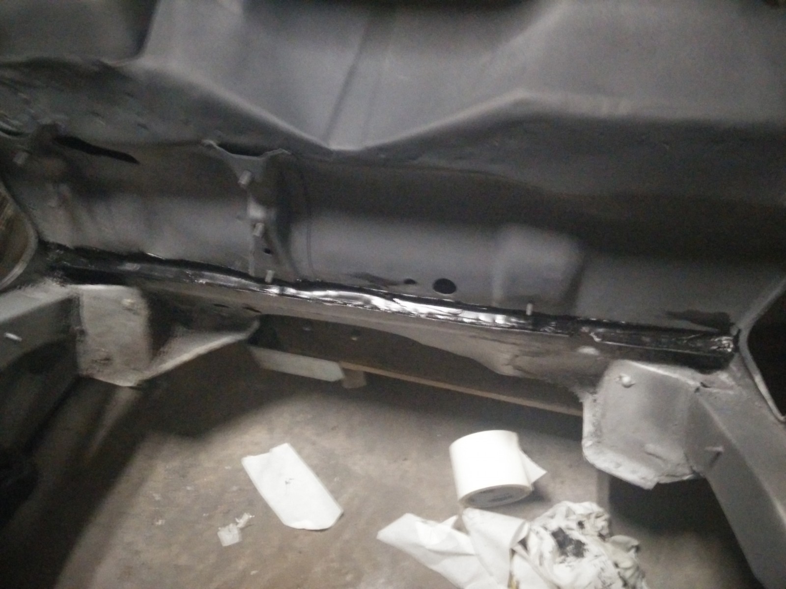

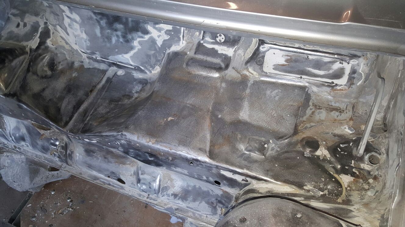

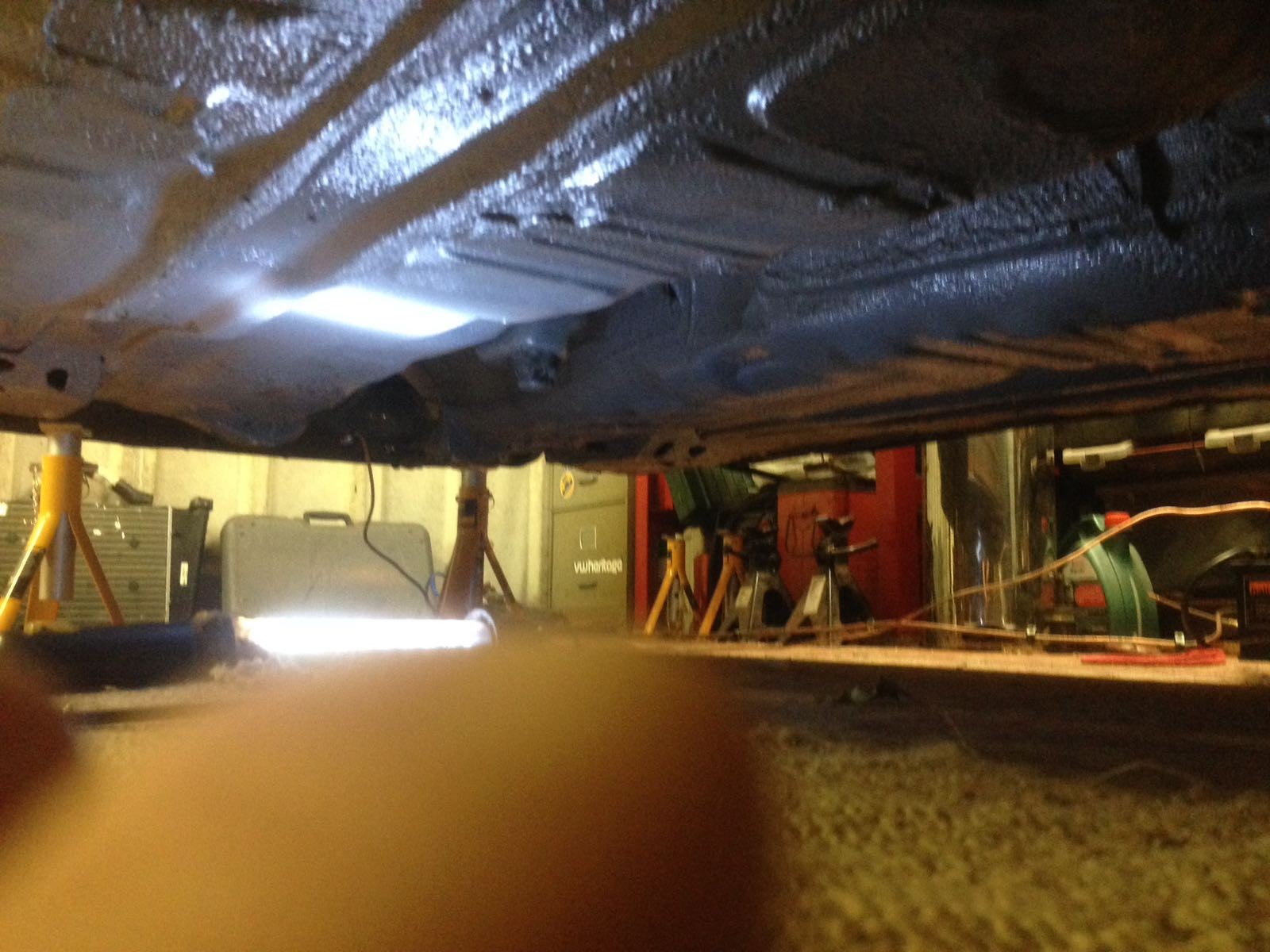

The engine bay has been stripped of all the smoothing as it was all flaking off. under the smoothing and a ton of filler there were a few bad bits which have now been sorted I will upload more pictures once I find a better photobucket

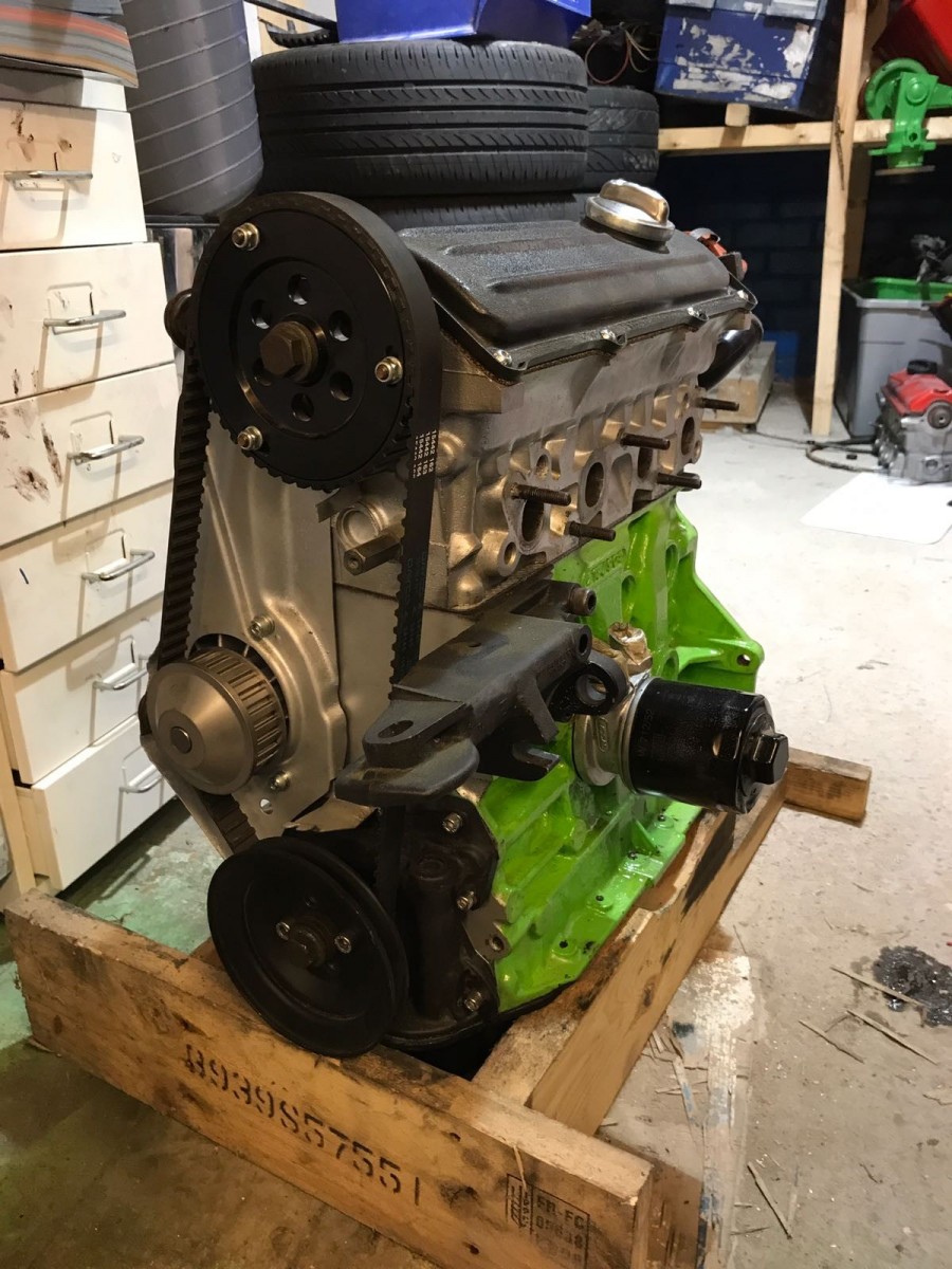

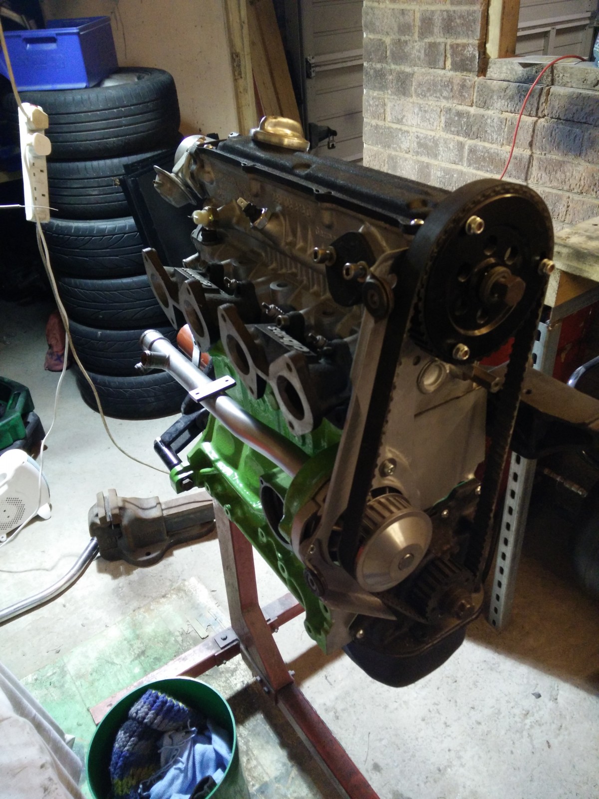

The engine
New Seals, rebored, new bearing, 3 angel seat grinded valves, pinto exhaust valves as inlets 924 pully, standard cam at the moment to run it in

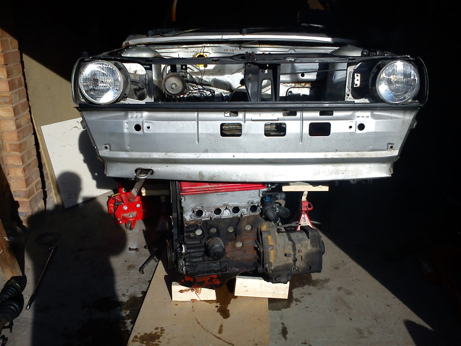

Old engine and shell.

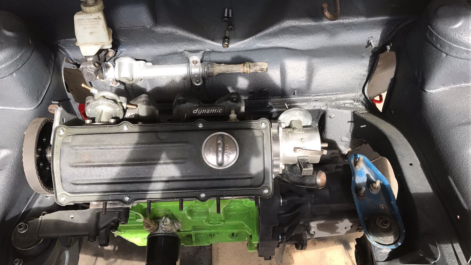

residentmelon

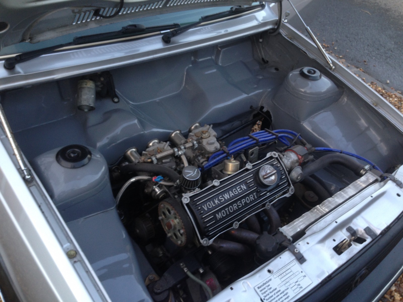

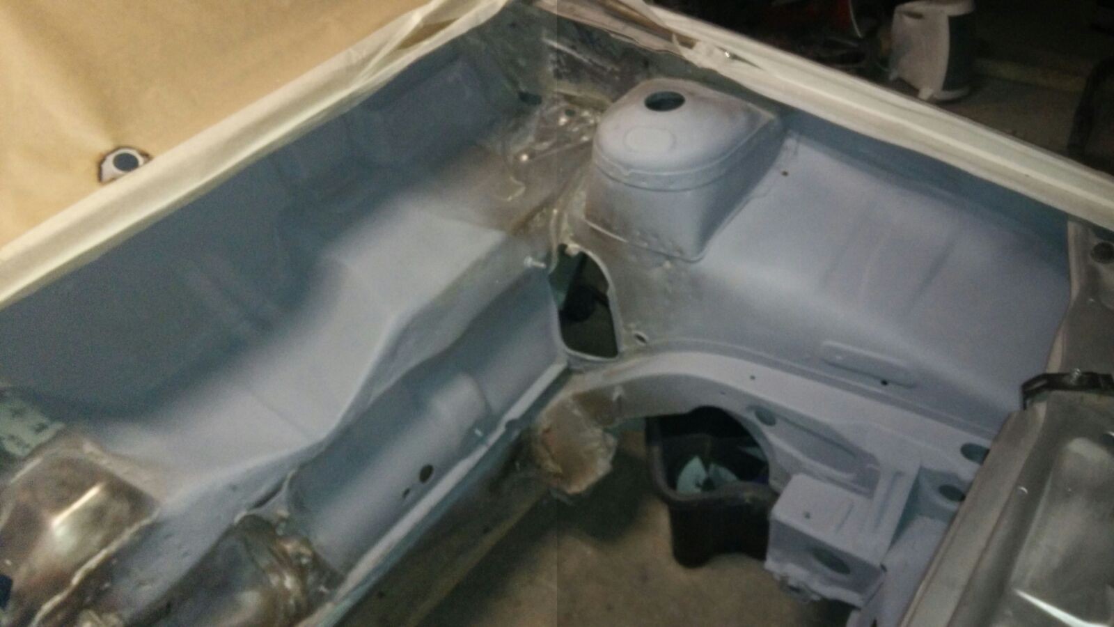

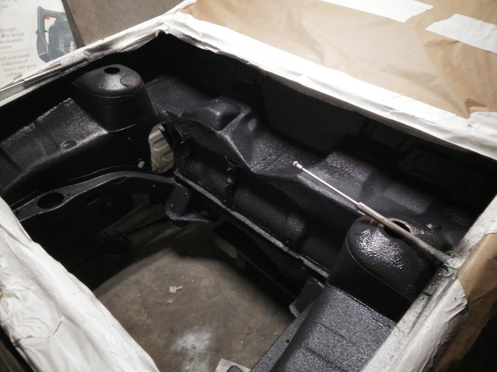

Raptor Painted engine bay

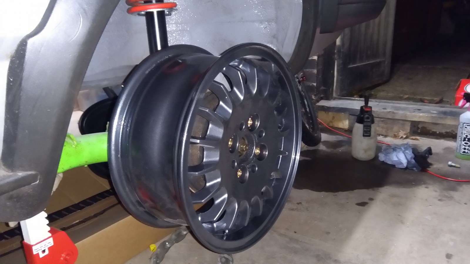

residentmelon
New Alloys and shocks

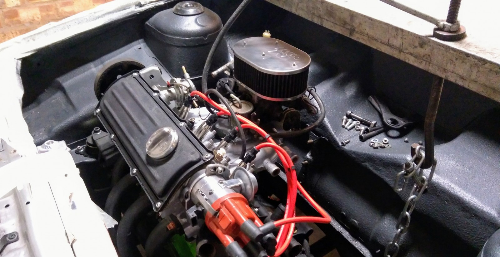

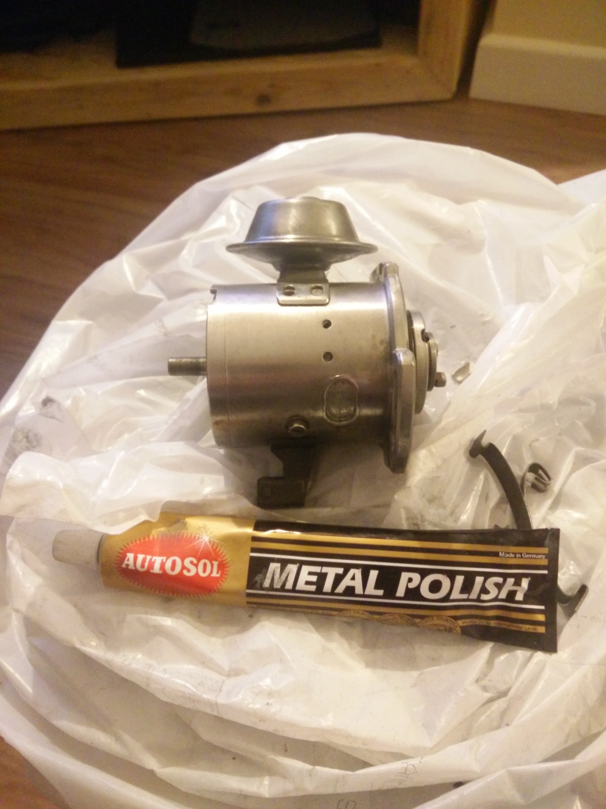

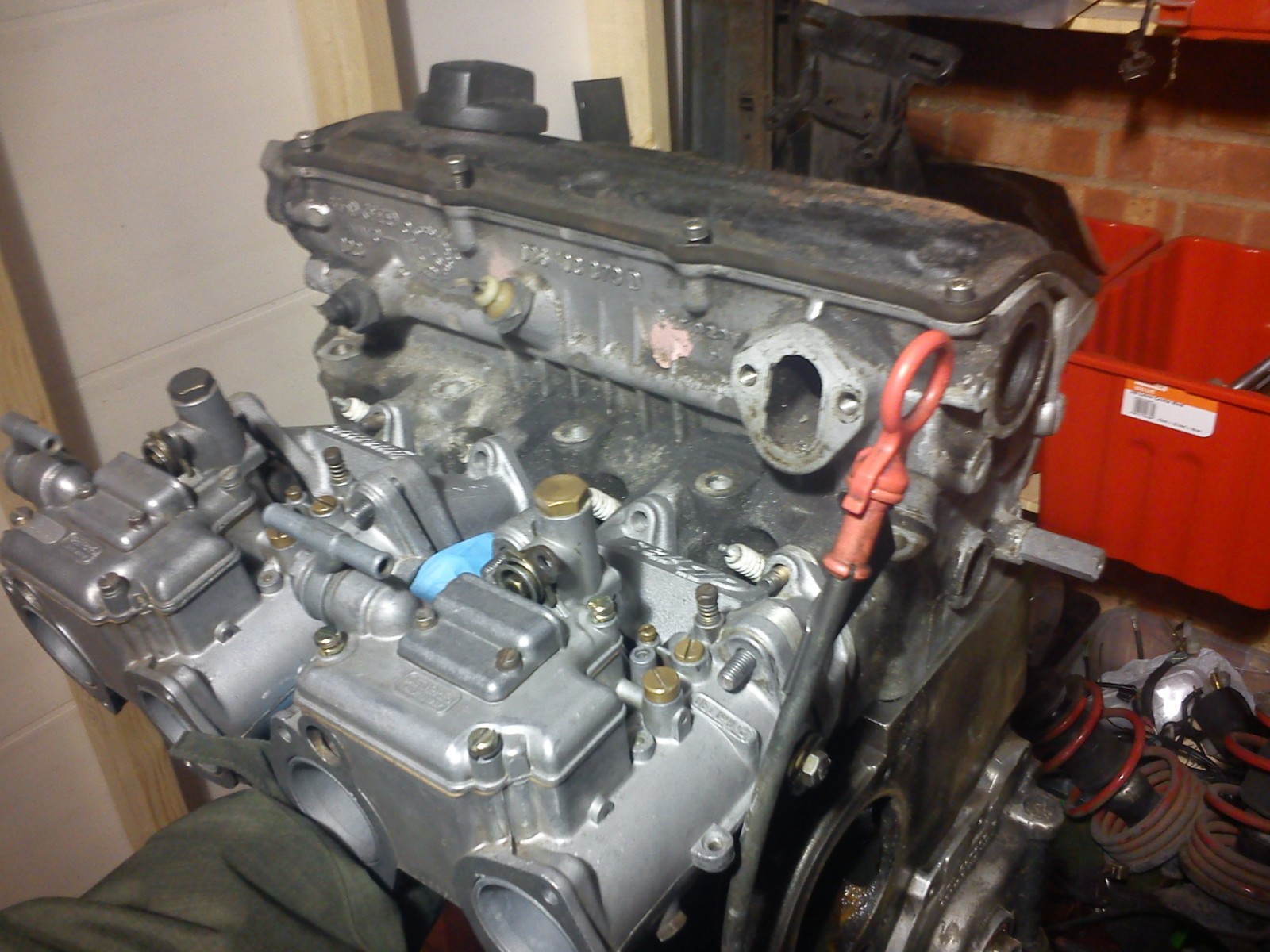

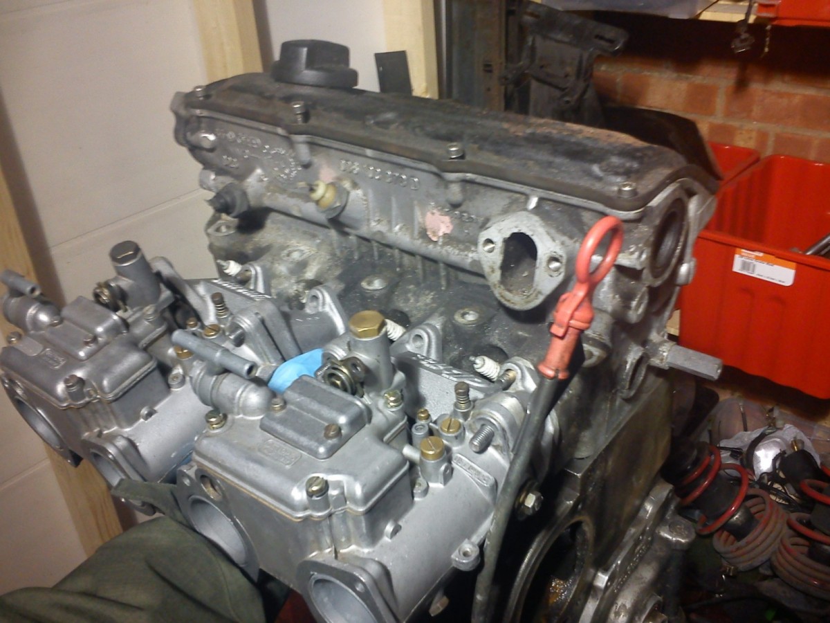

Managed to get hold of a Seat Ibiza dizzy with a vacum and electronic igintion

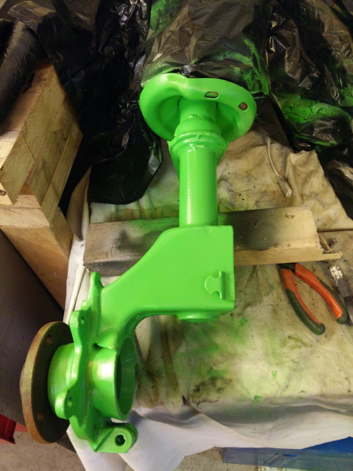

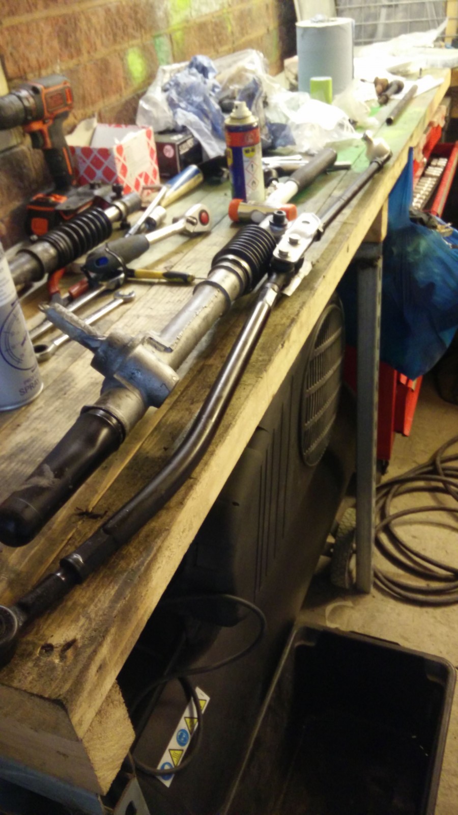

Steering Rack Built up can't remember if the bent on is for the right or left

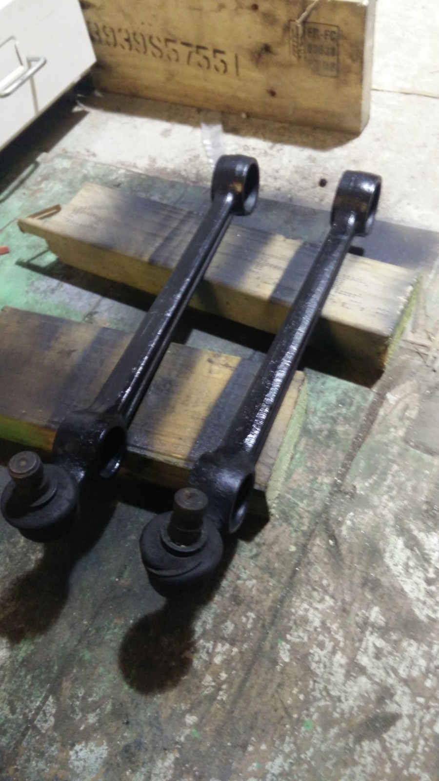

Lower arms painted

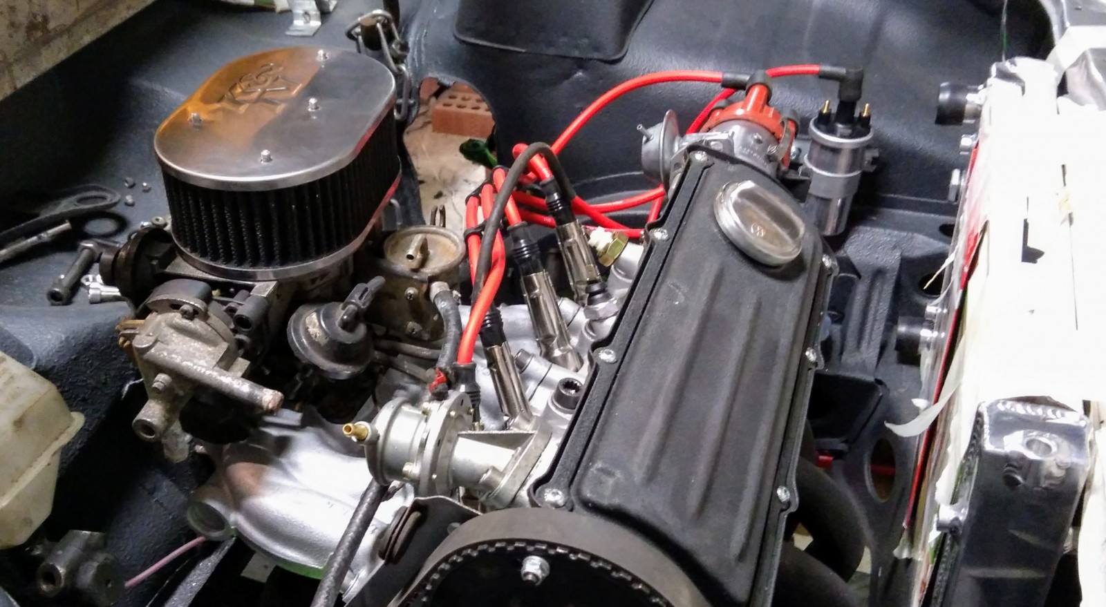

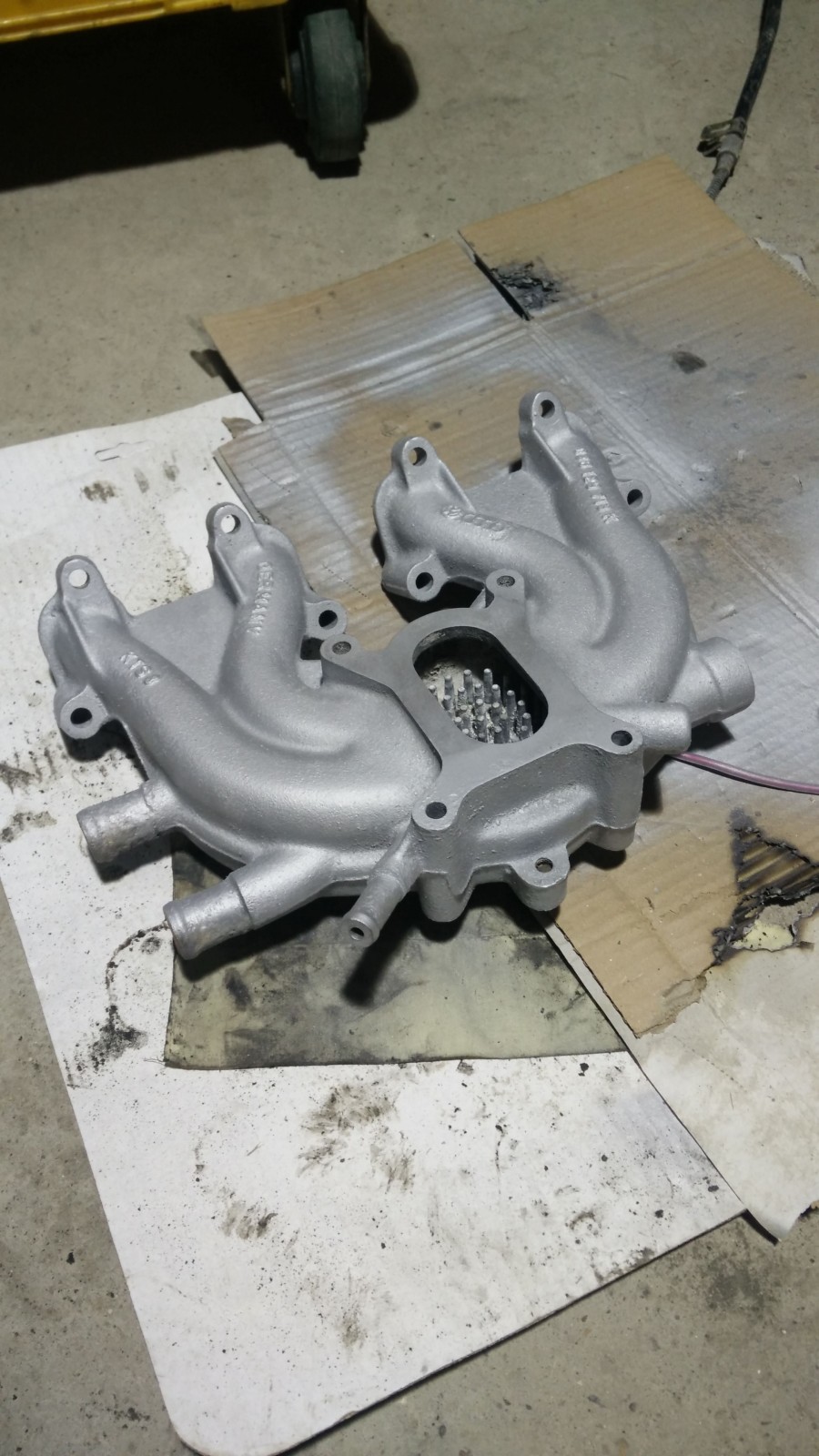

Single inlet manifold for a twin choke weber just in case i can't get the twin 40's to work
Engine test fit for wiring up a new loom note the four speed box will not be staying the 5 speed is in the extate at the moment

Bit worried about the twin 40's on a standard cam think it might be a bit rich

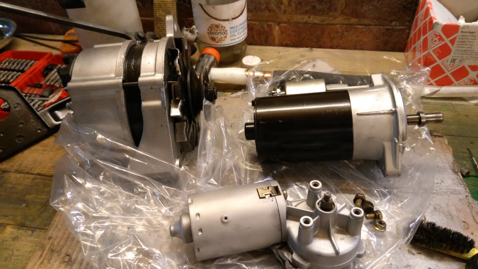

Some shinny stuff and some test fitting

residentmelon

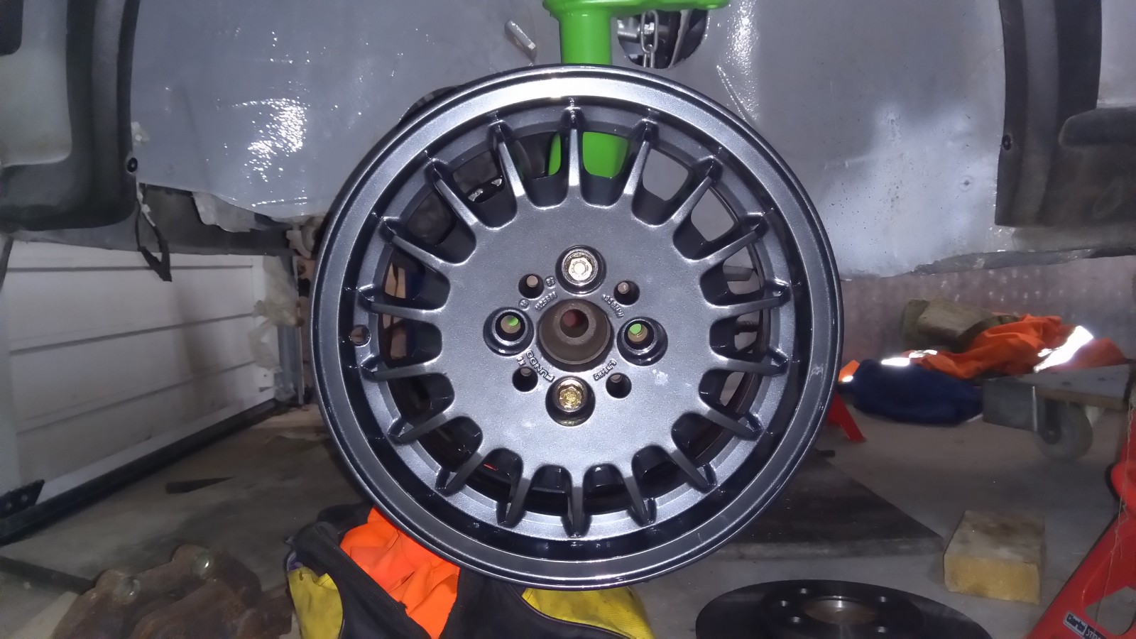

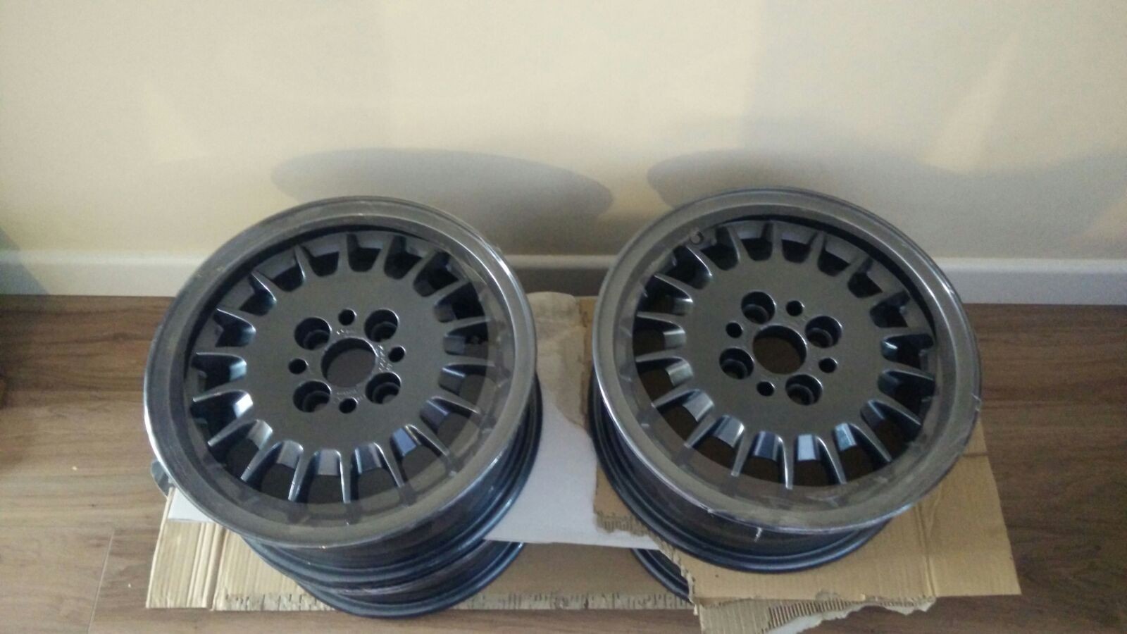

New Wheels

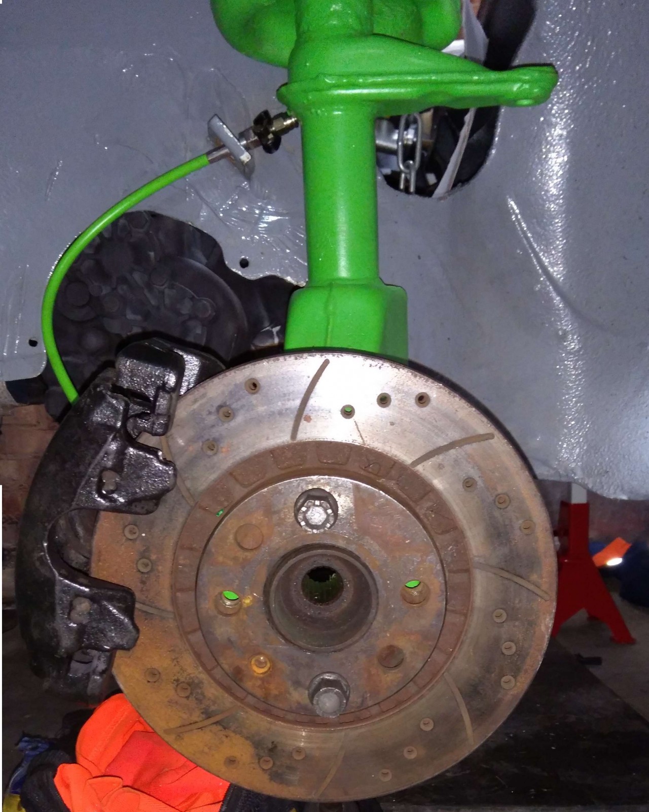

I had a bit of a problem I wanted to fit Vauxhall Brakes got the carrier and calliper and had new brake hoses made.
 Problem is they don't fit under the wheel by a nats nuts.
I think i need different carrier has anyone else done the Vauxhall set?
