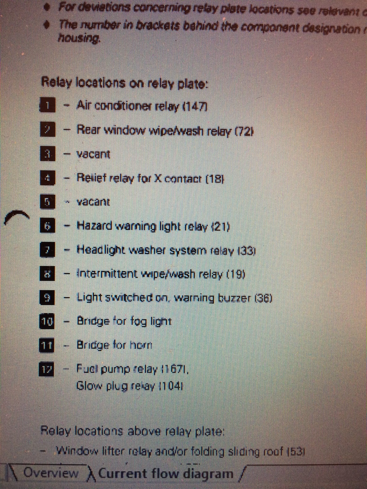

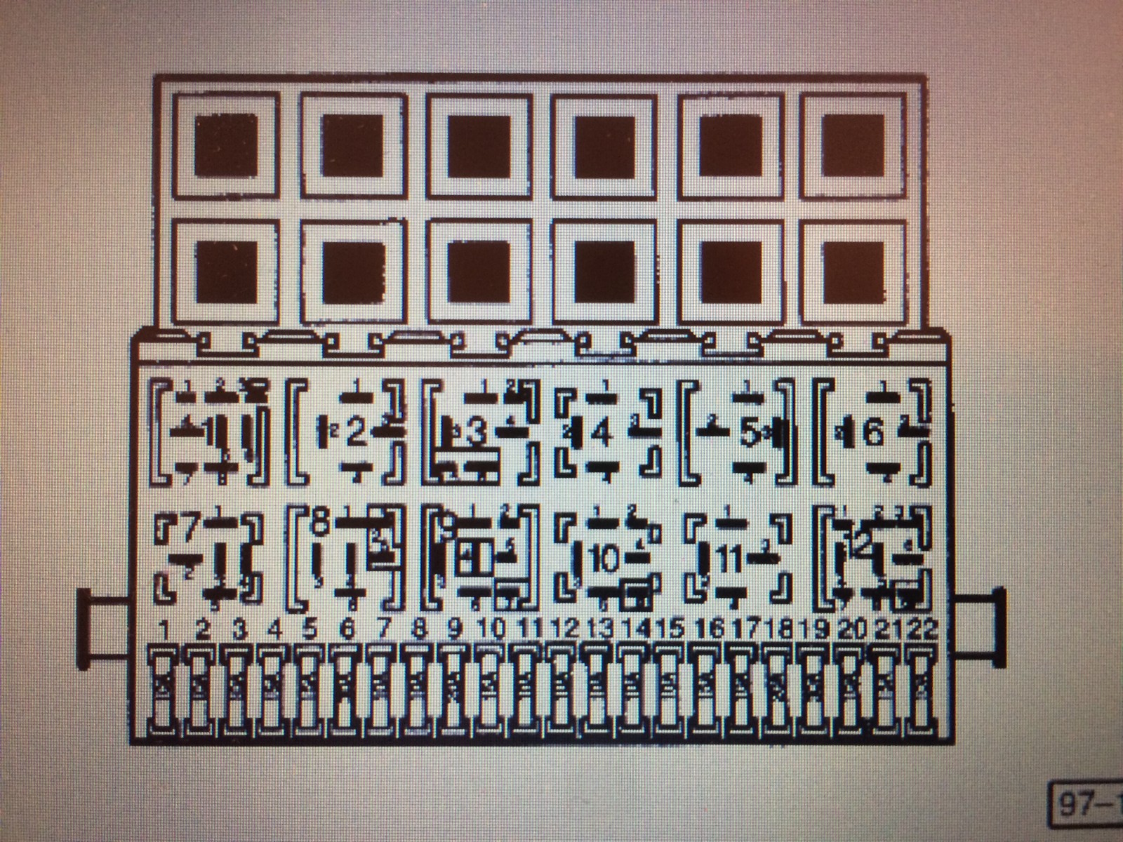

Can anybody paste a link to what relays do what for a 6n Polo please? Been having trouble starting for a little while, and just happened to tap a few earlier, and car started straight up, but want to see if was a fluke or related to ones I tapped. Thanks

Need to know what year/month ?  easiest way is the speedo layout, what are the positions of fuel & water temp gauges ? top centre or bottom outside ?
Bottom outside
Great thanks. That all marries up to what I have. IF Relay 167, fuel pump relay was bad, would that possibly cause a mare to start it up and have to pump the throttle for ages? Or if it was bad, it wouldn't start at all? Just got a multimeter and checking some online videos to see how to do properly, but don't see the harm in asking a man who really knows his stuff :-)
Yes if that relay is bad, the pump won't run, so no fuel pressure= no start
