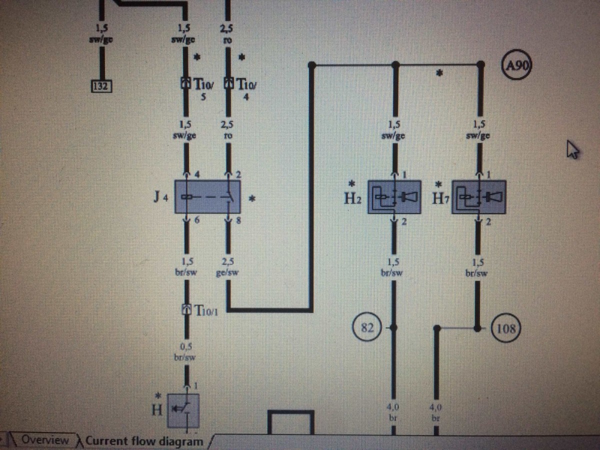

Only the GTi with the dual tone horns has a relay

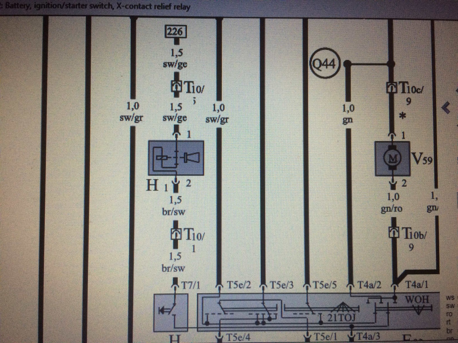

Do you have a constant 12v @ the horn ? if there is, check to see if you get a good ground when you press the horn, if not try it at the bulkhead disconnect T10/1
The diagram doesn't show the airbag slipring for unknown reason ?
This is the diagram for the GTi
