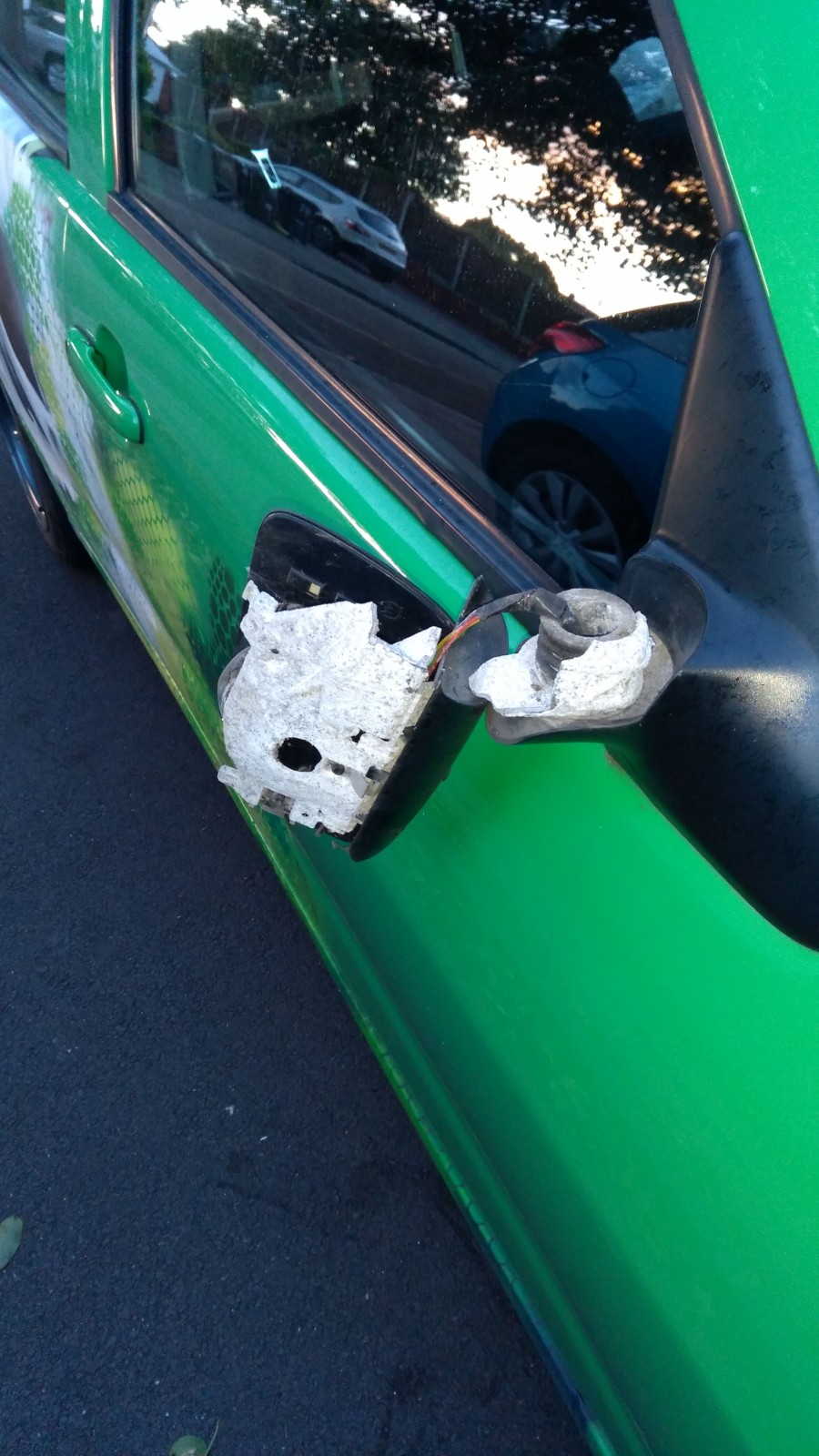

Broken Driver wing mirror on Polo Estate 6K
Came home the other day to find my wing mirror broken. Nice. and no one to blame.
The 6k polo is a strange beast shares more with Ibiza than a Polo
been on ETKA and the only mirrors that share the same numbers are from Seat Vario / Cordoba and Ibiza and other 6k polo.
My question is does any know if Polo 6N or other VW fit. I will be removing the mirror and be taking it to a scrap the weekend to see if I can match it. but a heads up would be nice.

I fitted a 6N2 on my 01 Ibiza but had to swap the electrical connectors over, so yours might be the same ??
Nice one thank you, I remove it take the broken end to the scrap yard but have a more selection to look at.
I can confirm a 6N1 wing does not fit. The bolt holes are in a different location
