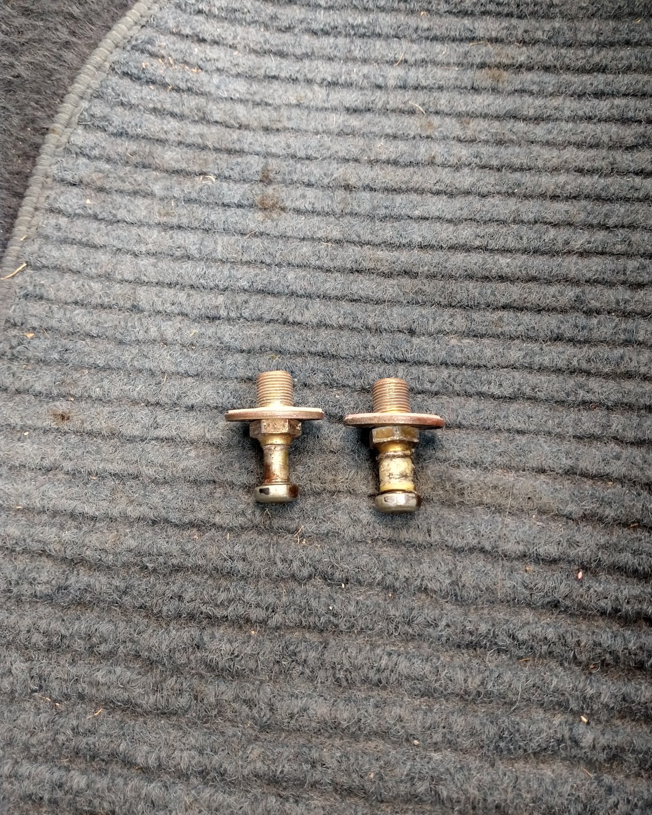

    https://www.ebay.co.uk/itm/Driver-or-Passenger-Side-Door-Hinge-Pin-SEAT-Toledo-Mk1-1L-VW-Passat-32B/401554257944?fits=Model%3AGolf&epid=1138154598&hash=item5d7e7fb818:g:TvcAAOSwF25bJ9J

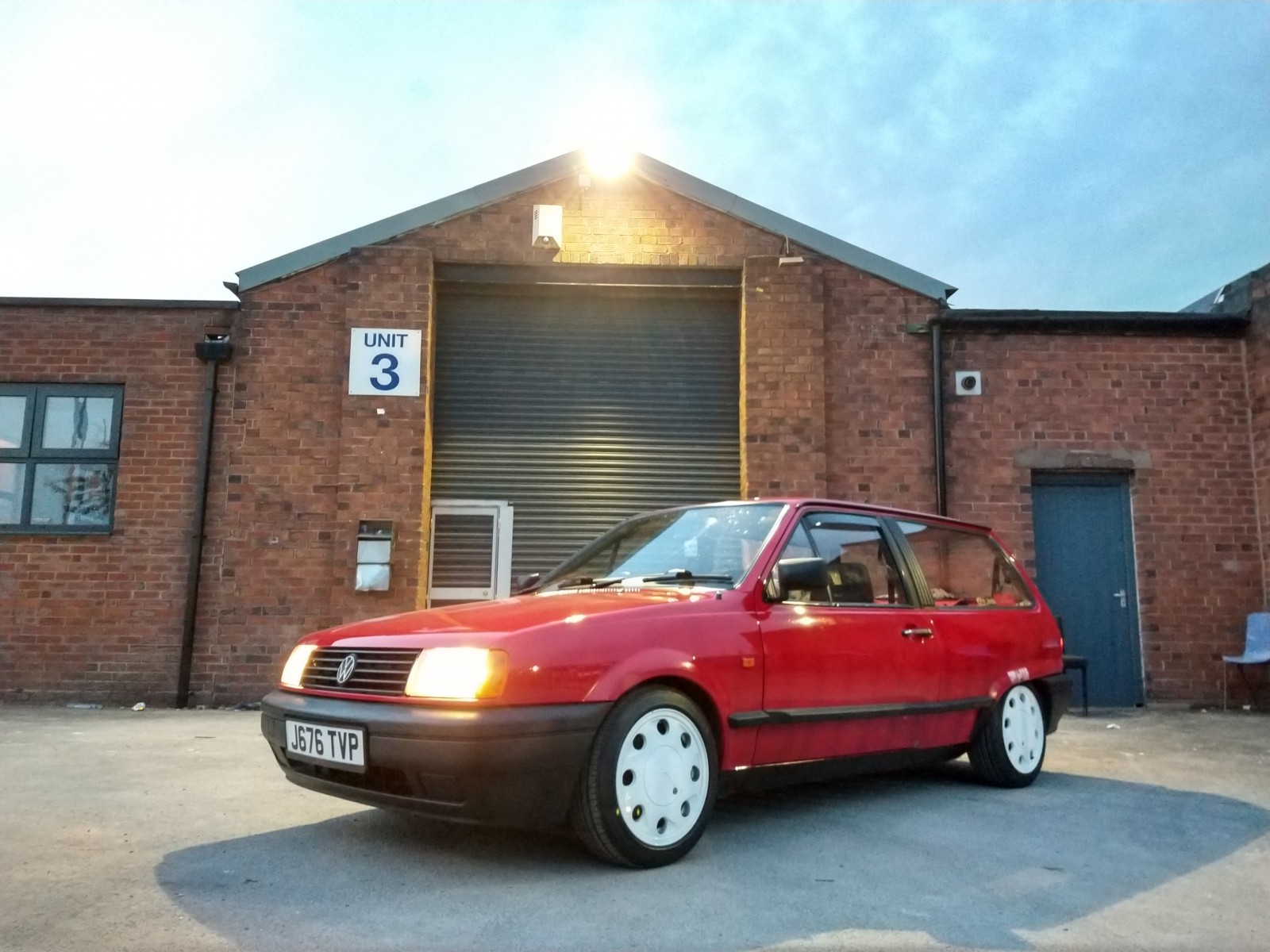

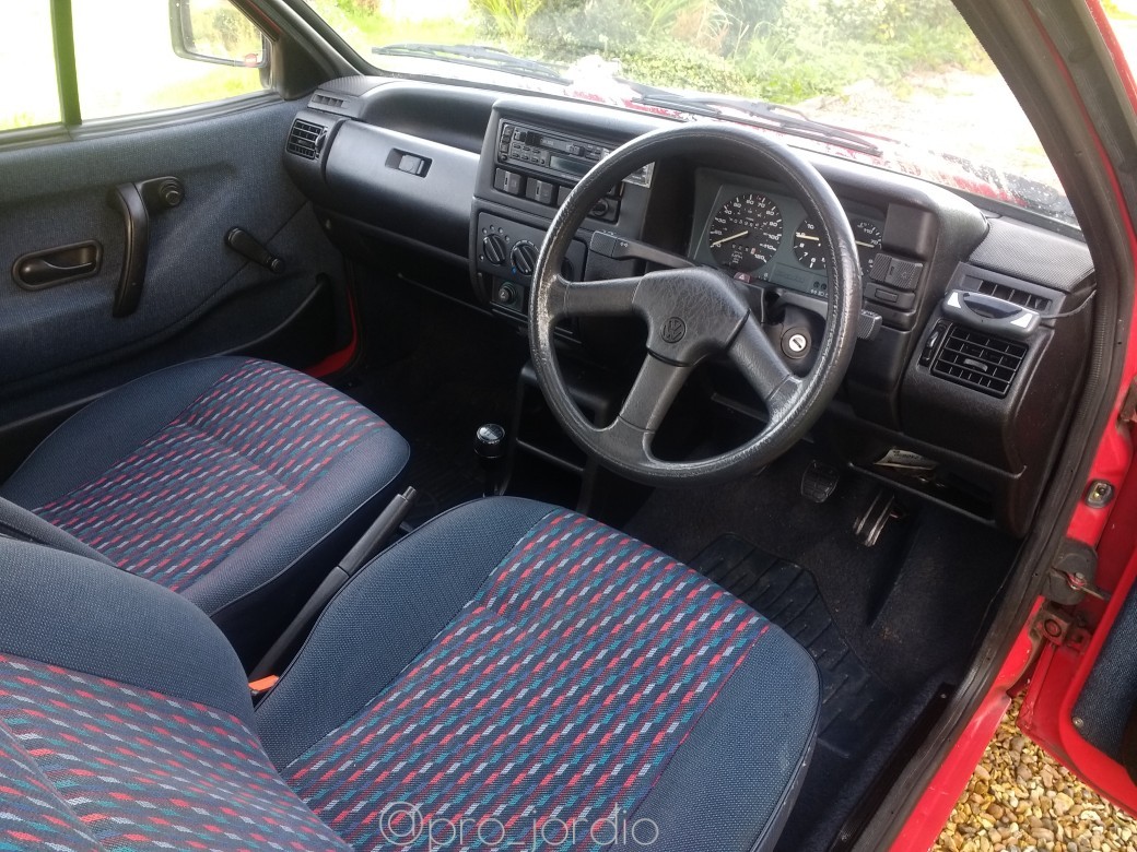

 Figured out how to compress my 10mb photos ??, struggling to decide what wheels I want since I'm limiting myself to 6j. It could do with new plastic trim all around,bumpers and a respray but that's all gonna have to wait till next year with better weather. Also need to get the driver's seat restored since the foam has collapsed on the backrest?.

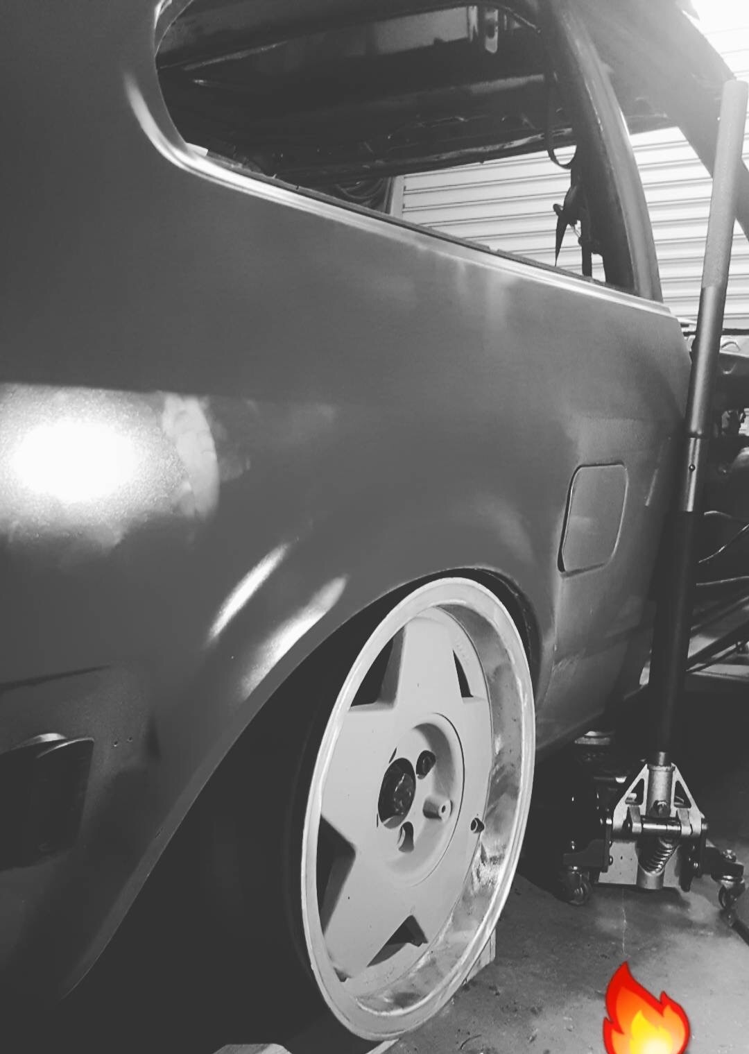

Borbets fit really well without spacers 15inch 7j et35 IMG_1176.thumb.JPG.fbec466a39b09d146f3d566e9338a78d.JPGIMG_1177.thumb.JPG.eeeb043f647c3f9b3c54784a909627f7.JPG
Is that on the coupe?,  I thought breadvan were much tighter fit.
Thats a coupe not a breadvan which is more restrictive
Was going to say haha, I've been told 6j is as far as I should go really

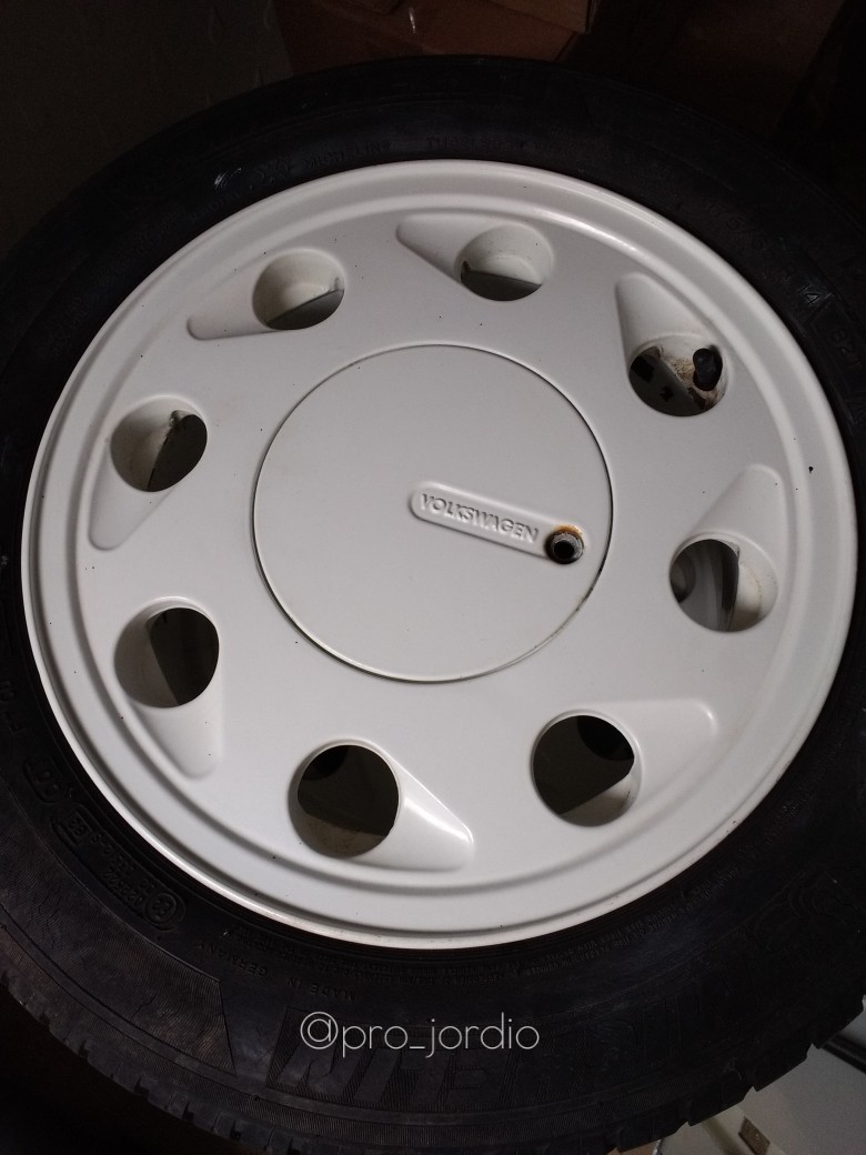

So I recently bought some vw teardrops. Plan on getting them refurbished and polished but I don't know what tyres I should get for them, I dont want massive stretch as I would prefer grip
So im just wondering will 175/50r14 fit on my bread van without scrubbing, will be running on the teardrops with 40mm drop. thanks in advance
I would ask this question in the technical "wheels & brakes" section and there is a guide in the FAQ's in that section that covers wheel & tyre sizes

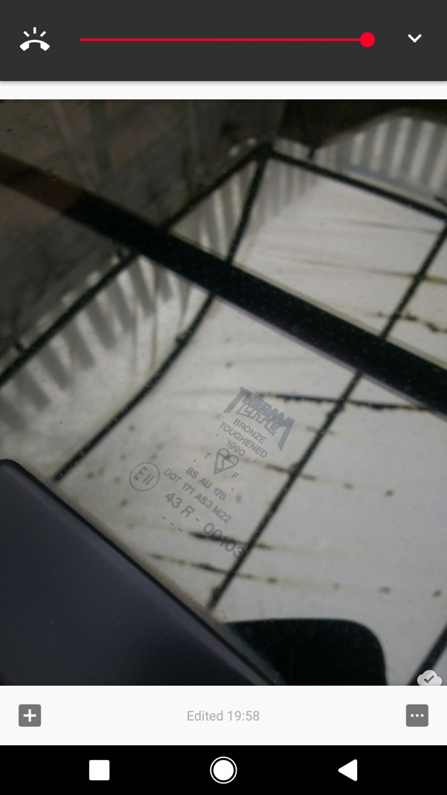

After some advice as I can't find anything on the forums, bought my polo with a sunroof sealed shut, it's a dealer fitted one so the glass lifts up. It's leaking through the seal so I'm wondering what I can to to fix it,cheers

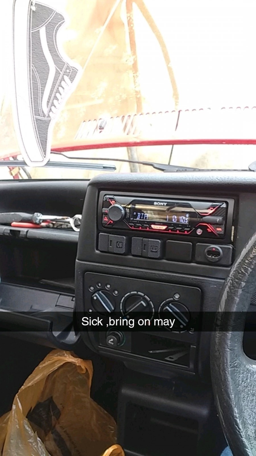

Managed to figure out the stereo situation, had to repin the rem power cable as it wasn't lined up by its all good now. Need to swap the stock speakers for the alpines I bought but not sure on how I'm gonna approach that. Also can't figure out why my interior light doesn't work, I got another one and that doesn't work either so any ideas would be ace .

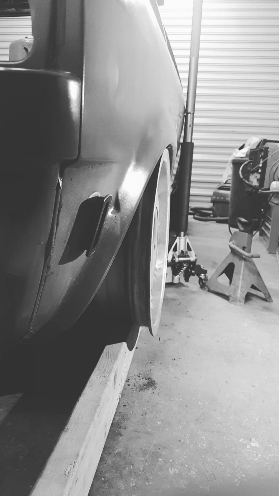

Within the first week I lowered it on an 80/80 mm kit after finding out the shocks were dead and the springs had been cut by the last owner. Then I've had a stainless steel exhaust custom made and it sounds alot better . The teardrops just fit under the arches with alittle work done 😂. Running 165/55r14 nankangs as1 if that's any help to anyone and they're alot better quality and grippy compared to the tyres on the original 13" steelies.

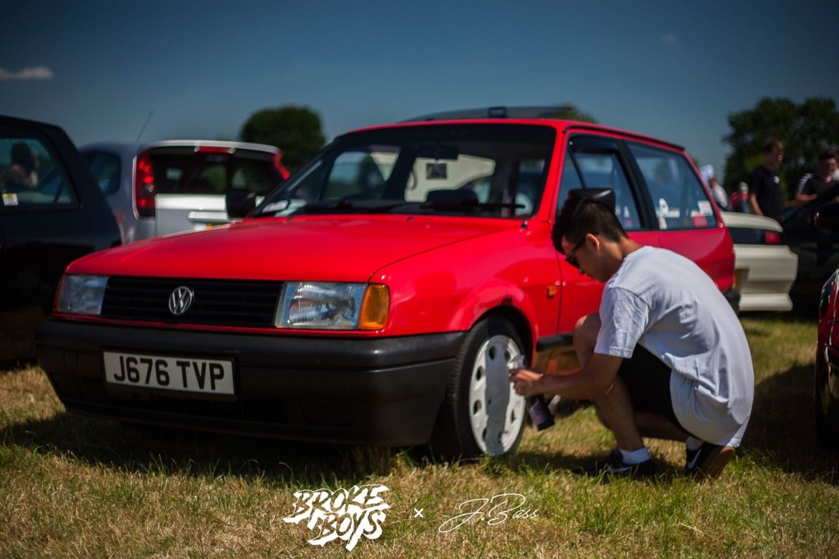

Just thought I'd share a photo of the Breadvan at its first show , want to lower the front though it's already at 80mm drop
