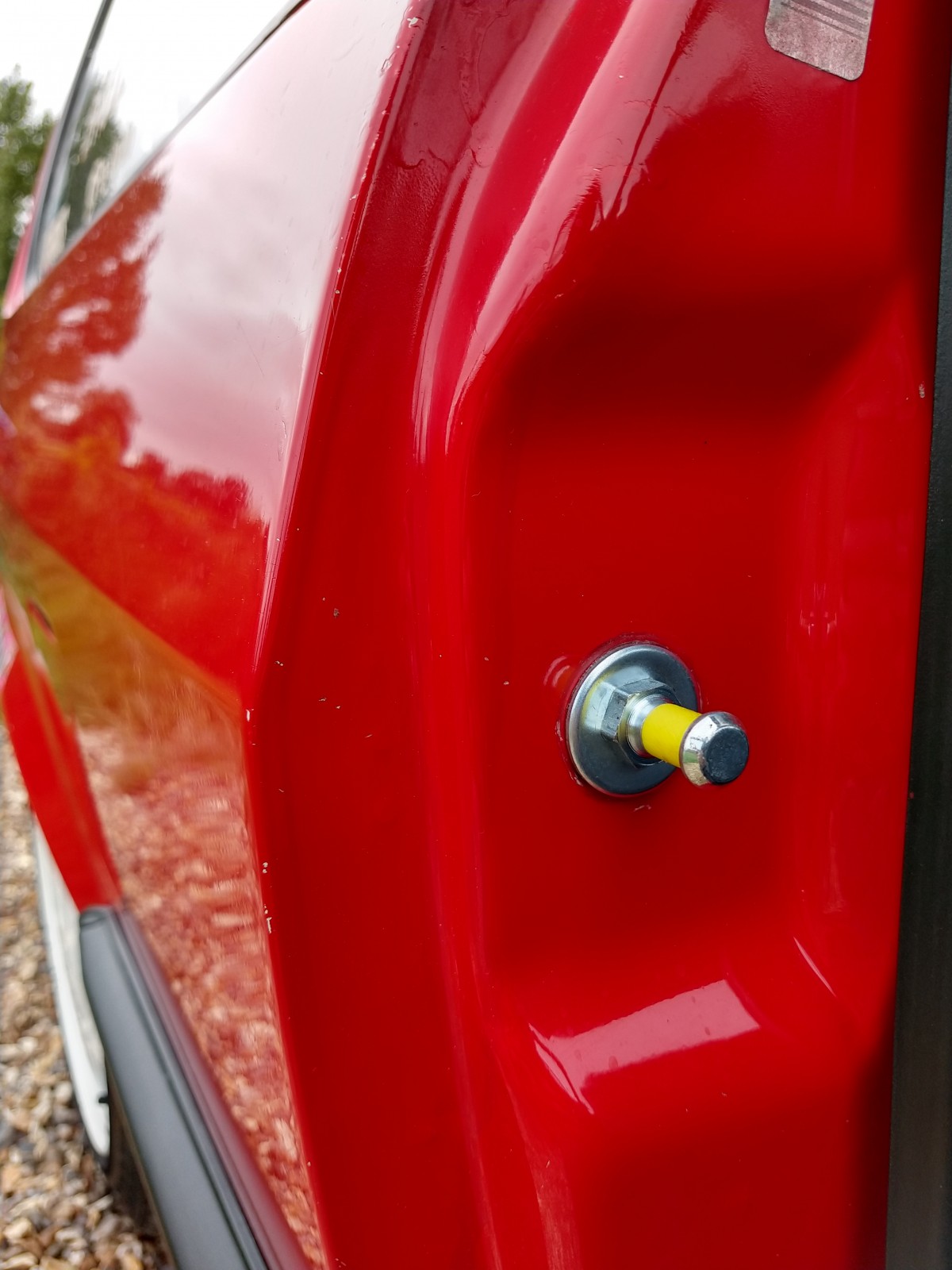

In with the new, the old striker pins were long gone so bought some new ones , easy change over as it was just a 15mm socket with no need to worry about the inside trim as the thread is inclosed. Shame that the hinges have gone so the door has dropped a bit.
