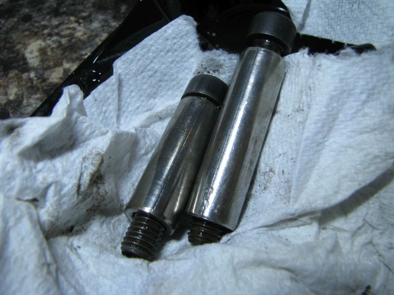

For the caliper overhaul kit go to http://biggred.co.uk/  you will get everything you need from them and fantastic service.
The slider pins again get them from the above, as yes they do have a habit of rounding out the hex head, so I would advise to have a spare set and replace them anyway.
