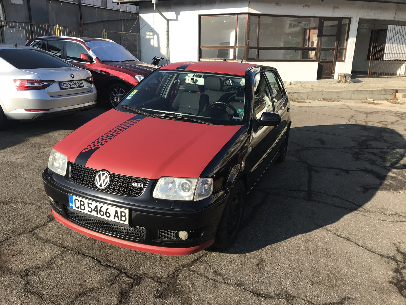

Originally I joined as I got a 1.4 16v coupe 6n2 as a backup car. I have a 3.0tdi A6 that I like to tinker with a lot, and still have a ton of electrical issues with it, the most significant being related to a manual to automatic transmission swap... so I do tend to keep it at a shop a lot. Also it did proove not much practical for a daily use.
But as my mother’s 6n2 gave birth to all of its fluids, I decided to give her mine and get something better, as I was already looking at a possible engine swap for the 1.4...
As a result I got a pretty sweet GTI. I did’t expect much. Got it from a dealer, which was already a bad omen :smile:, but the car was in a surprisingly good visual condition. It hasn’t been driven since at least an year (January 2017) with less then 7000km done in 2016. I got it on 138 000km, and its last history is from Switzerland from 2013 at 118 000km. It is kinda believable that it could have done only 20 000km in 2014 and 2015, but here rewinding the milage is still very much a thing. Still it looks like being close to that arlt least.
The car had its gearbox repaired while at the dealer. Everything else was in order. Of course for the first several days there were no brakes :smile:, until the calipers remembered how to work. I got it from another city, so it wasn’t the smartest idea to bring it home directly after sitting for so long, but it performed flawlessly.
Of course by Murphy’s law, exactly on the next day, I got the ABS lamp on, and a bit after that the Engine check on also. Thse were because of a rear light speed sensor and a misfire in cilinder 1. Alongside the standart service, I changed the spark plugs, the spark leads and the spark coil and the speed sensor. But still occasionally (I think when I sit in traffic) it does log a misfire, which I can’t even register. Will do a compression check next year before installing the LPG system, as nothing else looks suspicious.
The only other issue it had was that the left window didn’t work, while from the driver’s door I could only open the passenger’s windows with both positions of the switch. Also the central locking button on the door could lock the car but couldn’t unlock it. Today I repaired it by fixing a cut wire between the door and the body.
