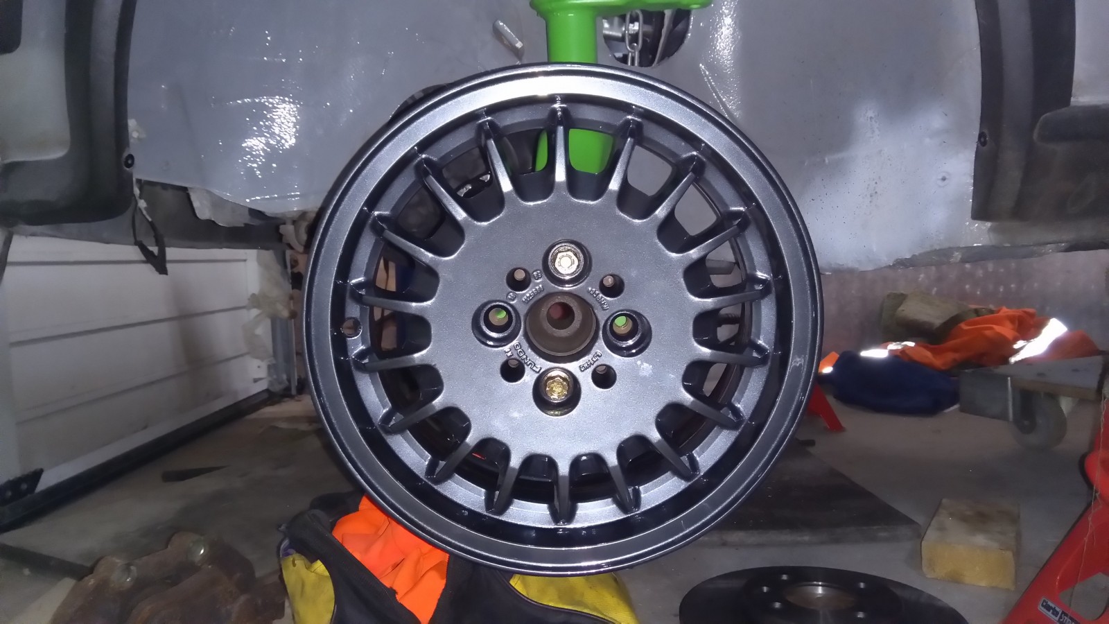

A few more bits and pieces were sorted then it was time to put it on a complete set of wheels. Went for a set of 14" BBS RAs at first which I think looked alright.
20170806_14165120170806_141703DSC_4038DSC_4042DSC_4052
I then got my hands on a set of BMW E30 bottle tops. I think they looked a little better.
20170923_10032620170923_151320DSC_4079
