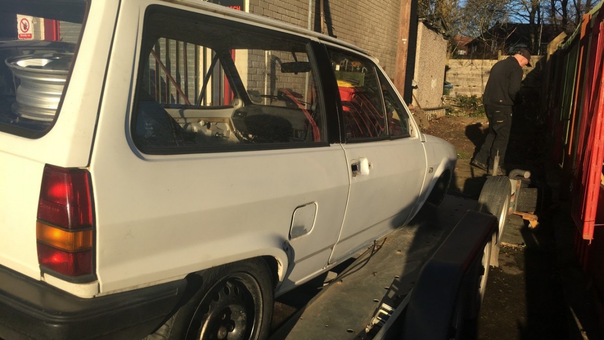

UPDATE
07/03/18
so after a long wait and buying the wrong engine ? (always check engine codes ?) I have sourced a 1043cc engine with the hz engine code which is the one I’m after?
Any way today I started stripping some of the remaining items off the car! And found a hole in the passengers foot well! ( it was hidden underneath the wool sound deadning) it doesn’t make any difference as it’s coming up just thought it was worth a mention!
I also started to pull the wiring out from under the bonnet and on the interior!
(Photos to follow)
