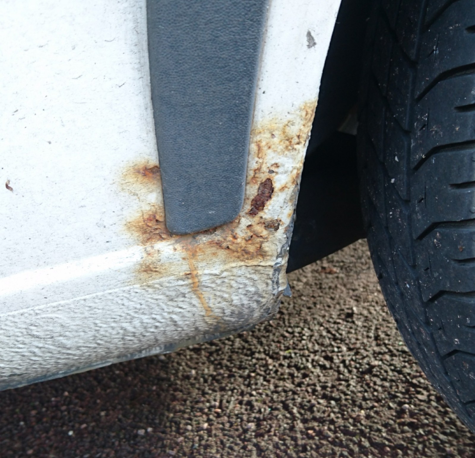

My car has some rust under the black plastic that is glued to the car, does anyone know how to get the plastic bits off and back on so I can remove and fix the rust? Any tips on getting rid of the rust would be great too - it's only surface rust :smile: thank you.

  • The arch ones are not normally glued, there are 2 lumps on the back that go into holes in the body   If someone broke it in the past it may have been glued   Get a small flat head
Get a small flat head screw driver and tape the tip and use that to tease the edges up and see if itll pop off
The long ones on the door have a foam adhesive on the back which can be bought
