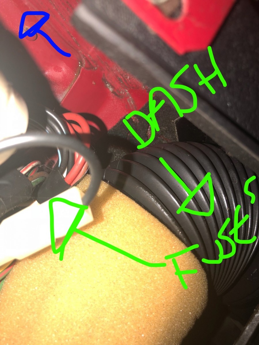

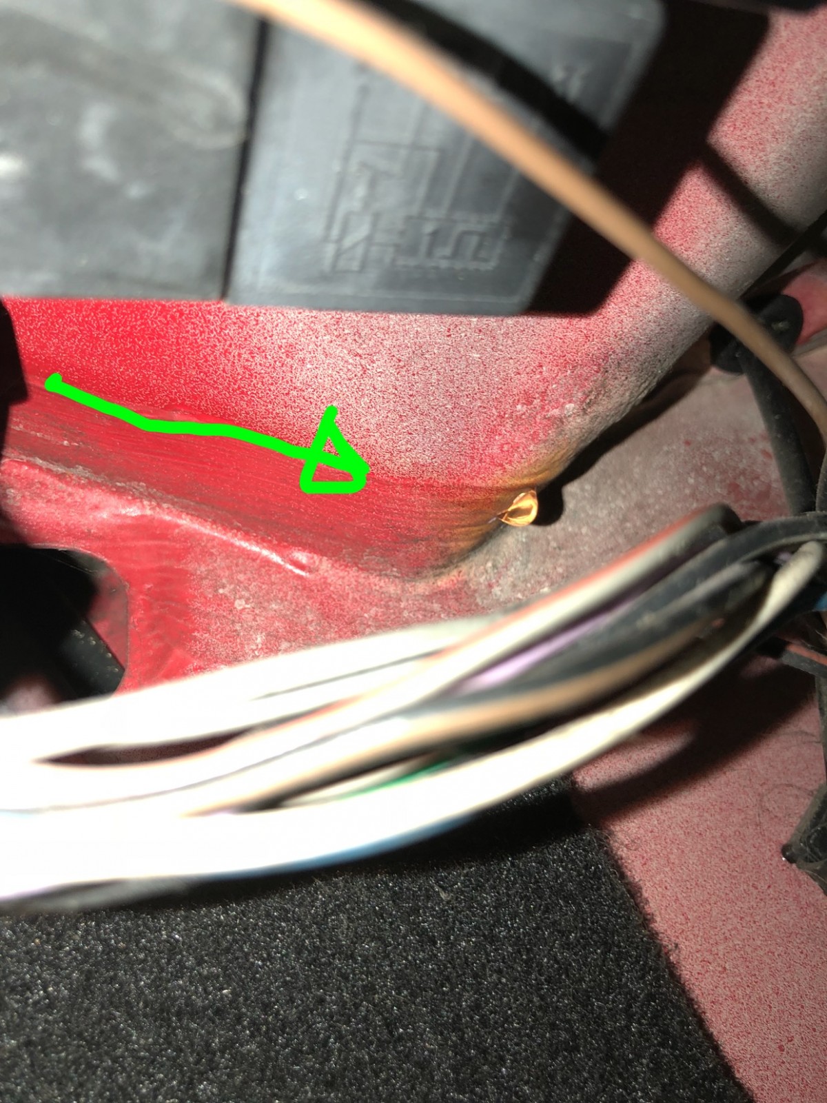

Found the leak in the drivers side, I want to post photos but the club polo site won’t let me, any ideas?
Found the leak in the passengers* side, heres the photos, the second one shows the source, iv tried dousing the fuse tray with dyed water, and the drainage hole and the window seals

Yeah I’d like to think so, struggling to locate the source of the source, the dyed water trick is NOT quite doing the job, it seems to be further up past the fuse tray up in the top...
Edited by YOUNOOWHO
whats the condition around the engine bay /fuse box ...any hint of rust on the seams
if /when you do discover the gap...use automotive /pu sealer not bathroom sealant
pretty tidy to be fair, the middle of the fuse tray has some kind of wear, seems to be kind of rotting or wearing away, that point is lower that the internal leak tho, so I will have a better more thorough look Saturday when I have some time
