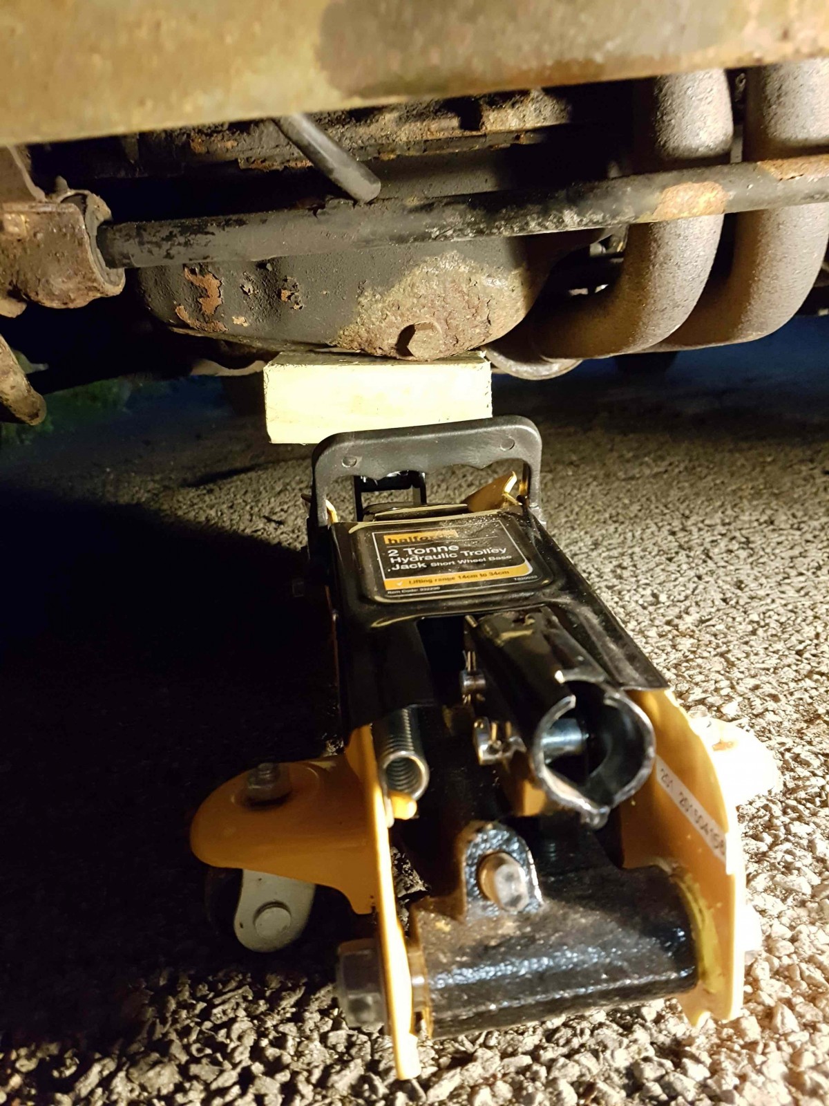

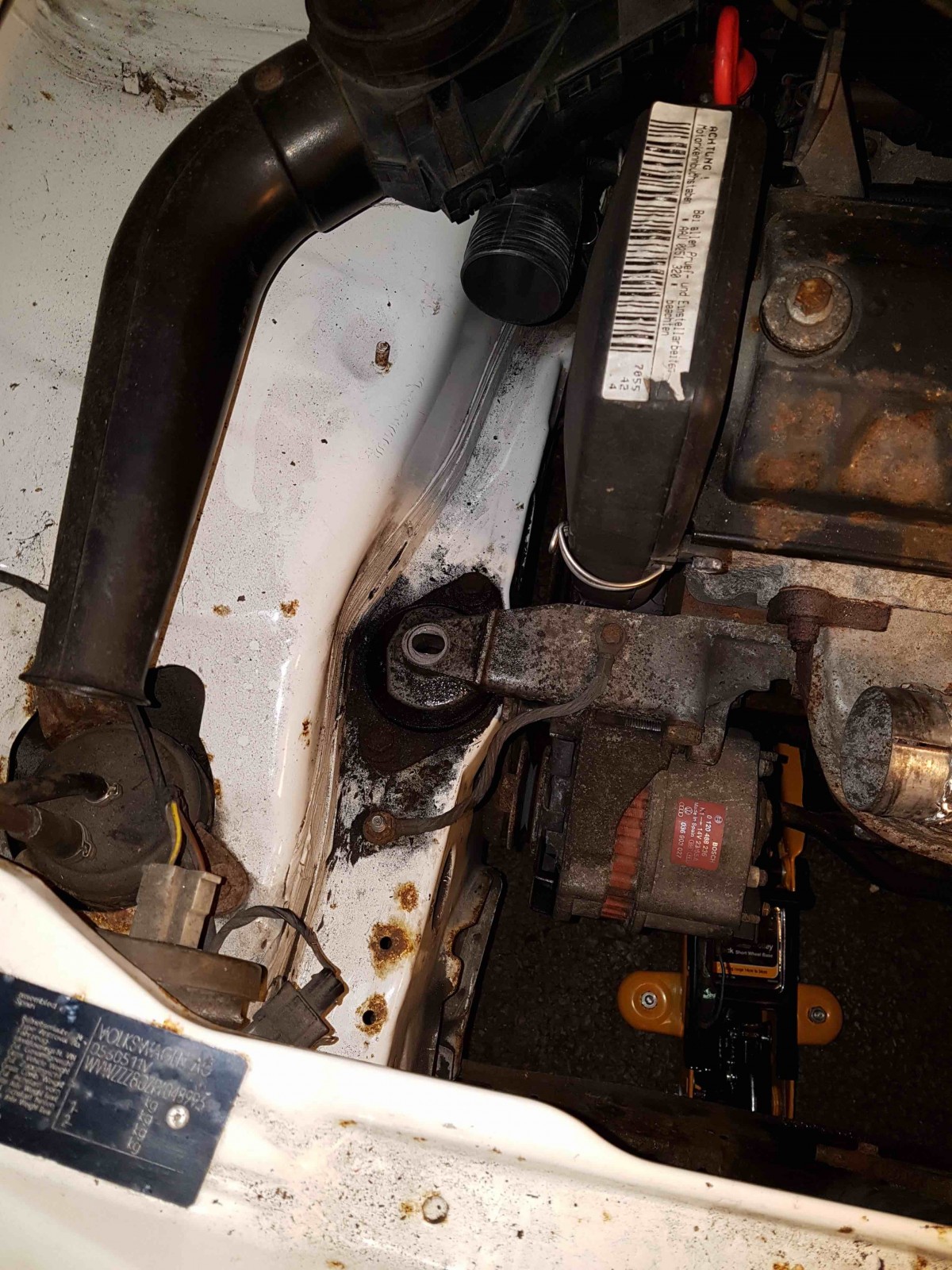

I've taken the engine bolt right out (picture attached) and stuck a piece of wood under the oil sump. As I started to jack the engine up, it picked up the weight of the entire front end of the car - tyres were still grounded. I used a smaller piece of wood, just in case, (picture attached) and it still lifted the entire car. I didn't want to risk collapsing the oil sump, so I let the car down rather than jacking it up further.

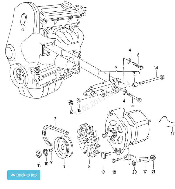

Looks like you''ve still got the mount bolted to the engine (bolts 5 and 6 in this diagram. You should be ok with them in though.
If you jack the engine, the mount (2) should go light on the rubber bush it leans on. Undo the two (rusty) bolts holding the mount onto the chassis leg then you should be able to jack the engine up enough to take the rubber bush out, and then slide the long bolt out of the alternator.
Alternatively, you can undo the mount from the engine and separate it and the alternator on the bench. Just make sure the bolts and holes are nice and clean so you don't wreck the threads on the engine when you put the bolts back in.
Thanks for all your advice. In the end, I just got my better half to put some weight down on that side of the body whilst the engine was jacked up. This managed to separate the mount from the body long enough to remove the bolt. I still needed to apply force to get the alternator out, it was wedged right in there.
