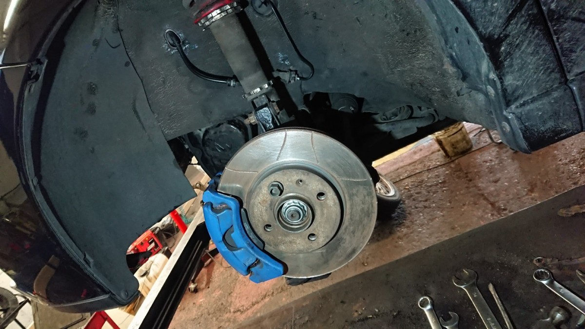

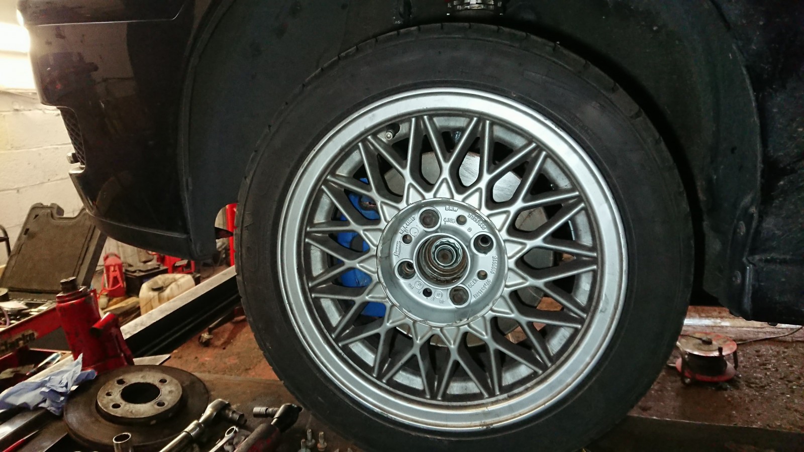

hey polo peeps!! I've fitted 6n2 GTI hubs onto my 6n2 1.4 8v and now the wheels are toed in massively !
the hole for the track rod end to go into is 10mm closer to the steering rack than the 1.4 hubs and I've now been 2 weeks without my only car trying to figure it out.  so far the only solution myself and the mechanic at the garage doing it while I'm at work have is to put threads further up the track rod and chop the ends off to make it fit but surely there's something were missing ? some part that needs changing???? I'm at a loss and I want my car back from what shouldve been a 20 minute job ?
anybhelo appreciated- we've checked ball joints, track rod ends, checking wishbones soon but everything seems to be the same !!!

cutting and tapping the track rods to fit - will.... this cause anything to go horrible wrong ? in the interest of saving time and getting back on the road quickly this may be my only option but I wouldn't know what to expect or what could bite me in the ass later - aside from having to re-do the track rods and hubs at a later date ?
the brakes from a known polo GTI fitted straight on and I've already put in new wheel bearings, abs sensors and the discs and everything lines up bar the steering assembly
That's the thing the Polo GTI used the same brakes as the mk2 Golf GTI 16v. That's what made me think you might have been given mk2 Golf hub carriers.
