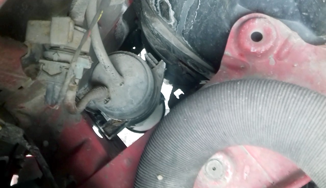

Is the canister under the right headlight a vacuum canister?
My car came with vacuum operated central locking, but that is long broken, could it pull air from one of those and then screw up the signal somehow?
Is this supposed to be connected to something? I'm thinking it should mirror the hose next to it, but there is no hose that same size in the engine bay.

Sorry don't have such a car to compare. Put a tube on it and hold tongue to a finger or cheek or tongue. If it sucks when you run engine there's a leak there.
Cut tube shorter, block with a bolt and jubilee clip.
Hard plastic tube to brake servo can be a leak spot.
Shaving foam will bubble. Or cold start spray (diethyl ether) can indicate where a leak is, as sucked into engine changes note but no good at max revs

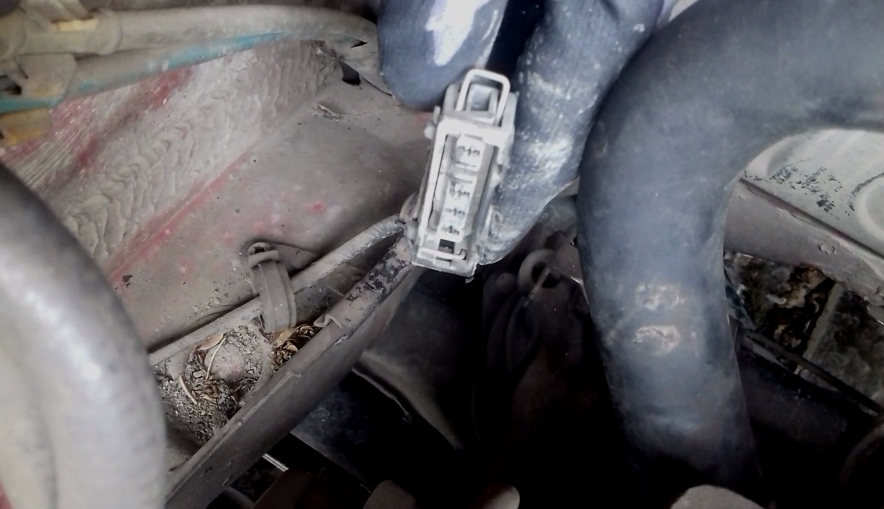

But I also found another thing loose, some sort of 4 pin connector, and it was going to a canister under the right headlight. From that canister it goes to the other (vacuum?) line next to the one I just mended. Another thicker wire goes up and underneath the windshield wipers (possibly to the ECU?).
The exhaust is the closest thing to the connector (where it was hanging), and I know somebody did a crap job welding up the exhaust, judging by the bad welds and the missing cat. I don't see a lambda probe anywhere, so could this be the missing part?
Haynes says that this is some sort of charcoal canister, related to emissions, should it be cleaned every now and then?

Yep, the canister absorbs petrol fumes from tank, and they are purged into running engine (by vacuum) when engine is hot enough.
On old cars the tank fumes were vented to atmosphere, so the north pole is now above freezing.
If it is injection engine (not carburettor) there should be a lambda probe, or it will run open loop warm-up phase or breakdown get-me-home mode.
So will run but badly.

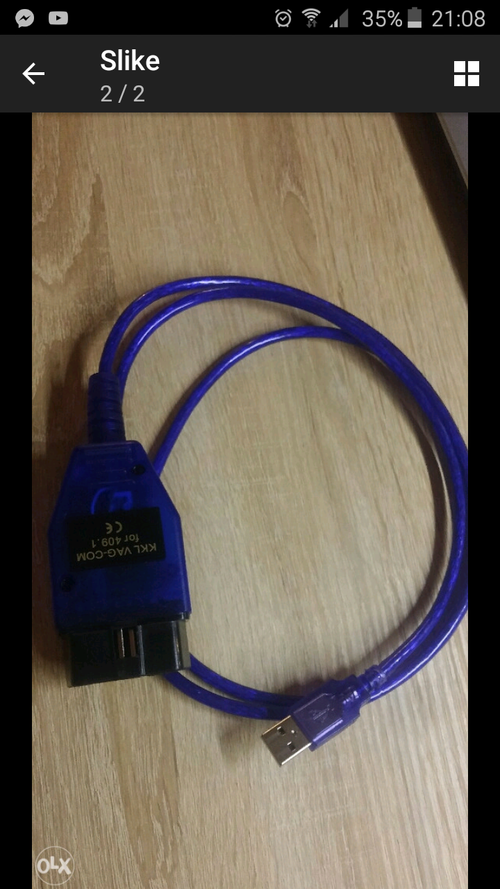

Would this cable work with VCDS? I saw a VCDS Android app aswell, have you tried using it Nige?
That cable is intended for the old version of vcds, vagcom 409.1 it will give you the fault codes and allow some adjustments like the throttle body alignment, not used any android versions just the VCDS on my WinXP laptop
