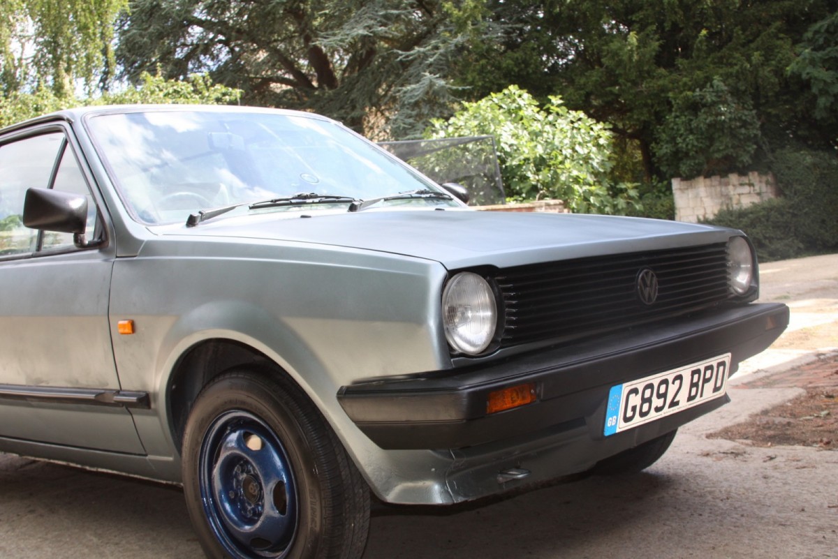

So I bought Birtha from a guy in Surrey without seeing her for very little. All I had to go on were a couple of videos and a phone call. After getting her trailered to Wiltshire I embarked on the long process of restoring her. The plan is to drive her from England to Portugal and back in April and May this year. I had very limited mechanical knowledge starting off (beyond working on tractors) so with my Hayne's manual and a lot of help from the forums (especially @dvderlm, with the pesky pierburg) I set out to get her running.
She arrived in Wiltshire not running and missing plates but chock full of spare parts (some of which have been useful). Cosmetically there was some rust on the sills, a ding on the front from hitting a bollard and a very "patina" roof.
A first look
My mate had a mk2f in his shed which he used to keep sheep feed in until the rats got to it so I figured I would have a fair number of spare parts to hand. This was a little naiive I admit.

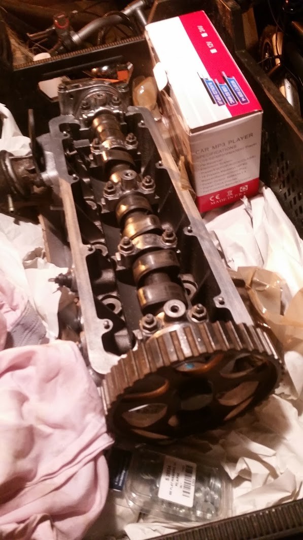

I was very paranoid about messing up the timing but with all your help I didn't mess it up too badly. I decided to do the water pump and belts too. This proved to make the job twice as hard because of the pesky plastic back cover. I couldn't for the life of me work out how to get the cover off so I took to it with the hacksaw. It's now much easier to get at the belt and mostly covered up.
A mate of my dad's runs a head reconditioning shop and did a full skim and rebuild for a couple of bottles (I tried to pay him but he wouldn't take it!). It came back absolutely spotless:
IMG_20171217_172747.jpg.aff1f5352227b2e1dbbaba317124f89d.jpg25593521_1713716372014459_1349816151_n.jpg.c47160bef03ddbfa953882d763fb414a.jpg

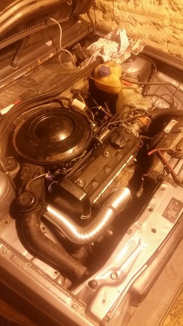

Managed to get it all back together, timed up (timing gun is my favourite toy, second only to colourtune) and idling (though still a bit high). After doing the discs, pads, ARB mounts, TCAs and rear wheel bearings I felt sure we were nearly ready to go. But then she sprung a leak. The radiator bottom hose had split. After another parts wild goose chase I replaced the hose with a flexi and all the jubilee clips someone had put on with new spring clips. I felt a little silly when I found a replacement bottom hose in one of the bags of parts the previous owner had left for me (it wasn't with the other hoses though :| ). I also replaced the thermostat housing and thermostat (which was non-existent when I opened it up, a clear red flag for head gasket going!)

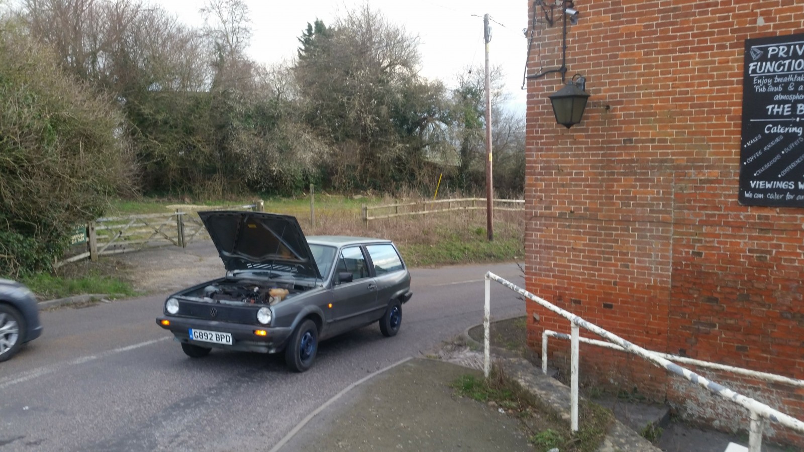

It developed a problem about half way to wales, idling out of gear caused the motor to cut out. Not good but I had to nurse her back to Wiltshire like that.
This was quite the saga. She broke down for ten minutes 5 miles from home, but I got her in. It turned out another carb bolt had sheared the thread out of the base rubber because the original bolts had different threads to the threads in the rubber. I was driving using the engine vacuum to keep the carb sucked down. Risky. I got a replacement and some new bolts. They went on perfectly and the seal was solid. I thought that solved the problem so I headed off to work. She wouldn't start at work for a bit but I managed to get it going and nurse it home all the way until the big hill with a junction at the top. At which point the car in front decided to stop and I stalled. She wouldn't start at all so I had to call the AA. While waiting it not only started to snow but the police stopped by and helped me push birtha up onto the flat. Big up the wiltshire feds:
Sadly the pub was no longer in service so I could only offer a handshake. Mr AA turned up and promptly turned my fuel filter around and chucked a load of grime into the carb. @dvderlm suggested it might be a blocked part load enrichment.
Turns out that at some point in servicing the carb I had replaced the gasket on the #13 plate spring bit:
And not put it back on the pin properly. The nub was rattling around in the cavity, blocking the hole when on a hill causing the car not to start. I cleaned the whole carb, replaced the fuel filter and replaced the low load enrichment unit as a whole from the old carb. The car drives perfectly now.

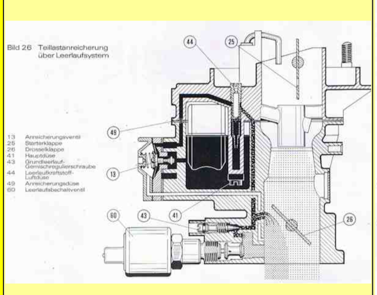

    Yeah, less oxygen high up there.  I've seen an altitude compensation chart - might be for motorbikes. Found it Mikuni. http://www.iwt.com.au/mikunicarb.htm   Bring back a Rover SD
