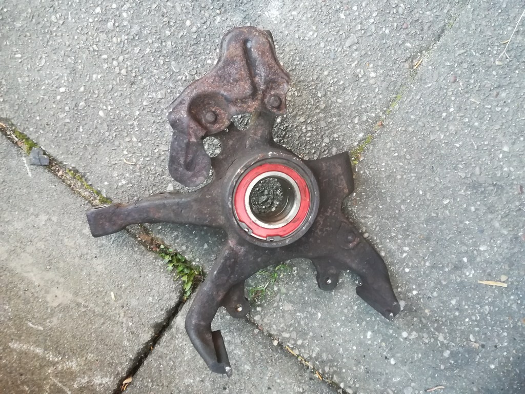

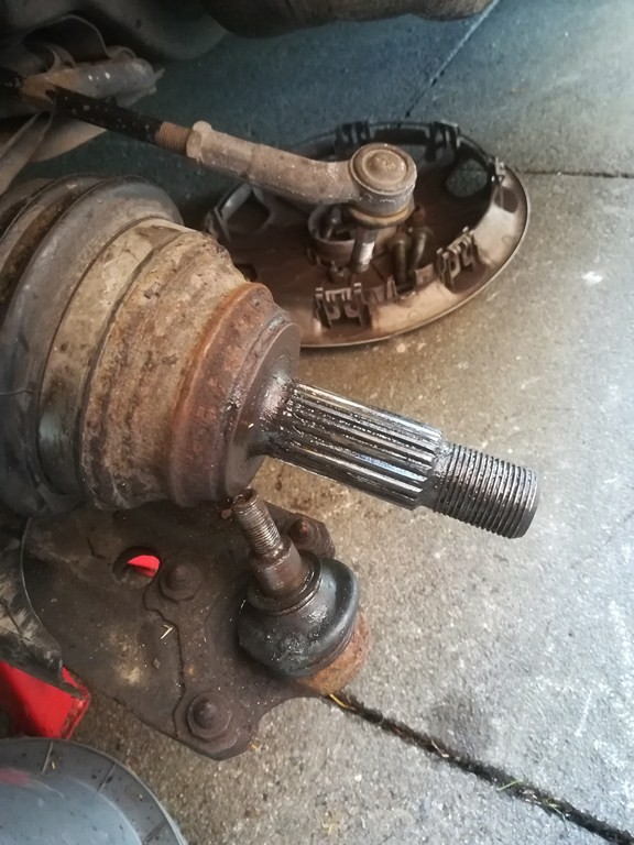

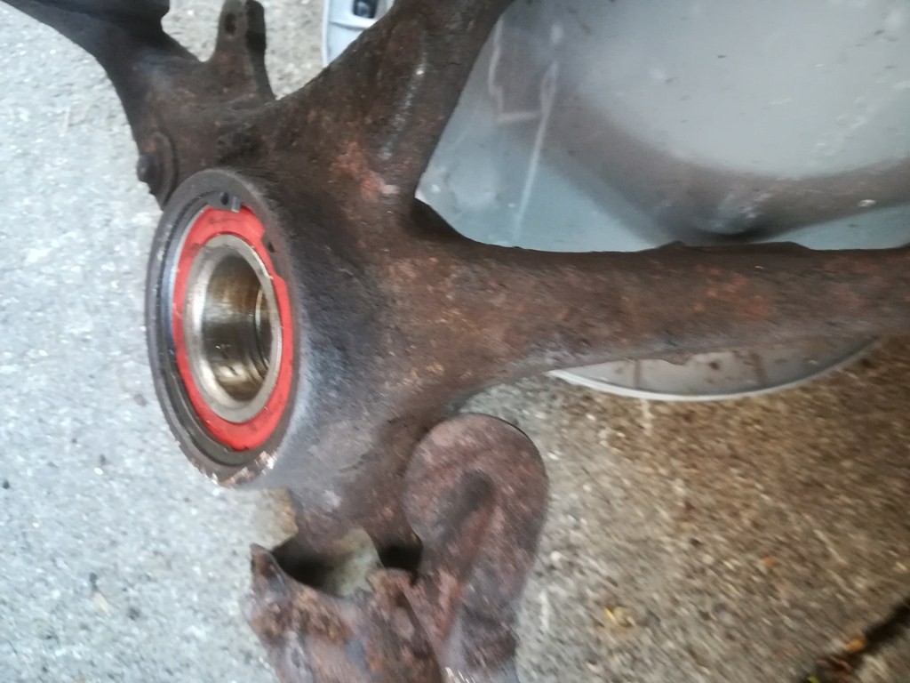

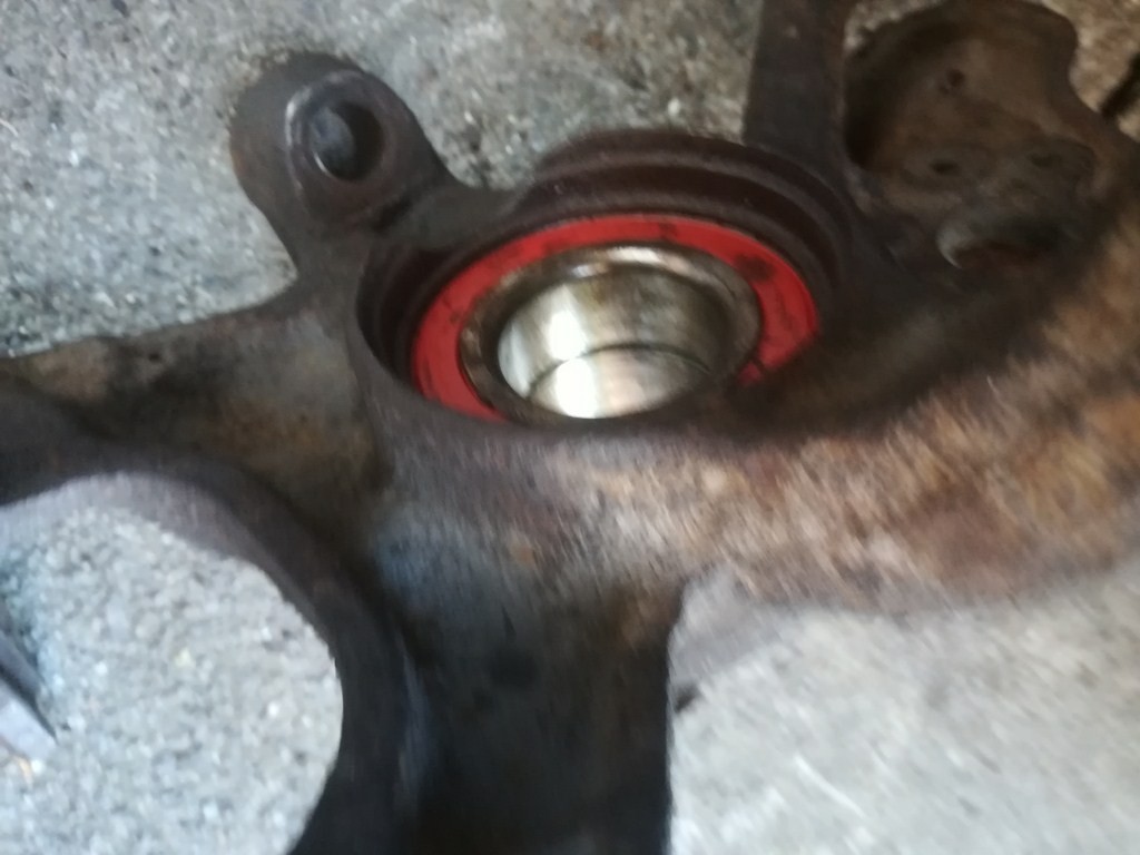

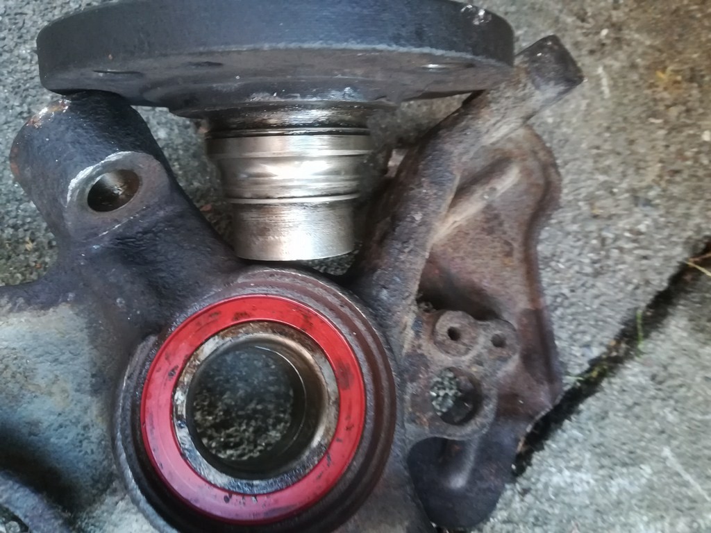

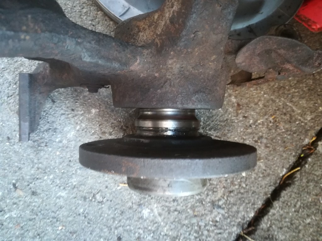

Anyway i can't seem to get the damn thing fitting back in correctly,so i have posted some  pics in the hope someone can guide me who has done it before,it shouldn't be that harder job really should it maybe it's just me and cars.
Right looking at the picks can you confirm that this sleeve on the hub is in the right place as the hub wont go back far enough on the splines to refit the nut up ,it's like it shouldn't be there,i was thinking that the bloke who pressed the bearing back has missed something off or something anyway he says he hasn't..So i'm open to suggestions please.
Please see pictures.

  • The "sleeve" on the hub is part of the old bearing and needs to be removed then the hub needs to be pressed into the carrier/bearing
  • No that is part of the old bearing it needs to be removed and put in the bin, then you will need your friendly garage to press the hub into the new bearing
  • Angle grinder but not all the way through then a cold chisel to crack it, then you should be able to remove it, or if you have oxyacetylene heat the sleeve up and you might be able to just lever it of
Thanks for reply Nige,yep thought as much so what you are saying the sleeve shouldn't be there,thing is i tried to install the hub onto the splines with the new bearing in place not realising that the sleeve should not be on there and it was hid with a piece of wood so it will be jammed into where it sits now.???Should that sleeve fit in the back of the bearing with possibly another bearing race fitted into the rear part.
Ok got you ,any ideas how remove that sleeve :D.The bearing kit i purchased came with two circlips and as you can see in the photo the front has been fitted ? silly question does the other one fit into the rear of the bearing or is it a spare.
Edited by mickypolo
Angle grinder but not all the way through then a cold chisel to crack it, then you should be able to remove it, or if you have oxyacetylene heat the sleeve up and you might be able to just lever it off
Right Nige thanks for your help on this ,think i've got an angle grinder lying about somewhere and a cold chisel come to that so will have a go tomorrow,thing is if i knacker it up it's bite the bullet and buy a new hub.
??/So the other circlip isn't needed at the back then.
