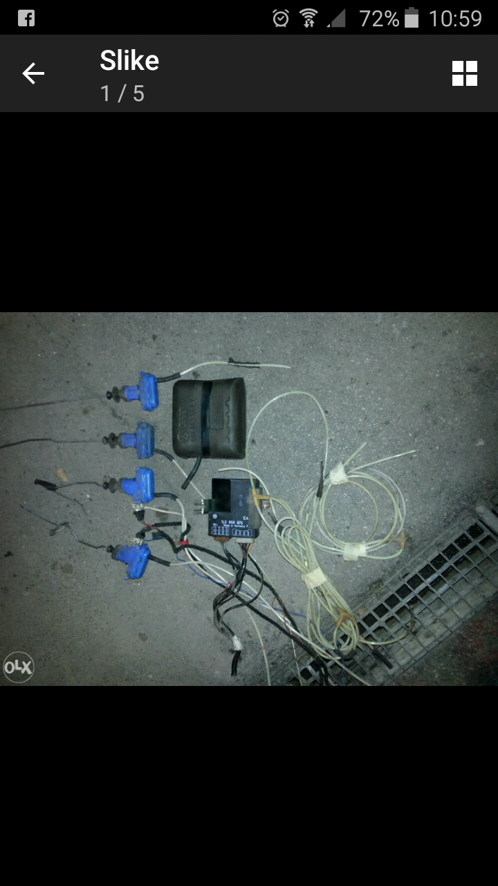

My car seemed to have pneumatic central locking in the past as my locks have pistons with vacuum hoses attached to them.
I will have to try and find where the pump and computer are located, pump in the boot and computer under the dashboard somewhere?
Maybe I can revive this system with some third party hardware.
There is also a second hand unit quite away from me, so if the system was completely ripped out for some reason, I could just reconnect all of the wiring. (And it is pretty cheap IMO)
Any help on the location of these things would be greatly appreciated!
Apparently one of the previous owners hated central locking and decided to rip everything out?
I could only find a hidden plastic piston under the fuel filler cap, and three colour coded wires on the other!
So I need to find a pump and a remote module to operate it. My doors have pneumatic locks with hoses going to them, so maybe I can make use of what VW already gave me, lucky me. I hope there are no leaks.
