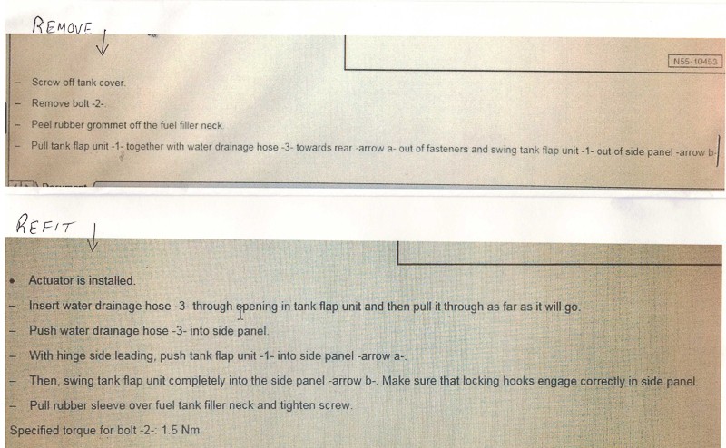

I have a problem with the petrol flap on my 2012 Polo 1.2, 3 Door.  The plastic bracket hinge is detached from the flap is this a common problem with the Polo?  Is there an easy fix solution?  Looking at the bracket and flap there are no signs of any attachment screws.  How is the flap and bracket removed?

Thank you so much for providing that excellent information,
