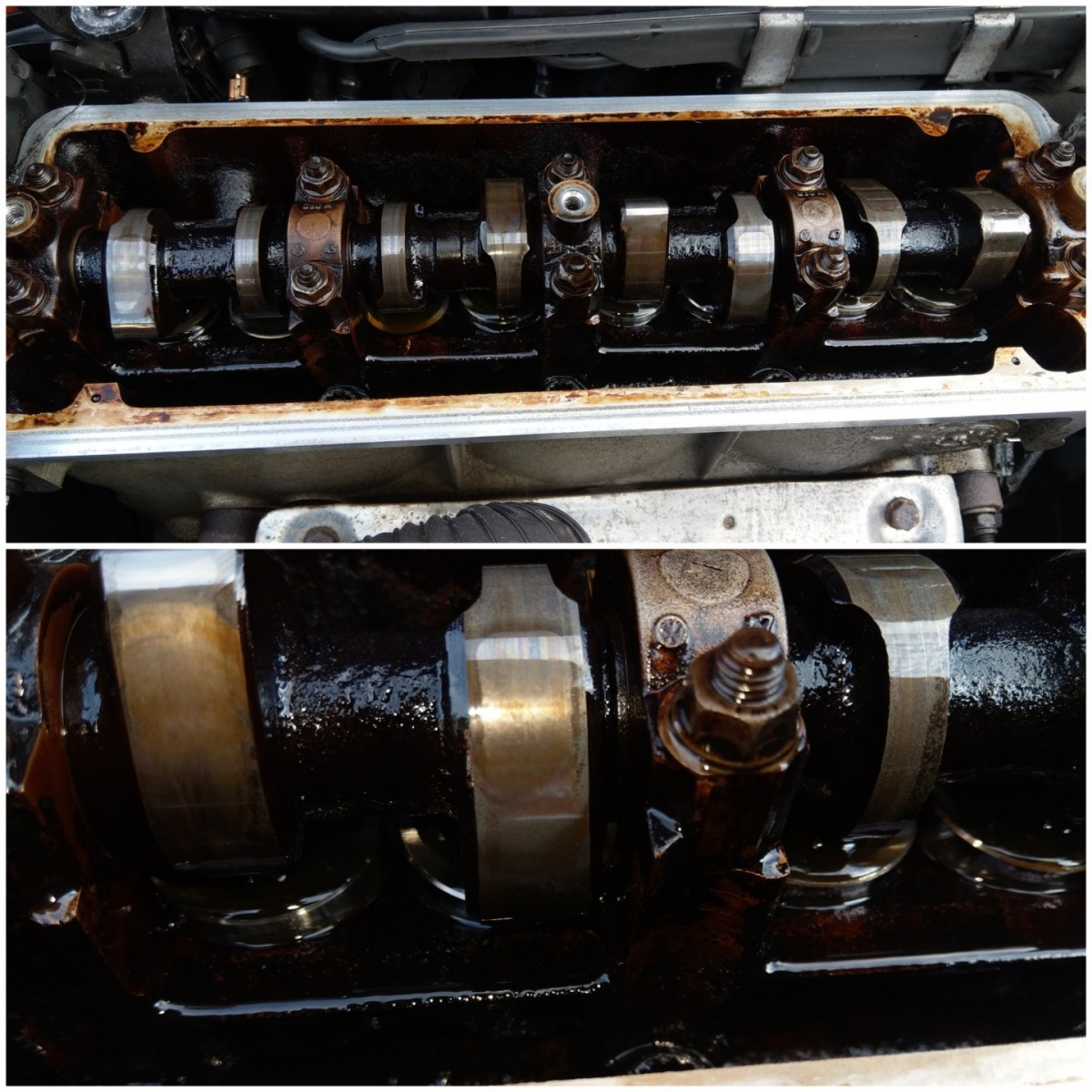

Took rocker cover off. Looks like oil coming through. Fresh new oil on tappets.
But one tappet was easily pushing down using finger, while others were not. Is that a sign of broken tappet? No sign of tappet damage from top. But this only solves the noisy tappet problem not the oil pressure one.

What engine code doe you have ? as that engine in the pictures is not one fitted to a 6N2 ??
I think i will not try doing it myself. But appreciate all the help and links you provided.
Well spotted, I was under the impression that my car being late 99 model is 6n2. In fact its 6N1 and engine code is AER. Never bothered to look at the sticker on service book. Car itself have many stickers at various places mentioning 6N2, thats y i thought its 6N2.

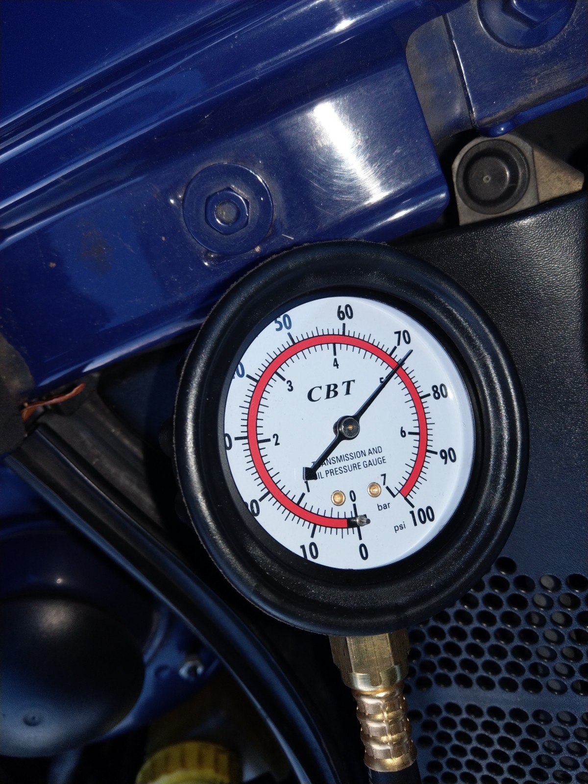

I have bought a pressure testing guage. What pressure values are normal?
Is 6N1 ecu easily replaceabale without any kind of coding? I can get one for £20 and replace myself.
Thanks.
I get around 3bar at 2500rpm - my engine and oil pump has done ~220,000 miles.
The VAG. sensors are usually speced to warn for below  0.3 bar at idle and 1.8bar  at 2000rom

Well tried the pressure test with no luck.
Initially got 5 bars at start and increased with revs. But engine cut off again after 10 mnts so could not test it for warm engine. But in those 10 mnts pressure dropped to 4 bars at the end and pressure clock started jumping between 3 and 4 bars just moments ago engine cut off.
Now will try again tomorrow morning. Tappets are less noisy but thats what they have been doing, sometimes will sound like they are dry as fk but then sometimes sounds like new.
I have specially bought a VAG diagnostic obd reader made specificaly for VW and likes of it. The first time i read codes it gave lambdar and basic engine settings. Cleared them but engine basic settings will come back after few days but lambdar never came back. Even right now after engine cut off tried but no codes at all. The code reader has the feature to adapt throttle body which i have done many times bit that has no effects on current problem.
Well done with gauge!
 Measurements with cold oil are not very useful. I get over 6bar with cold engine, but it drops as engine warms until its about 1 bar at idle when fully hot - about 5 miles driving in this weather.
Can you let it idle with bonnet closed tomorrow, restart when it cuts out?
Keep going until temp gauge nearer middle (90?) then see what you get.
Electric or mechanical/capillary device?
Yes i will try again tomorrow. I hope engine will last untill its warm enough for correct reading.
Once engine cuts off cant restart straight away, it would not. Only after few hours. Thats y i gave up today.
