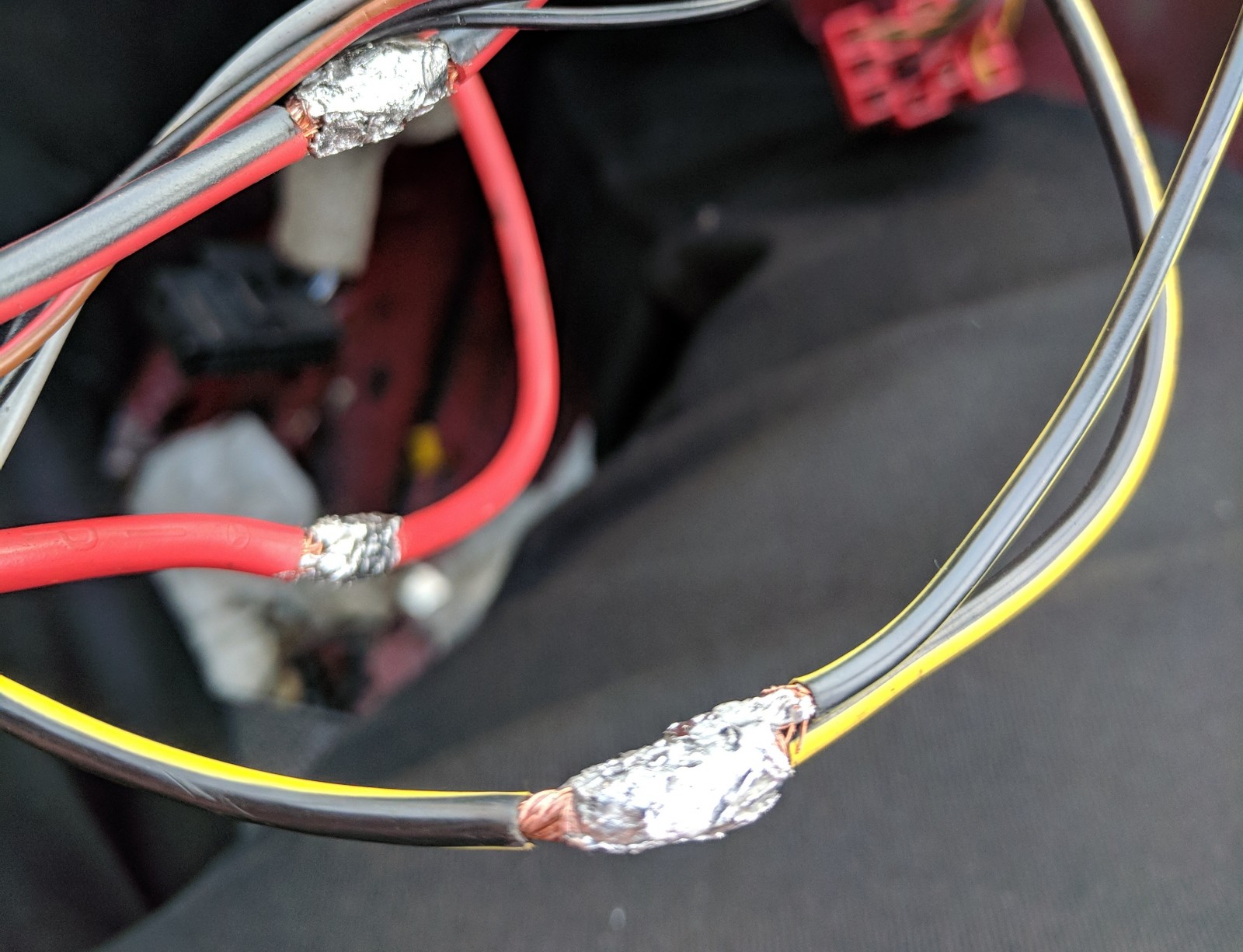

Has anyone got a good thread for installing a head unit on a mk2f as I can't seem to get my pioneer one to get any power iv bridged a wire from the ignition live (black and yellow wire) to the unit power and nothing happened.

Hi mate, have you got photos of the wiring your using , I had the similar problem but I had to repin 1 wire, might be able to help
Iv actually just sold my stereo to get another one but iv got a picture of my ignition wires. So that black and yellow one I was told is the ignition switchable live.
sorry mate i didnt get a notification. it should have been a plug and play to fit to th old connector with a iso plug, only difference is you have to repin the blue rem wire
