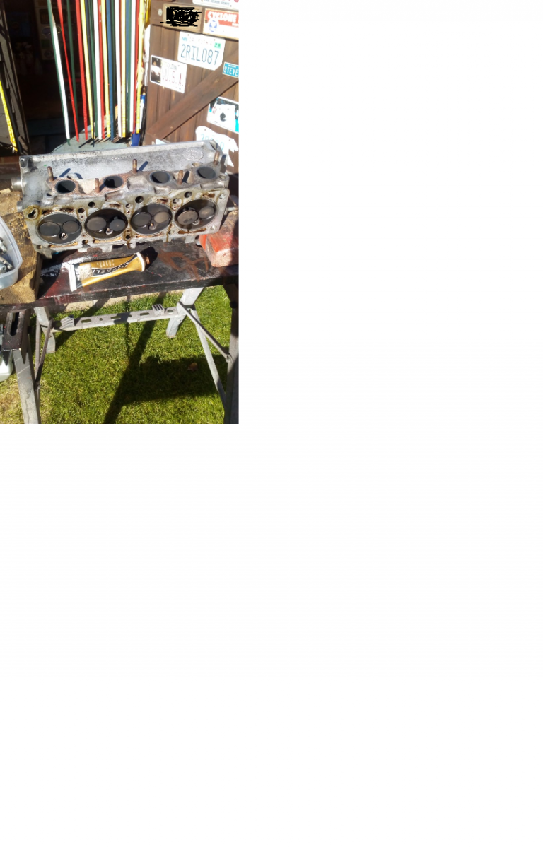

  • right - getting somewhere now    new /refurb head is on , confirmed it is the gt cam too   exh sounds smooth now with an untouched afm ...havent tested the emissions yet but should
