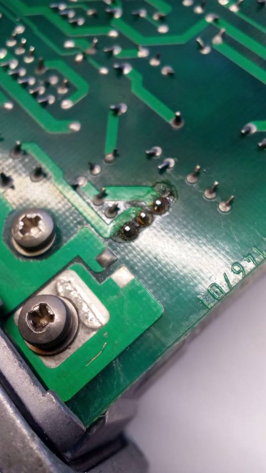

just opened up a spare ecu (runs same)   and noticed these look like theyve been hot
think its a voltage reg , theres one each side of the board
should i be replacing them or what lol
If they are regulators, not IGBT transistor ignition drivers.

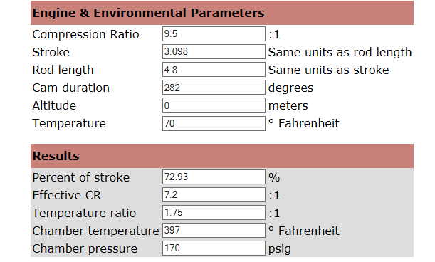

I chucked some figures in a cranking calculator and reached 174psi for 10.5:1 of ABD. (Not sure about rod length or ABDC inlet valve  closing)

I can get the 220psi of my best cylinder with the same calculator and values I'm reasonably sure about.

9.5-1 according to this

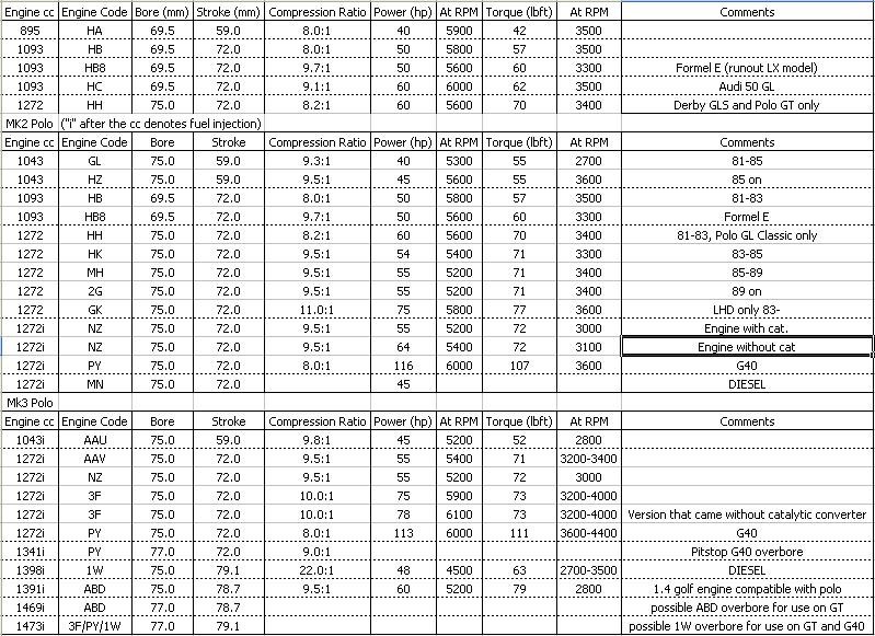

will try again with a warmed engine some time919376249_enginespec.jpg.0aa89e64242e2ace854d9b08d8333310.jpg
I found 10.5 on Wikipedia, lol
https://en.wikipedia.org/wiki/List_of_discontinued_Volkswagen_Group_petrol_engines
Yes, it's not awful. I'd prefer to see over 140psi and #4 is more than 10% below best cylinder, but for cold reading nothing there shouts bust.
