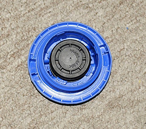

The pressure release valve that you are looking for is in the coolant filler cap, but these things tend to fail in the open position, preventing the system from pressurising. Quite often the only problem is that dirt has become trapped under the valve and is nothing that a good wash in water won't cure.

Regarding the cap (image). The pressure valve is the black thingy? If so, where does it vent out the pressure to? I couldn't find any hole/hose leading outside.

Air compresses. Water doesn't. That cap does not have a 9 digit VAG part number. I thought it would look like this, vents past threads
See the source image
Edited by dvderlm
It is probably a case of 'the camera never lies' - except when you want it to !
If you tilt your 'Verner' cap to the same angle as the genuine one (in dvderlm's picture) it will probably look the same.
If there is air in the heater matrix, it will not cause extra pressure, but would stop or reduce the the heater output and when eventually it works its way out of the matrix, it will be replaced in there by coolant, causing the level in the header tank to fall.
Pressure in the cooling system is derived solely from the coolant expanding when heated, this compresses the air in the space between the coolant level and the top of the header tank (reservoir). It is this air that is dumped when the pressure release valve opens - this valve also incorporates an anti-vacuum valve which allows air back into the header tank as the engine cools down, preventing a vacuum forming in there which could well allow atmospheric pressure to crush hoses or even the radiator core/heater matrix.
