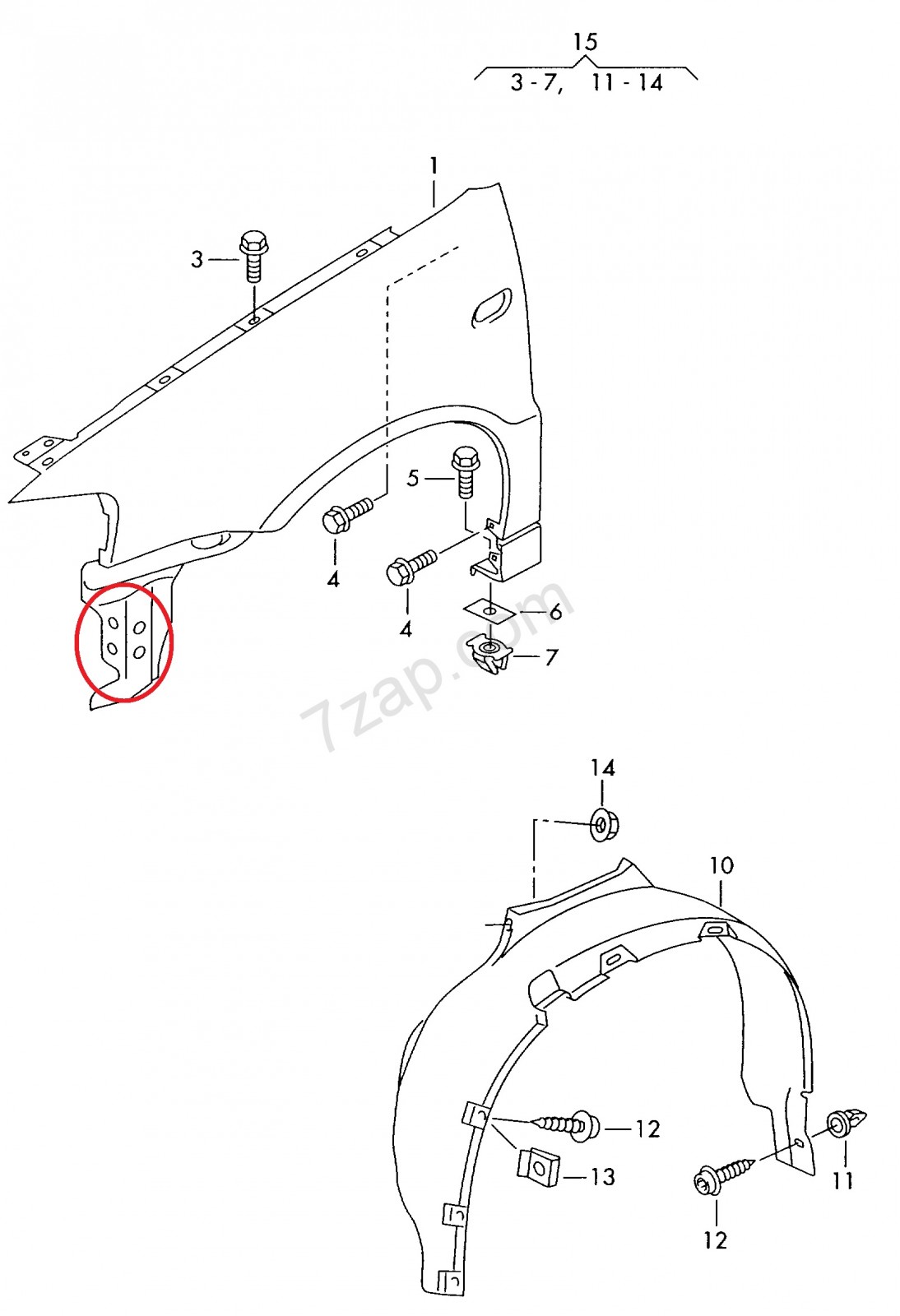

 https://volkswagen.7zap.com/en/rdw/polo+derby+vento-ind/po/2001-240/8/821-821010/#4

Just thought! Do I need to drop the bumper first or will it slide past? From the diagram, doesn't look like there are any fastenings behind the bumper section.
It's been a while since I removed a Polo wing but from memory without removing the bumper cover you will struggle to get at the bolts circled
Many thanks again nige! Didn't know if there were bolts there or not. I've had the bumper down before so should be ok.
