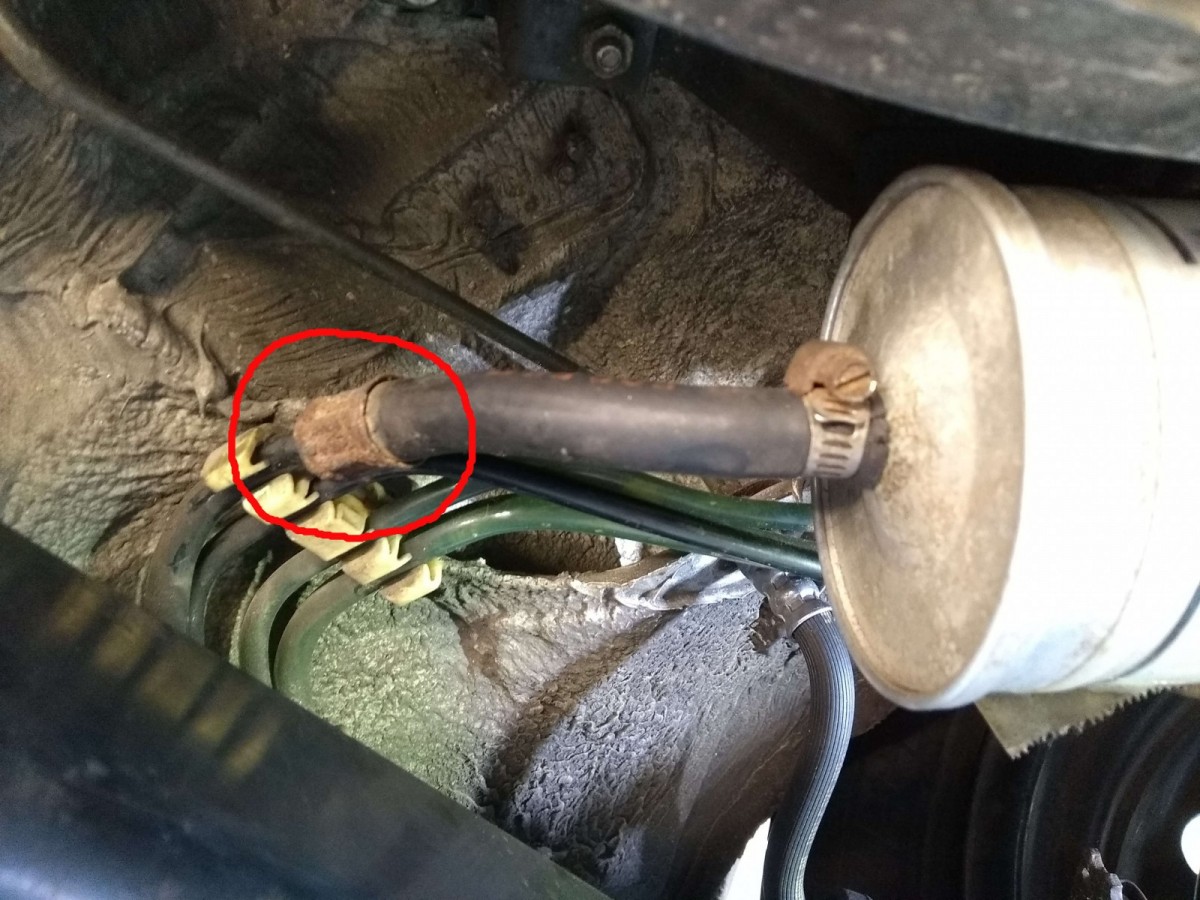

I need to change all rubber fuel hoses by removing the badly rusted compression fitting that connects the plastic (nylon) lines to the rubber hoses and using an oetiker-type clamp to connect the fuel line to the rubber hose (see red circle in photo as example of compression fitting used to connect plastic line to fuel hose),
however i wonder how to avoid kinking or crushing the plastic line when fitting the clamp: does someone know if there is a brass insert INSIDE the plastic line like the one in the second photo that I can reuse?

yes the have brass inside at the ends..i did all mine
carefully dremel the rusty bits off...theyre tougher than they look
i used stainless steel clamps like this as the crimp on ones wouldnt seal for me

i used the exact ones in my link...stainless beacuse i dont want them to rust , but non stainless works fine
all are good with no leaks ..no over tightening needed
