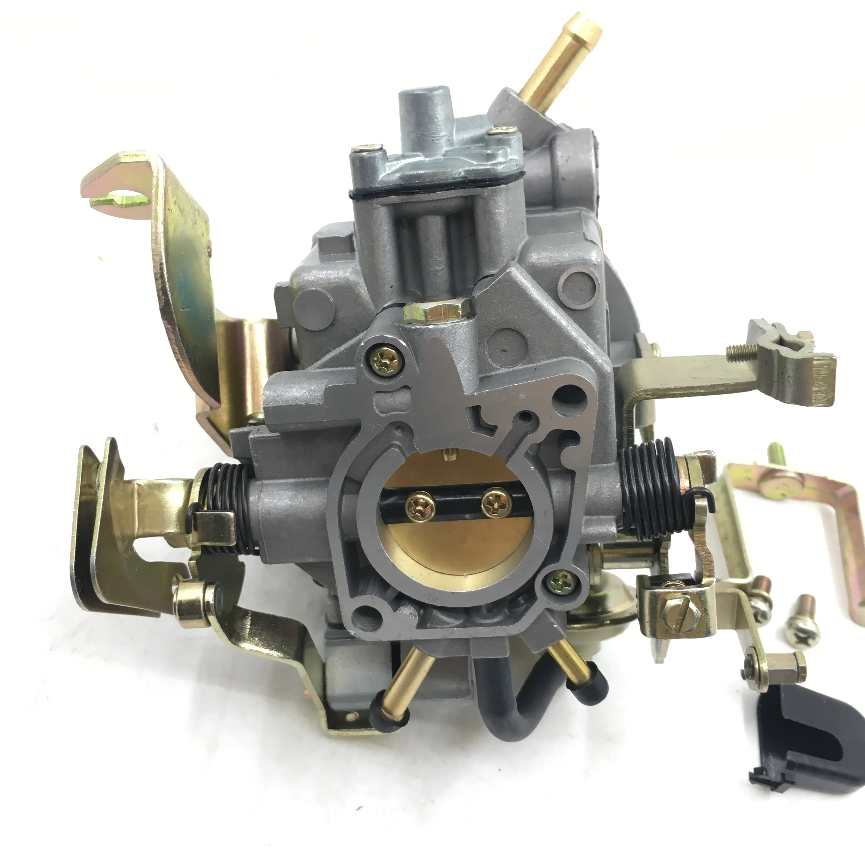

That sounds promising... So the Carb that’s currently on mine is a Weber 321BF. How would I find out if that will fit the “C”..?
Its underside should have this shape.
