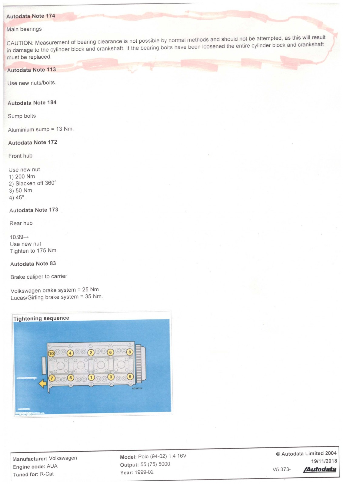

This the warning in the Autodata details for the AUA/AUB 1.4 16v fitted in the 6N2 & 9N1 also for the BBY/BBZ in the 9N1

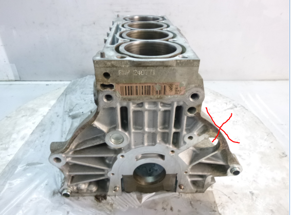

This is for Lupo Gti - due to the unique bolt pattern of the 6 speed box, I am looking at using a BKY block form a manual car, it looks like it has all the same bolt location except one marked below and also the starter is on the front of the block:
Engine block Seat Skoda VW Cordoba 6L Ibiza Fabia Polo 1,4 16V BKY EN301295
The BKY has the usual 76.5mm bore is there any chance VW were lazy and they have the same crank journal sizes as AVY? to make it 1.6?

That info from the Autodata is also in the dealers manual 😕

But that list shows 1.6 litre engines as well, every one is cast iron block  - think the alloy block crank case is too small for the throw of the crank
