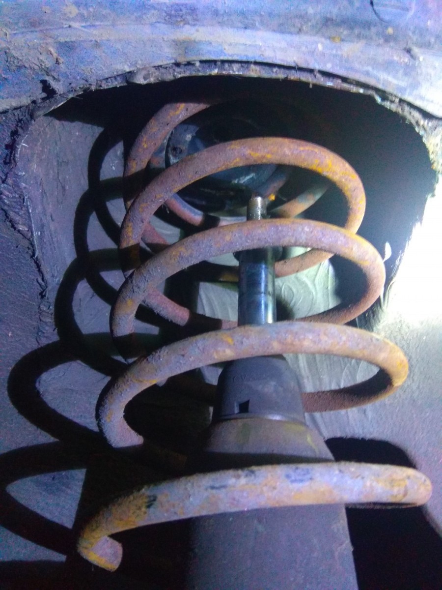

So the polo failed it's MOT on a wobbly top mount. I ordered the bits and got hold of some spring compressors. I read in another thread that once the top nuts are off you can jack the car up and the bolt should fall, which it did. The problem now is how to remove the old top mount bushing, it looks like the spring is still pushing up against the bush despite the bolt falling by about 12 cm.

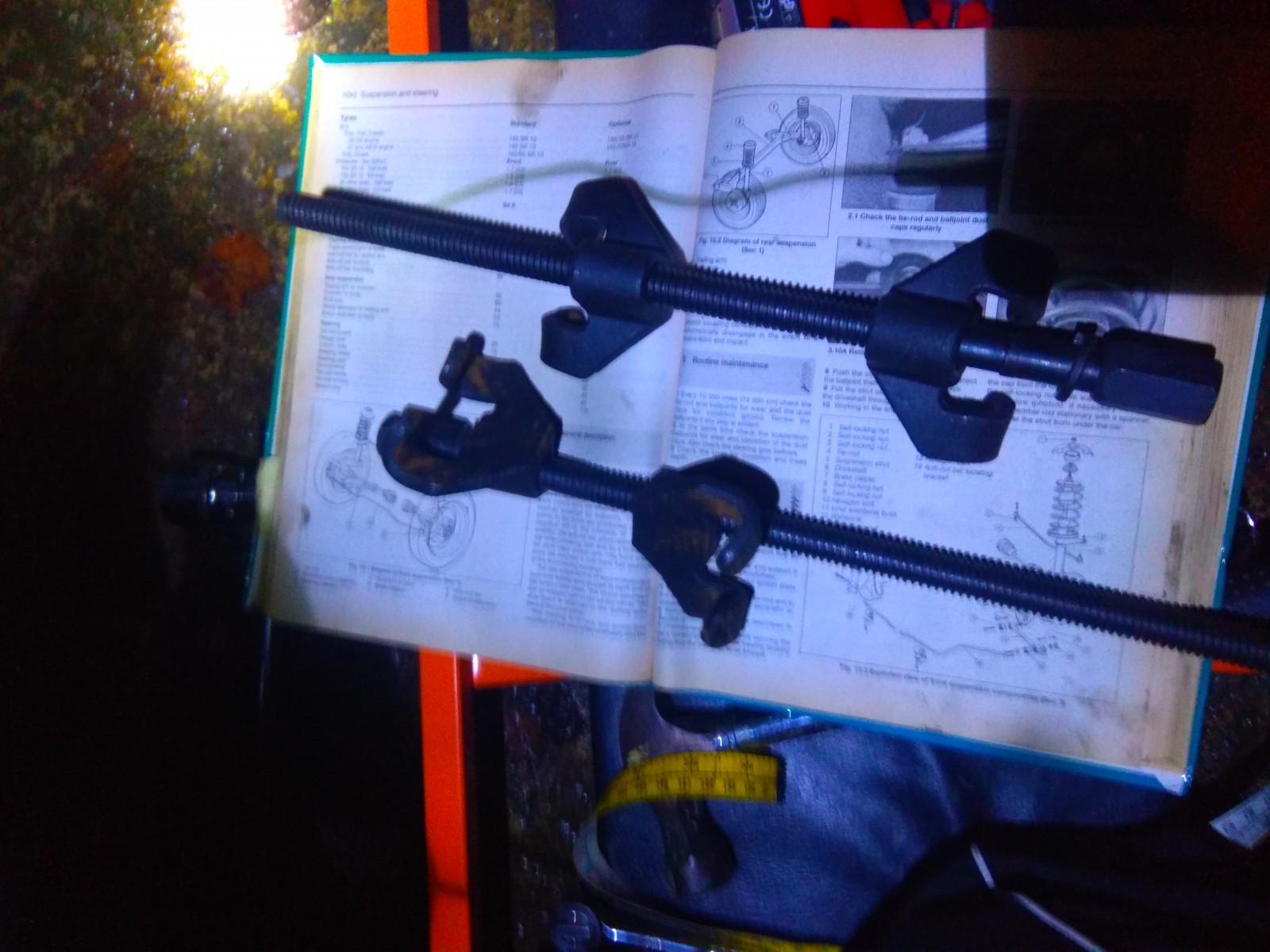

The spring compressors I have are about 40cm long, threaded one end and have a socket hole on the other. They're the 2 claw clamps. The only way I can see it working is if the bit you turn, the socket end, is pointing up. Otherwise the threaded bit hits the roof of the wheel well without the jaws doing the compression.
I would try to just take the whole strut off but I now cannot get the hub nut off as the car is in the air and I've got not impact wrench, I can't put it on the ground because I can't get the shock bolt back up into the right hole without the spring compressors which I cannot get to work.
Am I missing something stupidly obvious with how to use these ruddy spring compressors?  Do I just need to get shorter ones? Does anyone have advice for doing the top mounts without removing the struts, the Haynes isn't hugely helpful. I'll attach some pics

whats the problem with the compressors?
adjust them by hand so they span the most coils possible ,fit the hooks over the spring and crank the nut to compress the spring , be carefull using em and keep your fingers and face away as they can slip off

The nut end of the compressor seems to only go in up into the wheel well, so I can't get up to tighten it with a spanner.
I might be being thick, but these compressors have a threaded end ----clamp with threads------ clamp without threads that can slide up and down----- nut end for tightening.
Am I using them right? Or do I need to swap round the clamp order
cant really advise without being there ...either have the nut at the top if you can get to it , so the thread comes out the bottom , or nut at the bottom if theres room for the thread to poke out the top...might take a couple of tries to get it working
Bingo! Went to Screwfix to look at the size of the compressors they had in stock, bought a pair that was probably 2/3 the size! They worked a treat the right way up, I cranked the spring down then pried the old bearing out. The new one is now in place!
Having trouble getting the shock bolt to align with the bearing hole now. I still have the spring compressed as I thought that would make things easier. Jacking up under the control arm makes the bolt rise up but not aligned with the hole, I don't have enough strength to pull the inner strut to get it to align while also jacking up.

Those original spring compressors look big enough for a Range Rover 🤣

I have same spring compressors and I have done at least 8 sets of mk2f  springs now and never had any problem with them.
In the end I realised the shock absorber had a lot more travel in it, so I fed some string down through the mounting hole and tied it round the shock thread. Gentle but constant pulling on that string allowed the shock to extend enough (this is with the spring compressed mind) to be cajoled into the mount just enough to get the castle nut on a couple of threads. Then a combination of jacking and wiggling got the rest of the thread in. Yay for lateral thinking!
Yeah those original compressors were HUGE. Lesson learned, don't borrow tools for a job you've never done from a mate that's never used the tool.
