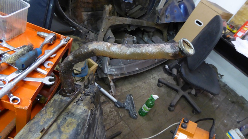

  • My fuel filler was in a very sad state.  And since jokes with gasoline are bad, and there were about half of it in the tank, I restored the pipe with epoxy and fiberglass. That's what I got.

My fuel filler was in a very sad state.abff549s-960.thumb.jpg.c1f637cb6db769d50f5c456289a17ed3.jpg
Light spots are the absence of metal.

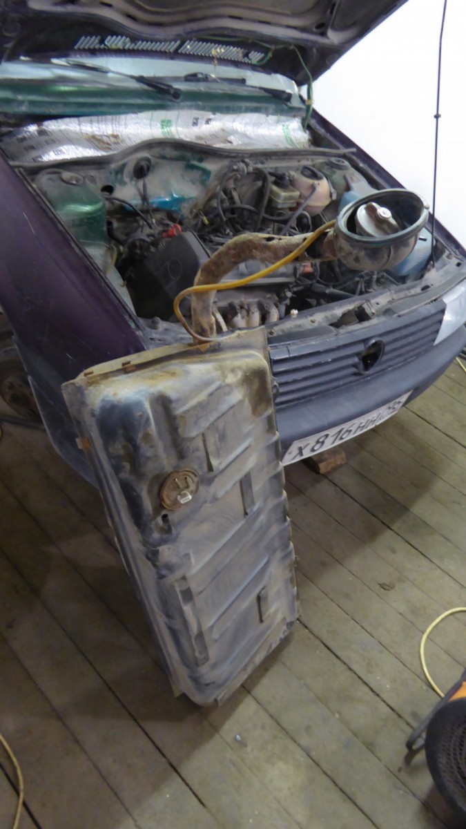

I apologize for my English, I don't know it well, but I decided to join your forum, we do not have forums on polo mk.2
Hows that stuff stand up to petrol?
Good work. I did mine while still in the car.
Russian winter means lots of road salt.
From your picture I should check the opposite side of the neck to the rear wheel also.

19 hours ago, kiran_182 said:
This stuff is resistant to gasoline and plus does not rust like iron

It was a temporary solution.
This is a piece of building insulation.
These photos are 2 years old

I'll put your build thread into Google translate for more recent info. Your English is better than my Russian.
На здоровье
На здоровье
Thanks for my English, but I check myself through a translator)))
I did not quite understand the meaning of the phrase - "Build Thread", and therefore I intuitively entered there a link to my logbook from the Russian community of cars and people, I hope I did not break any rules))

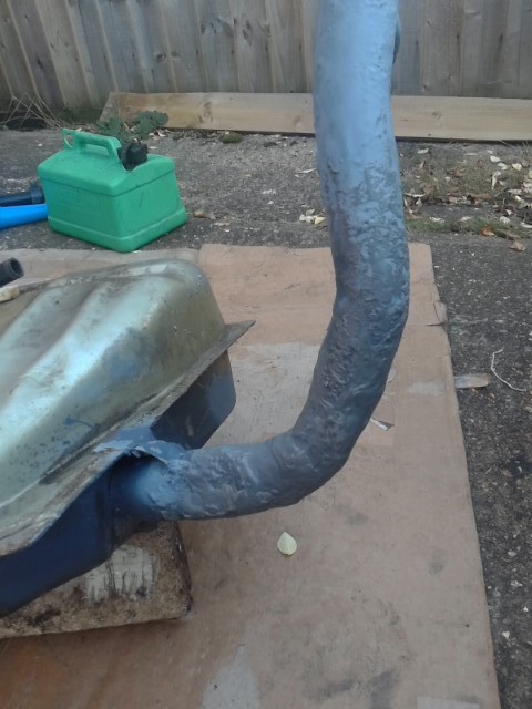

Five pin holes, half a pack of petro putty and 3 layers of JB Weld later...
I also took the chance to bend the neck forwards as it was not central behind filler cap.
Hope I have not overdone the correction.
and tank is back in the car with stainless clips holding that tube.

why didnt you invest in a new tank?
No time to prep and paint it.
Also only £15 for tube and clips versus £60.50 for new tank.
The flexi tube means filler neck is finally central in tank flap hole after 9 years.
It is (9 year old ) 42l that replaced a 36l tank and needed a little surgery.
Only the tube corner was pinholed.
