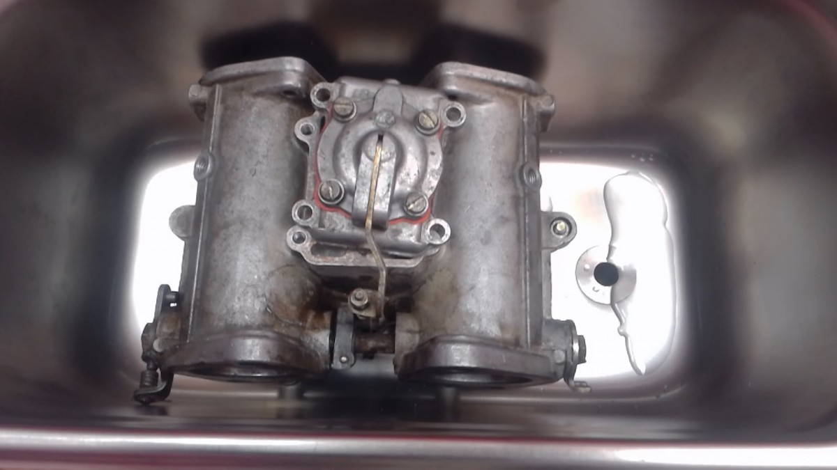

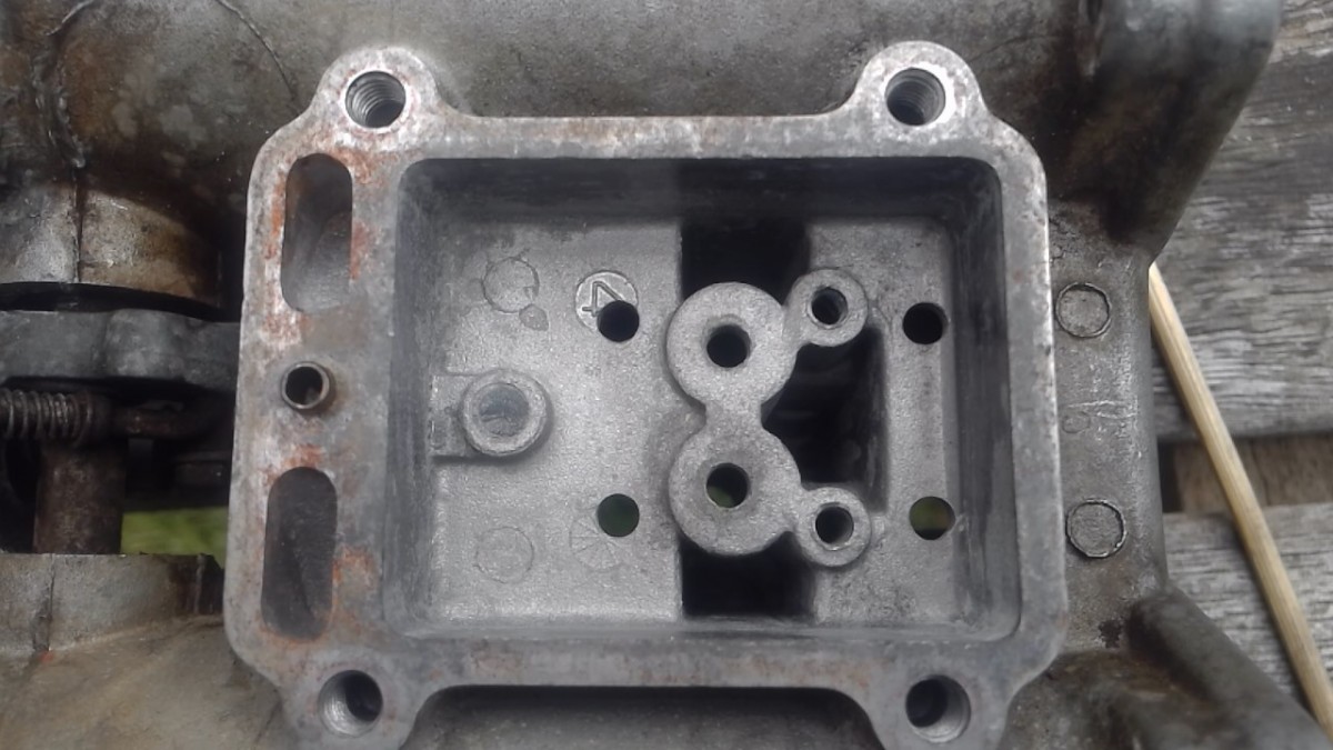

Cleaned all the carb passageways with carb cleaner and compressed air. Checked tank could breathe. Checked fuel in carb. Checked ignition wiring and spark plug cables. Checked for spark with a spare plug -it sparks. Tried the old Dignition unit just in case I had disturbed something. Tried some cold start spray and got a few exhaust  bangs.

Well yes. The plugs were fouled. But I only drained and refilled the fuel tank, replaced a x-relief relay, mended a foglight.
So it was odd that it would not restart after a few months. End of November it drove to MOT, did not fail for emission, drove home fine.
The starter circuit (DHLA) is calibrated right for richness and normally works. No evidence it is stuck on.

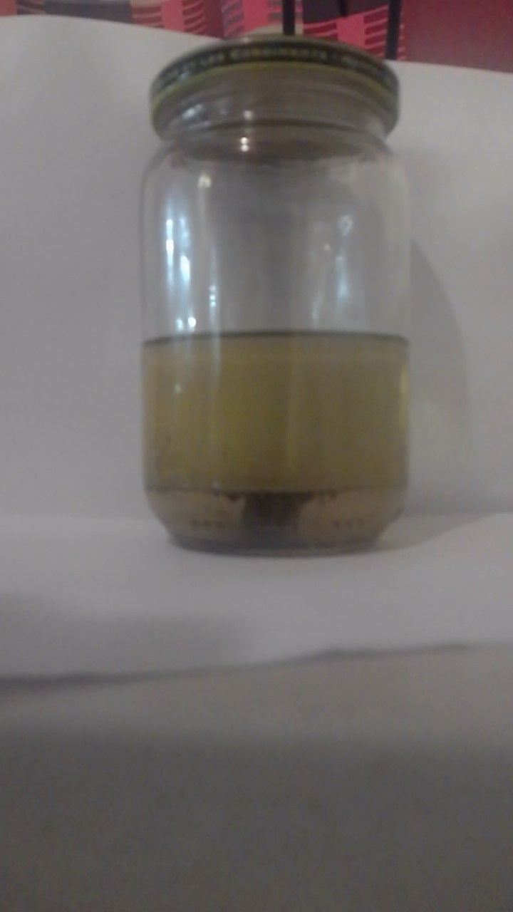

Drained the new massive filter and found...
water? and some more dirt in the fuel.
I assume rain dripped in the filler neck holes.
Also the fuel on top is slightly yellow, but petrol is normally clear?
Phase separated Momentum99 which has ethanol for the extra octane?
(surely not 1:4 ratio)
Might draw off the bottom layer and see if it burns.
Yellow tinge is normal. It could be water at the bottom, I doubt its ethanol would separate like that -  it would doing that in the tank at tesco,
Is the filter at an angle - it could be it was just collected at the outlet with mostly water going into the fuel line creating the bad running. suspect you need to drain the tank down to make sure no more water is in there - how is it getting in??
Bad tank breather can be diagnosed when you take the cap off - it hisses as air gets let in, Carbs are more effected than injection as the pump isn't as strong -try one of those emergency fuel tank caps -they are so awful they don't create an airtight seal, if your problem goes away its breather:

It was water below.
Siphoned off the petrol from above.
Poured it back in the tank. No hiss when opened the petrol cap.
Think some dirt must have been in the tube from tank to filter and some water in the tank from filler neck pinholes before repair . Even inverted tank does not drain completely because pick up tubes and breather tubes and fill neck tube all protrude inside. Didn't want to remove level sender as would need new o-ring and the white plastic looks like it may be too brittle to open by unscrewing with crossed screwdrivers.

Still lean, so cleaned the vacuum take off tubes, and lastly the 4 mixture screws, which were a bit grubby, and blasted those  with carb cleaner and keyboard duster spray.
Must be the smallest hole with strongest suction when close the throttle.

Recleaned number 1's carb idle passages with carb cleaner and compressed air backwards from progression hole cover to removed idle jet. Double checked the idle jet and its holder. No emulsified fuel blockage.
