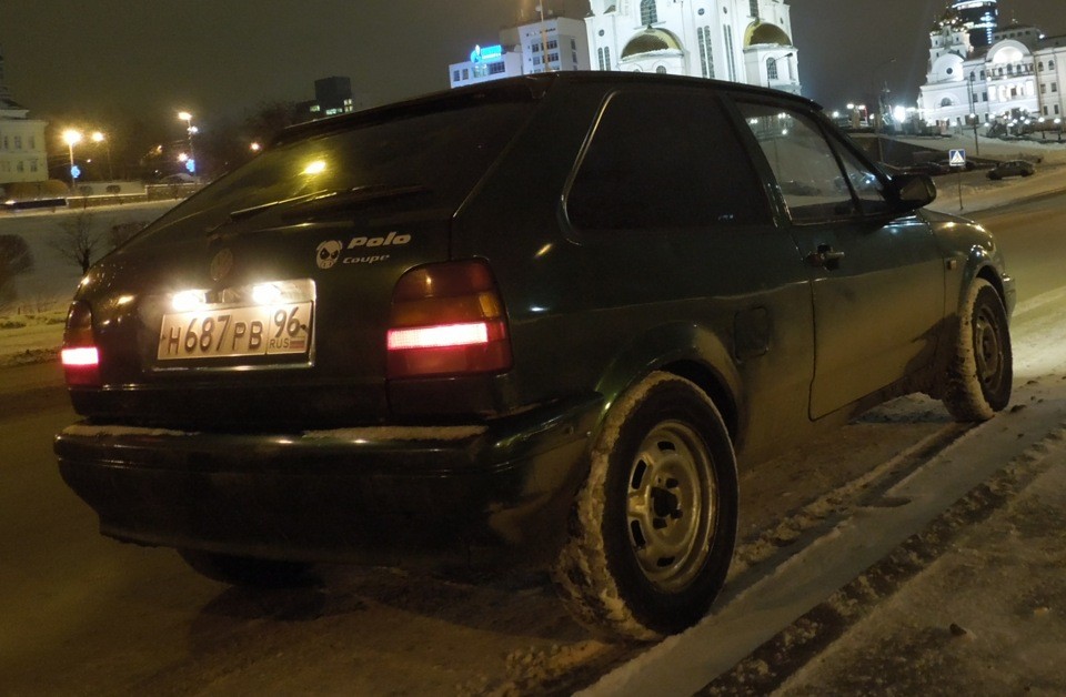

   1992 release, engine AAV, coupe, well, or a hatchback, 4-speed gearbox.
 I bought it in 2013, it has a lot that worked badly, there was a lot of putty on the body, but I was happy to move from car with carburetor on car with injector, I was most attracted by the work of the engine, it worked like a clock even at an air temperature of -30°C, and I was not scared by the puffed putty on the body.
First of all, the technical part was brought to an acceptable condition and it became my daily car.

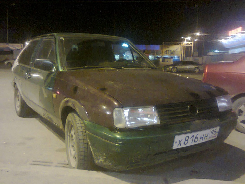

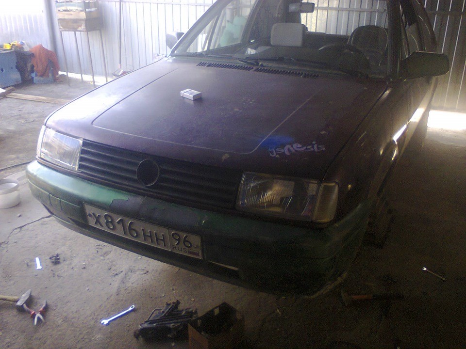

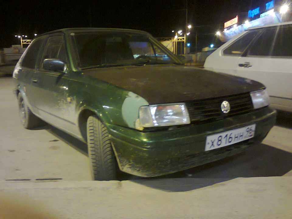

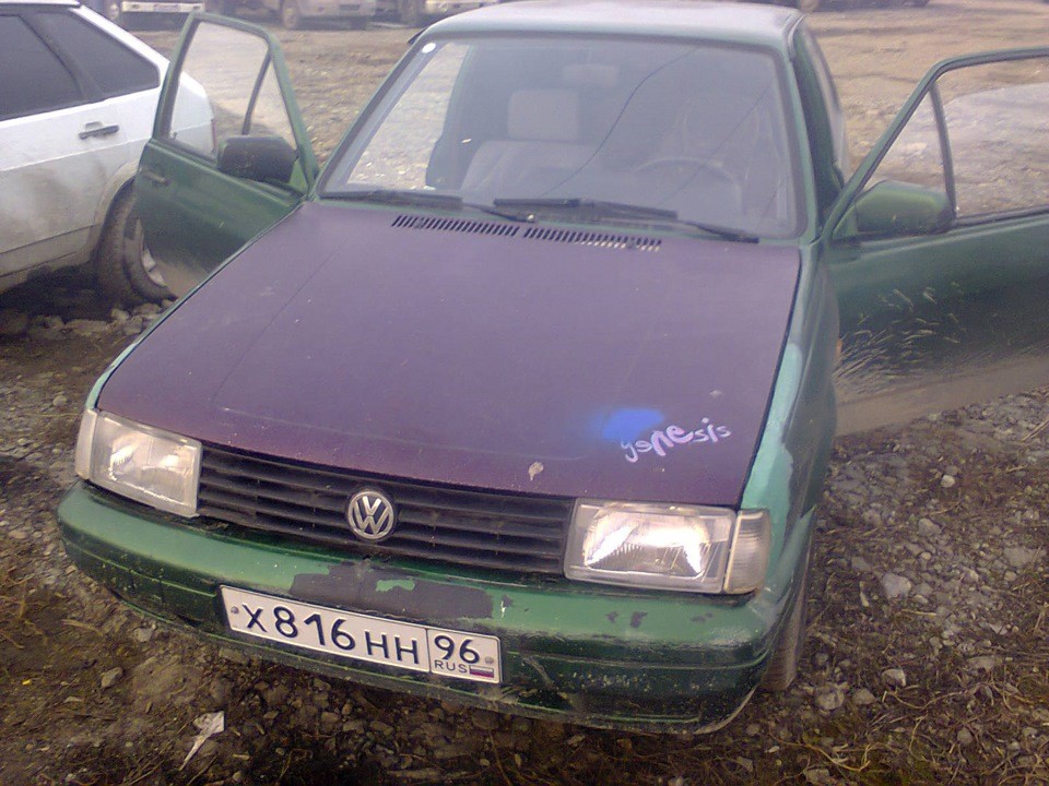

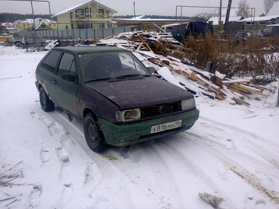

Here is a photo of how it looked after the purchase:
It looks pretty good on the back, but the front look was not as whole as I thought...

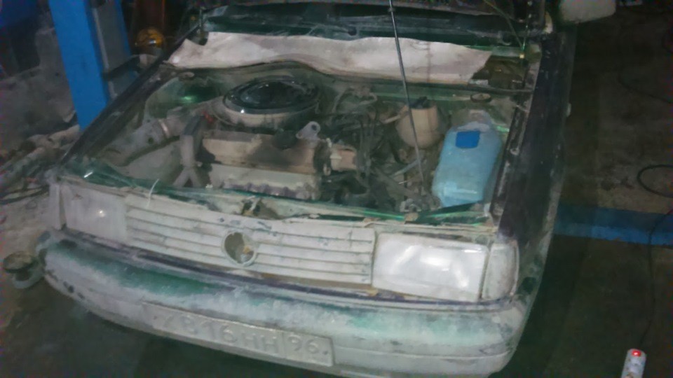

As it turned out - this body was in an accident, there was a head-on collision, and the left spar was curved, and the hood with front fenders needed to be replaced.

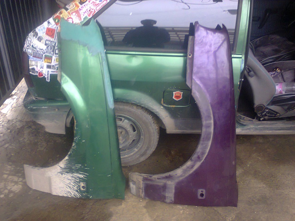

Some time later, I managed to find the front fenders and hood in excellent condition.
I don’t have a photo with an old hood, but there is a photo with old fenders and a new hood:
Then I replaced the front fenders, and also installed the missing part of the front panel:456b818s-960.jpg.01e70c46cb601b0fc953af6a190927b1.jpg

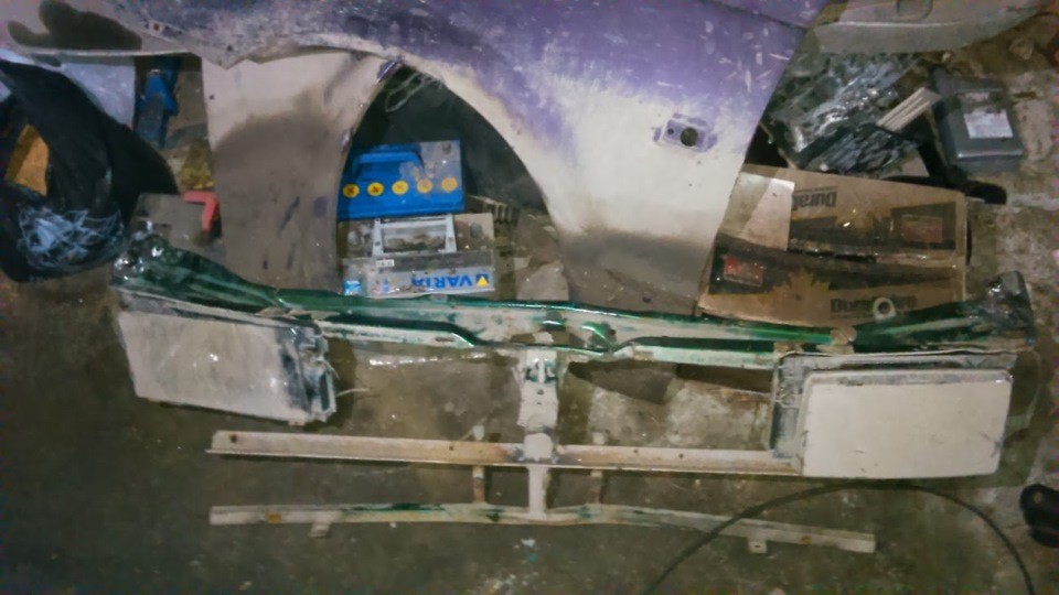

He lived with me in this config until 2015, then I had an accident, because of the lack of a bumper amplifier, all my work was destroyed.

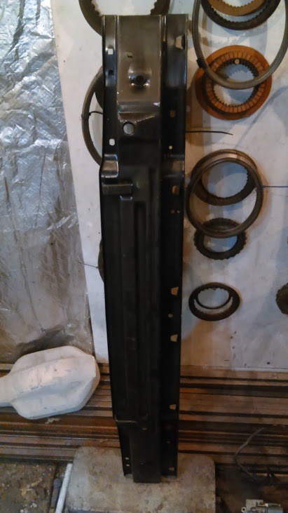

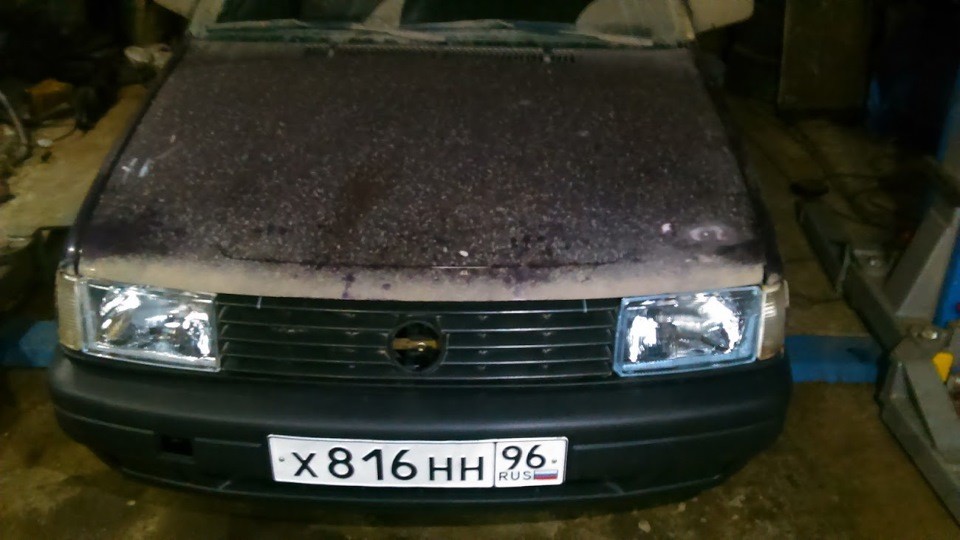

After that, I ordered new body parts: bumper, bumper amplifier, front panel and grille with headlights.
I decided to complete the work before the new year (it was in December)

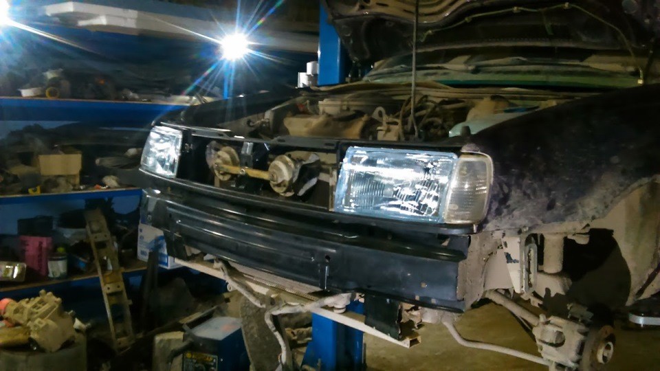

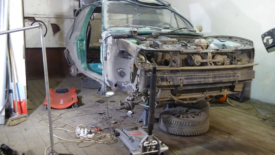

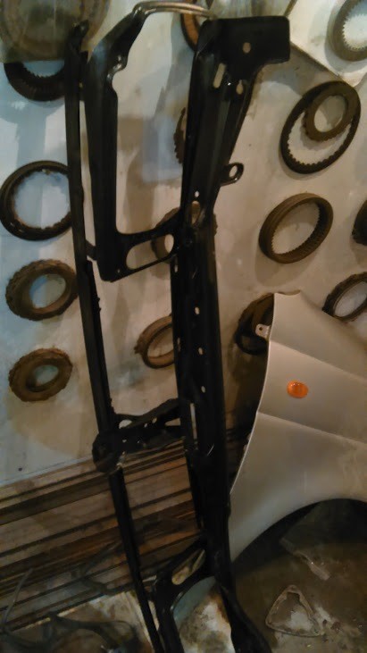

Here I got to the front panel:

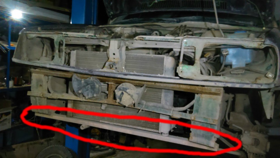

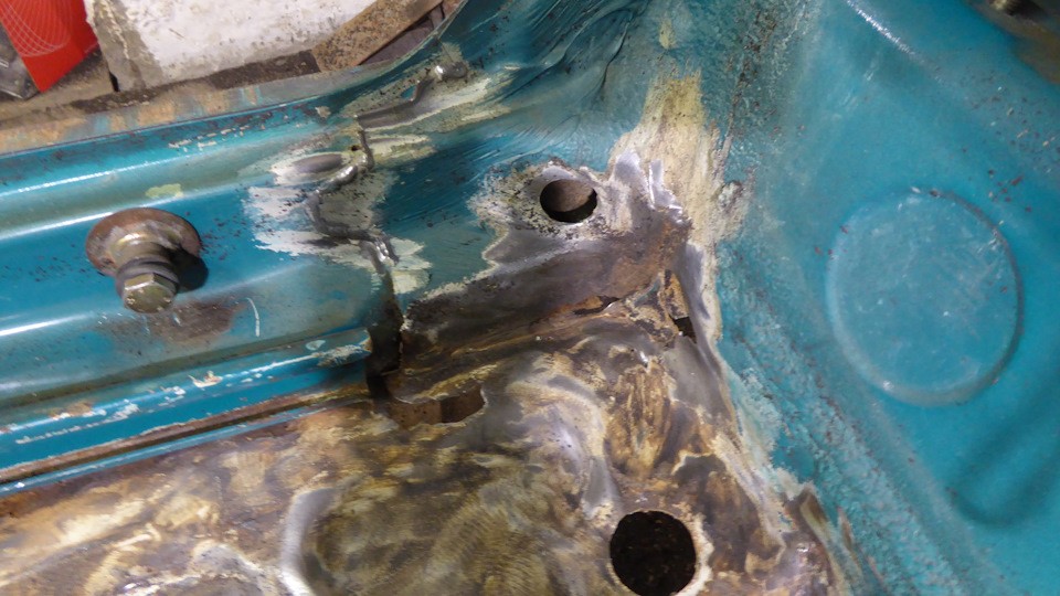

Instead of a normal amp bumper was bolted unknown origin design. All of this has naturally been removed from the body:39f9f5as-960.jpg.c5f99bfe10f56044b3796811b234a14b.jpg
All new parts were installed in place without difficulty.
I don't know how you call the front panel, but we call it TV:
And everything is in order...

We call it a front pannel, the bumper part is a cross member, should have been fitted as standard
Oh thank you very much, now I will know how this part is called correctly.

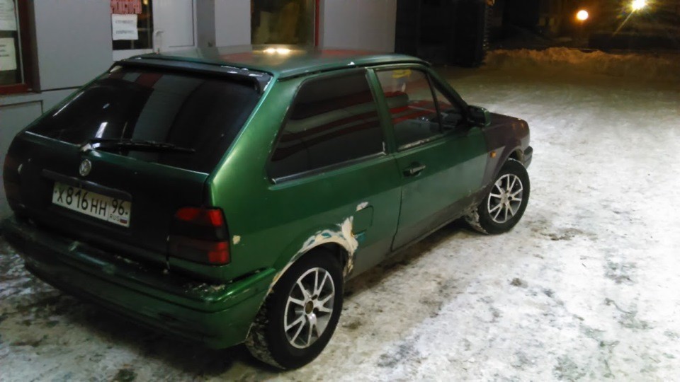

After installing the bumper, we have this look:
In the same winter I changed the rims on winter wheels and set the taillights Hella redblack

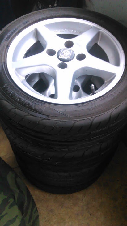

And for summer time I bought a set of VW motorsport rims on Yokohama S-drive tires

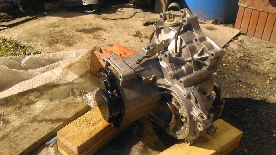

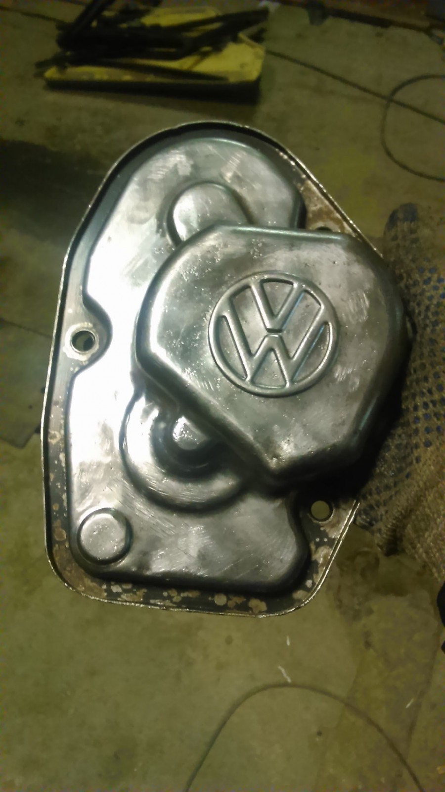

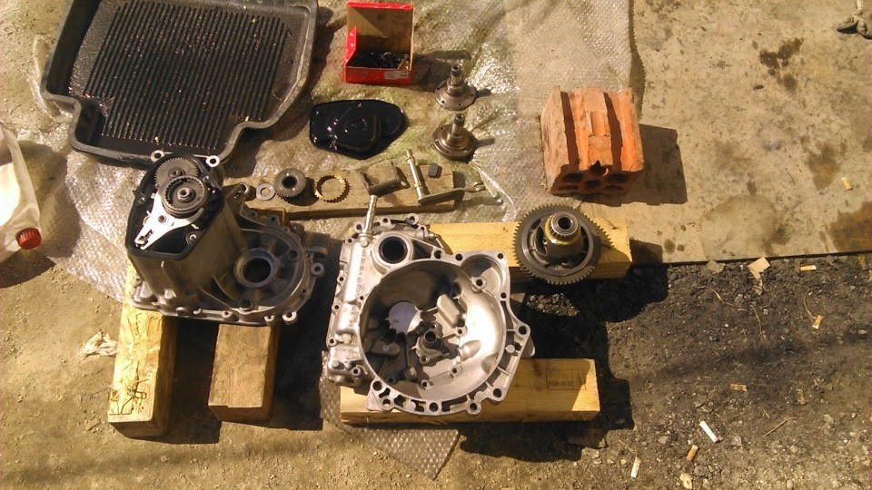

I found a 5-speed gearbox with an index of 8P:

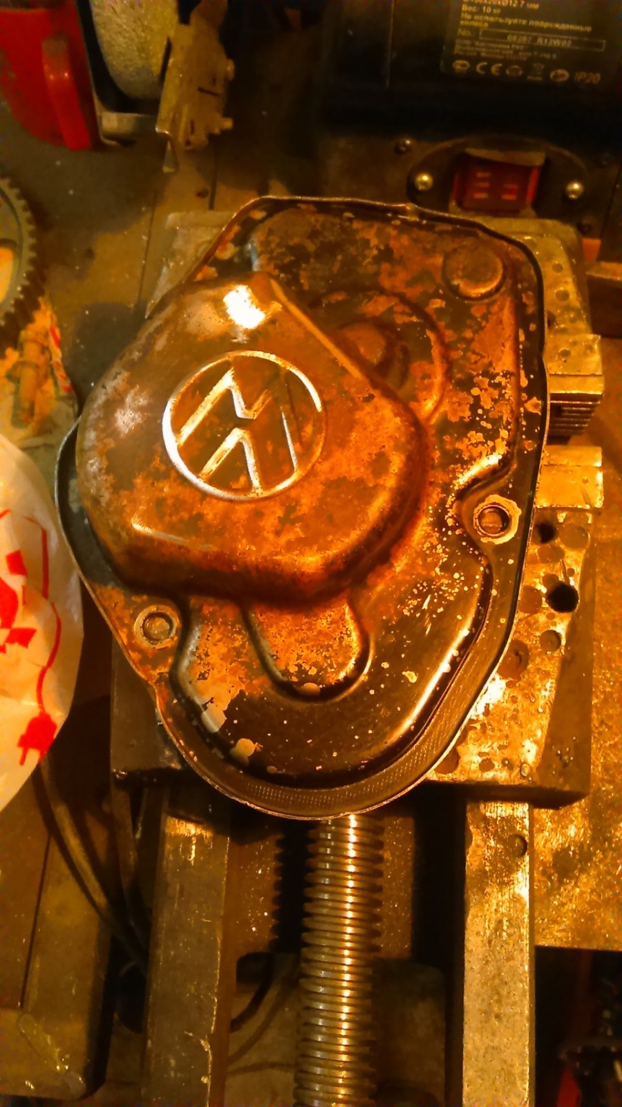

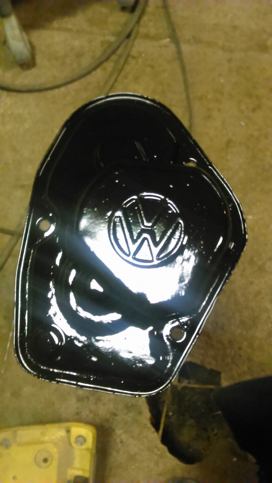

Cover of fifth gear was in rust:
This has been fixed:

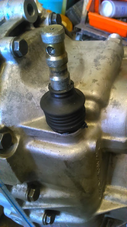

The gearbox was not completely disassembled and washed:
All seals have been replaced. And also added a dust-coat on the gear selection shaft.

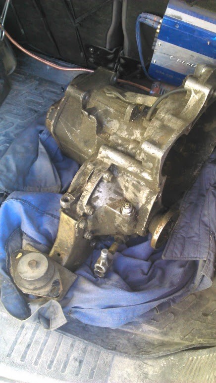

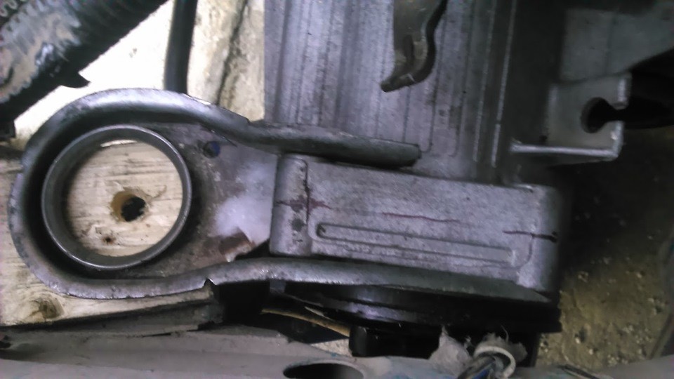

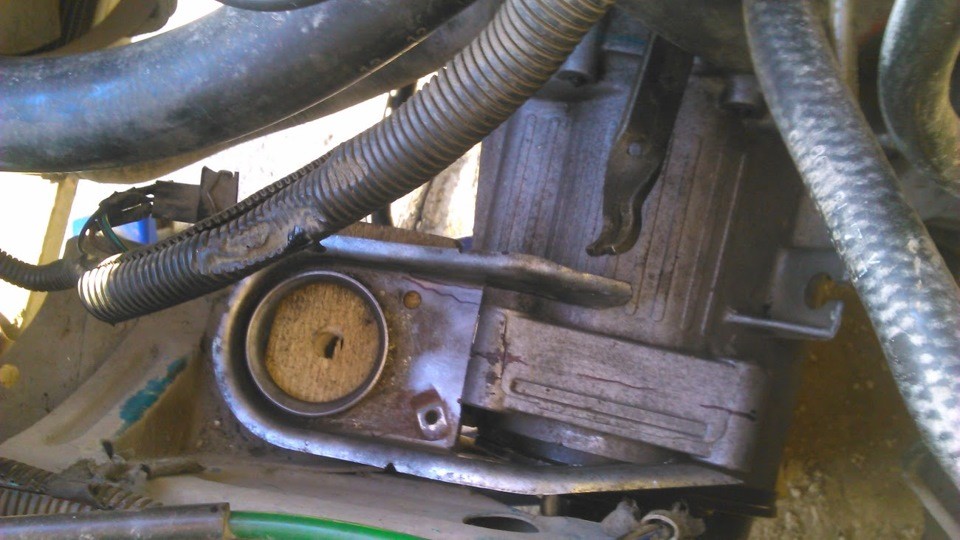

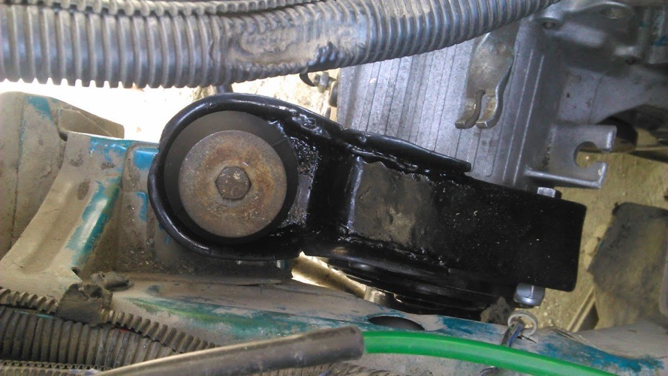

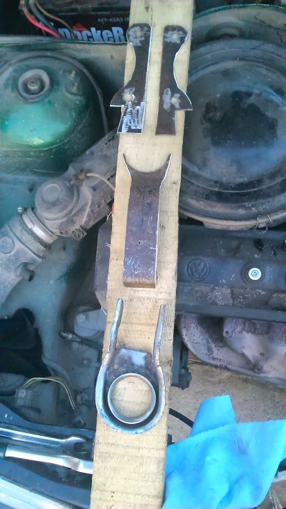

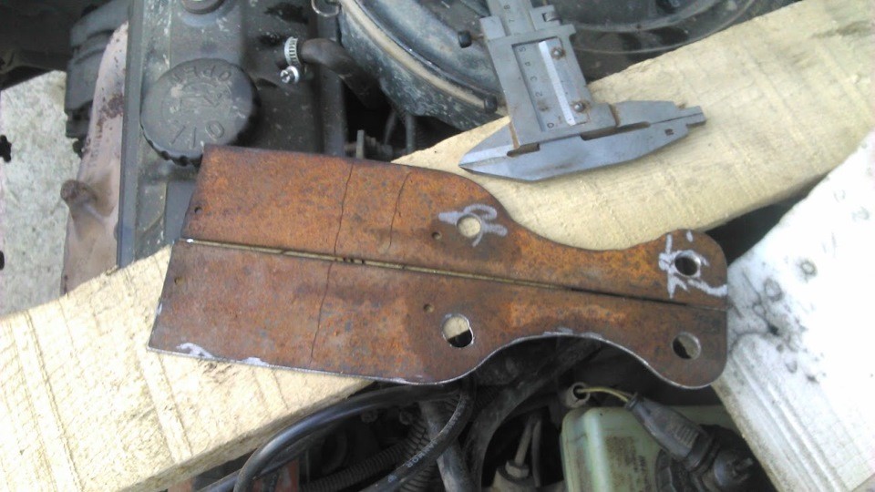

Now a few words about the gearbox bracket:

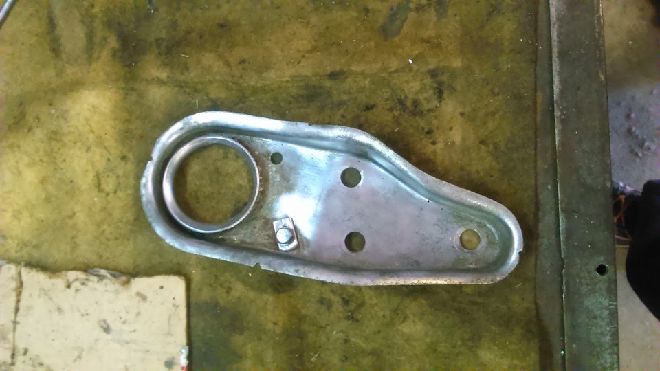

It is not suitable for 085 gearbox, and I couldn't find a factory bracket...
Using the angle grinder, I cut off all the excess metal from the bracket and attached on the right place:
to be continued...

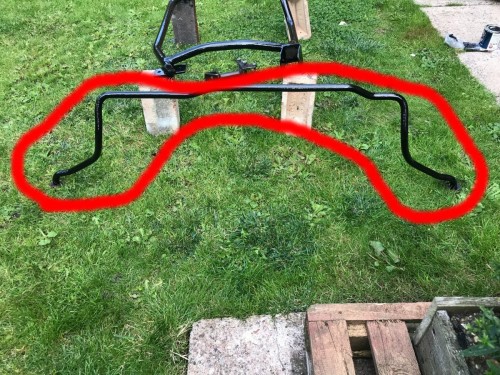

Youll need a 5speed anti roll bar too. 5speed gearbox mounts are aroud

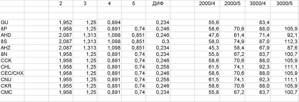

There is such a chart that shows the gear ratios of the boxes.
In general, my 4-speed gear ratios were exactly the same as the 5-speed, but there was no 5 gear.
The old gearbox had the index AKY.
Can you show a photo of thing about what you talking, please.
Edited by Eskey
mk2f should have the correct arb...its the bar that ties the the lower arms to the car
speech is going about non stock details?
I apologize for the misunderstanding, I think I understood what you are sayed, I highlighted this detail red
Image result for polo mk2 anti roll bar
this part here...some early cars had what we call a 4 speed one , later cars all 5 speed bars regardless of what gearbox was fitted
Now I have a 100% understanding of which part we are talking about, we call it the stabilizer
Which diameter of arb on 5speed body?
Edited by Eskey
same diameter , differant shape to clear a 5 speed
i dont have a picture to compare them , im confident your car has the correct one
And I already thought that at the 5speed it is more powerful, but most likely I have the right one installed, because nothing hinders the box

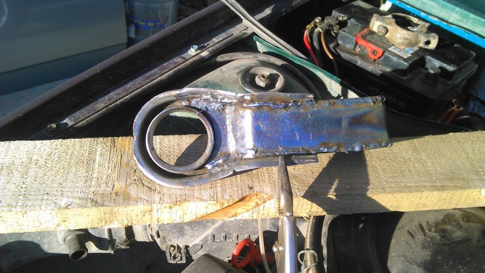

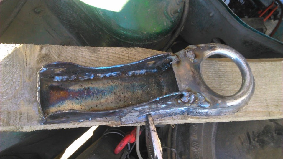

Hi, I continue my story about the Smurf.
  After sawing off unnecessary metal from the bracket, I have bended  the edges inward:
Then I cut metal plates and made a holes for mounting bolts in them:
I was needed one more plate, and cutting it out, I prepared all of them to assemble the bracket:
Then it was all assembled in one element and welded off:
It was my first experience in welding.
So don't kicking me so strong)) (Joke, of course kicking))))
Now i need to go sleep.
 Bye bye!!!
That's ugly but not at all bad for first welding. It has to hold the weight of 1/3 of engine and gearbox.
I took the metal of the same thickness, like the bracket, it has been used for more than two years, likely all not so bad, if nothing broke off

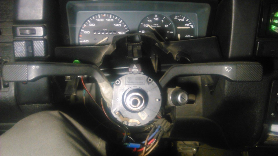

Hi all.

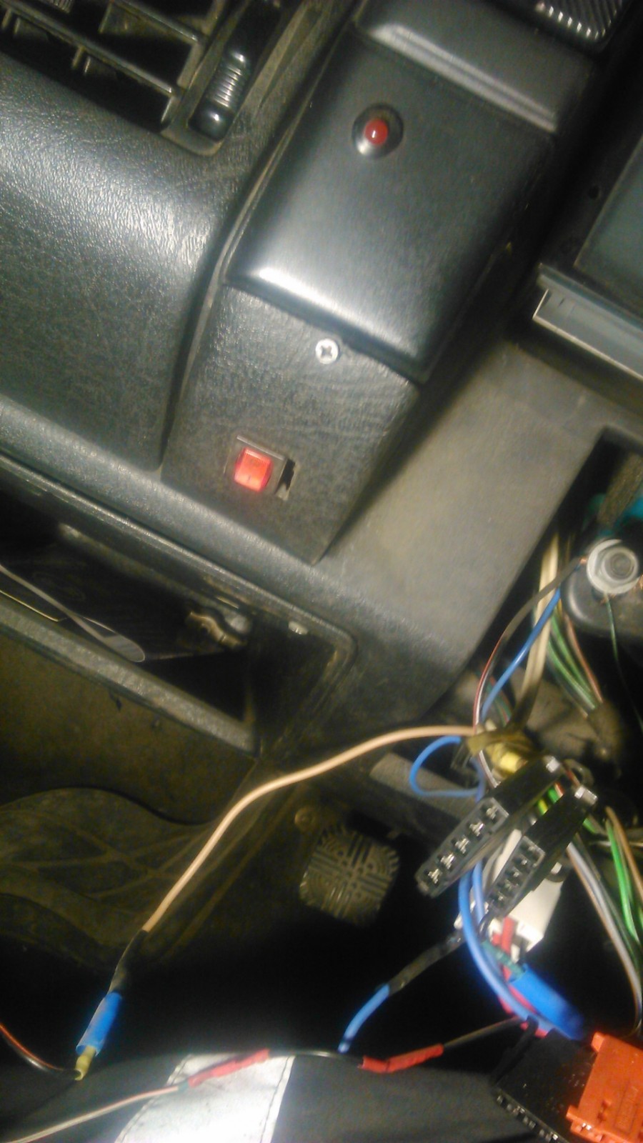

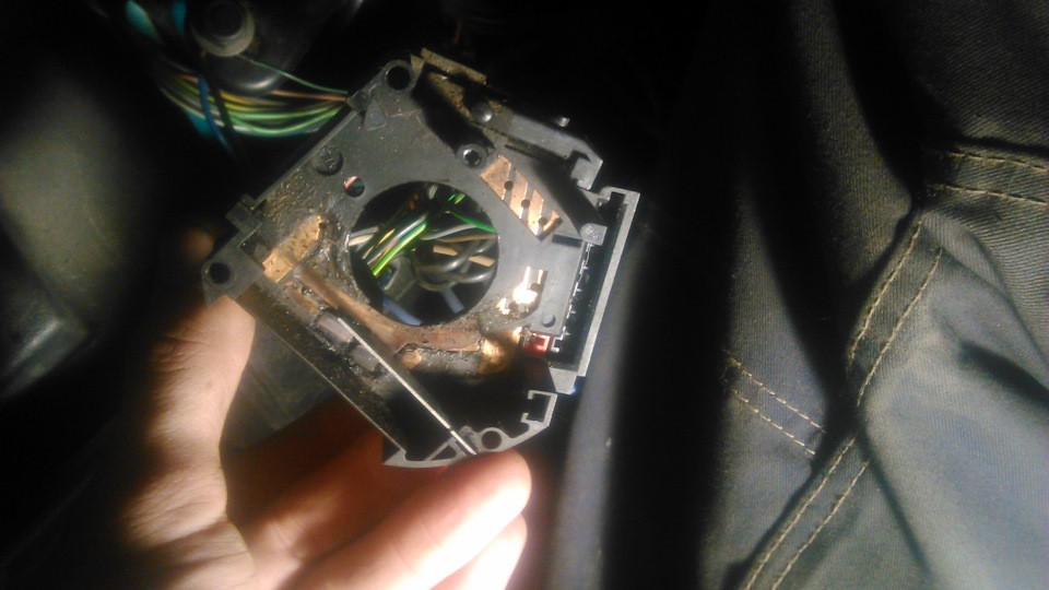

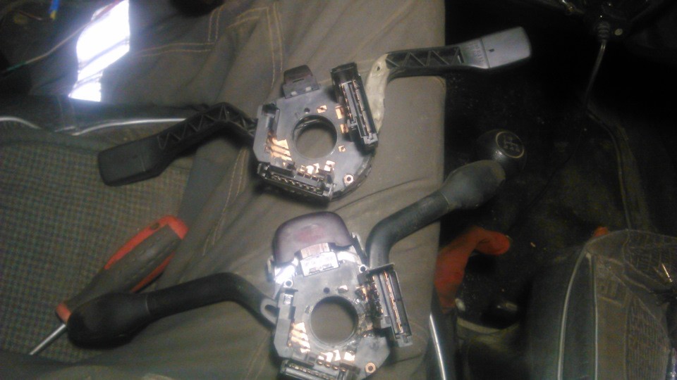

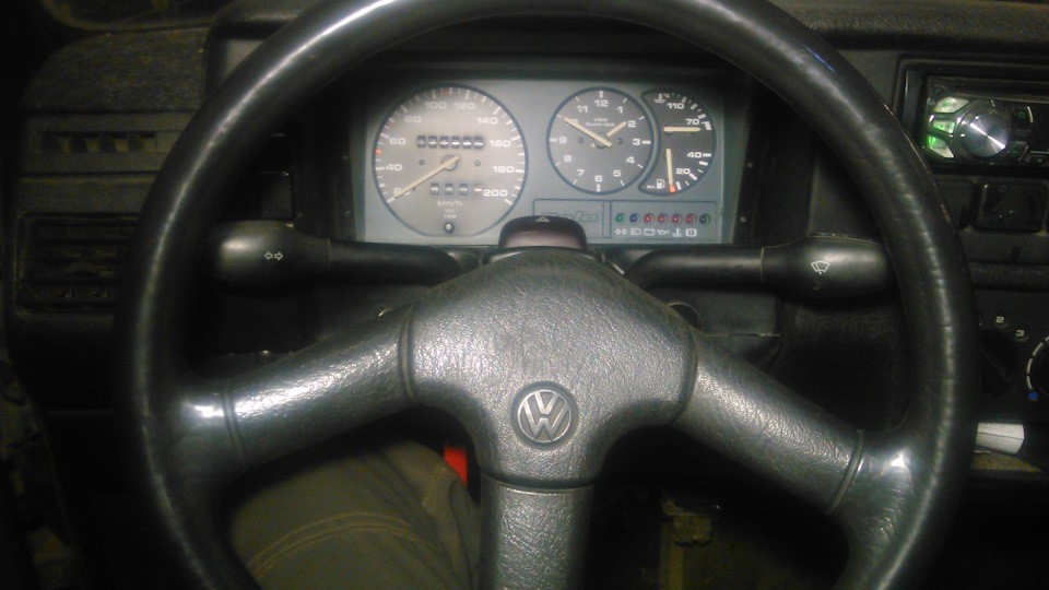

The following works were performed in the cabin, in particular with the high beam and turn signal switcher, I apologize in advance if something is not correctly named, we calling it a dragonfly or guitar or helicopter:
The high beam didn't turn on with correct switcher, but by a separate toggle switch, and the turn signals did not turn off automatically after turning the steering wheel to the straight position.
Here is a toggle switch:
This toggle switch was working even with the ignition off.

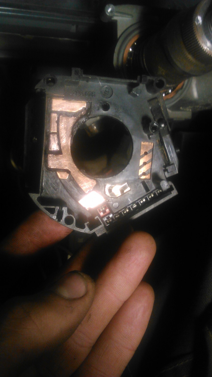

I bought a dragonfly from golf 3:
 and before installing I decided to look inside:
Then I blanched the contacts and smeared with plastic silicone grease, because dust does not stick to it...
assembled it, and installed on right place
it's new design looks pretty good and not bad blended with interior of cabin.
That's all for today, i hope you will understand my words, and if something will be unclear or was not correct translated, please correct me, this way I can learn English faster.

abrade would be correct ...or just say 'cleaned up '
I only managed to clean them with a screwdriver. It was resistant dirt.
