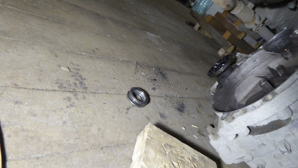

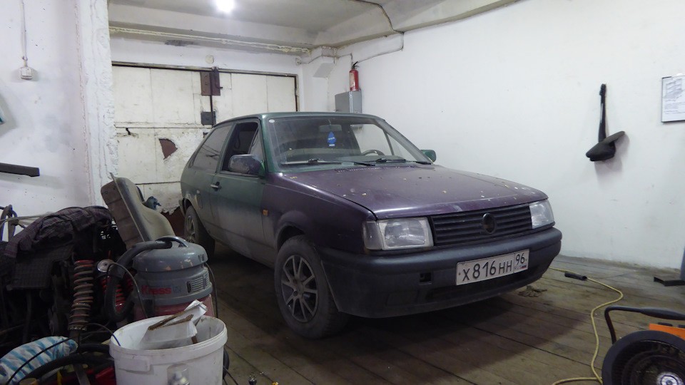

In the spring '2017  the clutch was broken, when i was driving up to the home where i living, the clutch pedal has dropped down by the action of foot and not moved up.
After towing the polo to the garage, I have started to unscrew
 gearbox:
When I removed the box, a part of the clutch bearing fell out of the clutch casing, and at the moment I understood - clutch is wasted))

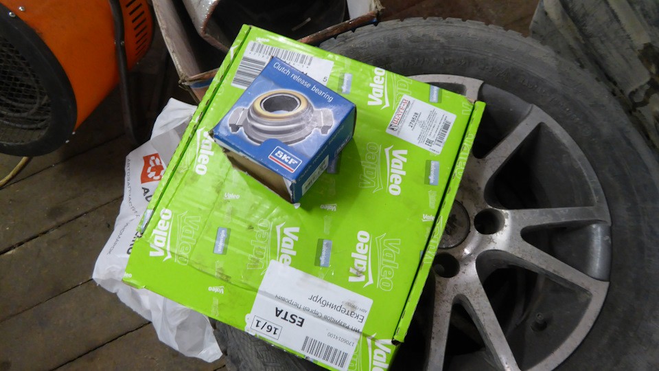

A new clutch kit was ordered, but components from different manufacturers:
clutch cover that was broken and which is broked out a clutch bearing is rightside:
Also have changed the bearing pilot and clutch release fork lever.

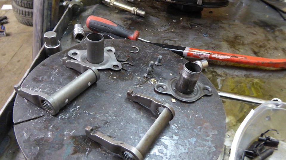

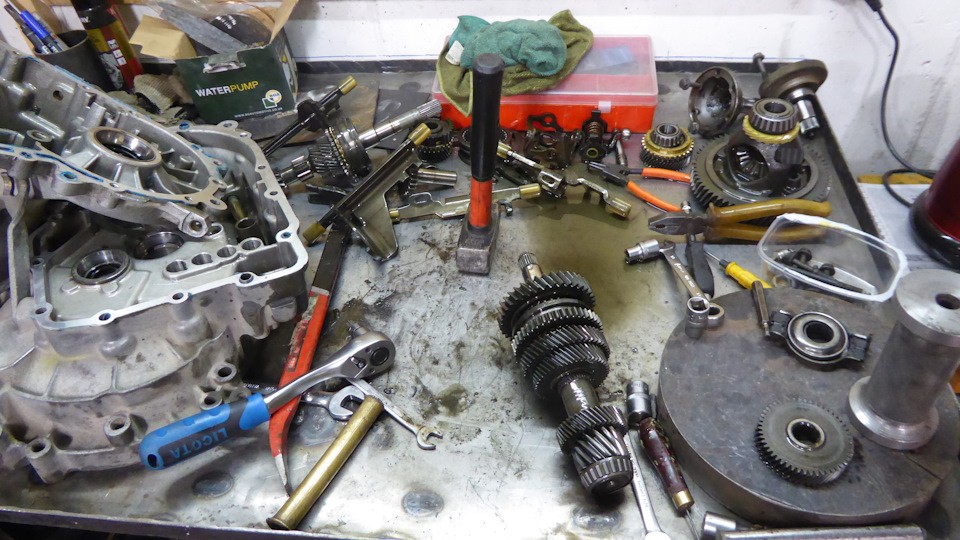

Then I opened the box to replace the second speed synchronizer assembly:

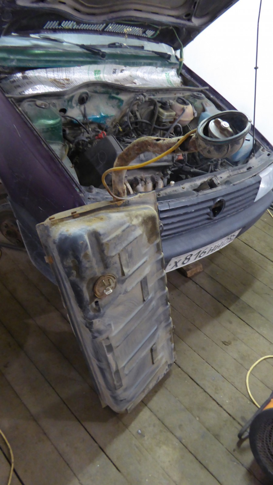

I also had to inspect the fuel tank neck, because fuel was leaking on parking place:

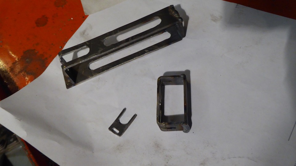

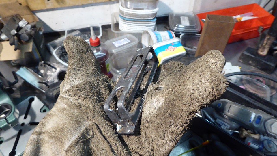

  • Hi, I continue my story about the Smurf.   After sawing off unnecessary metal from the bracket, I have bended  the edges inward: Then I cut metal plates and made a holes for mounting b

Hi all, I continue my story about my smurf, last post I finished in the beginning of a story  fuel tank neck.
  Since I can't use a welding, I bought an epoxy repair kit, in which contains - fiber glass, and epoxy with hardener.
  Then using own hands I used that kit on the fuel tank neck.

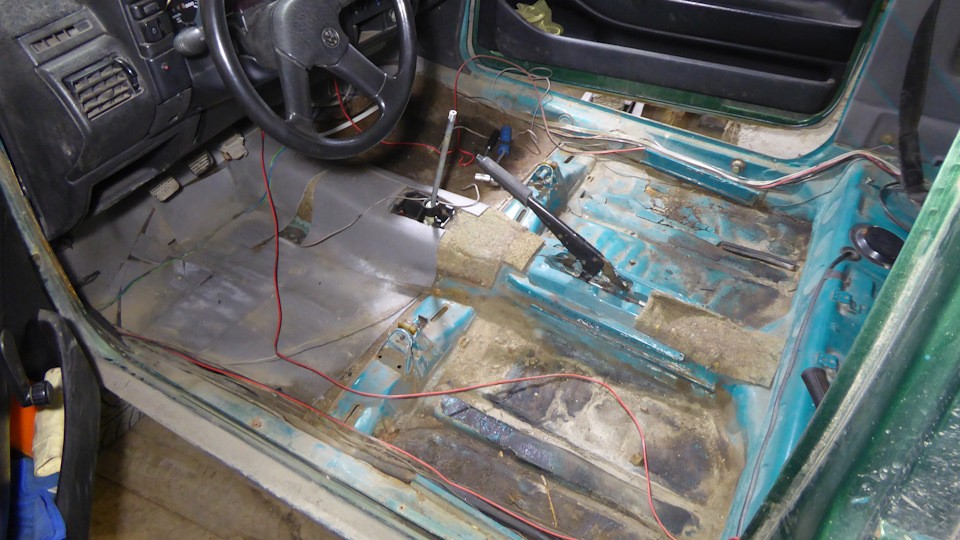

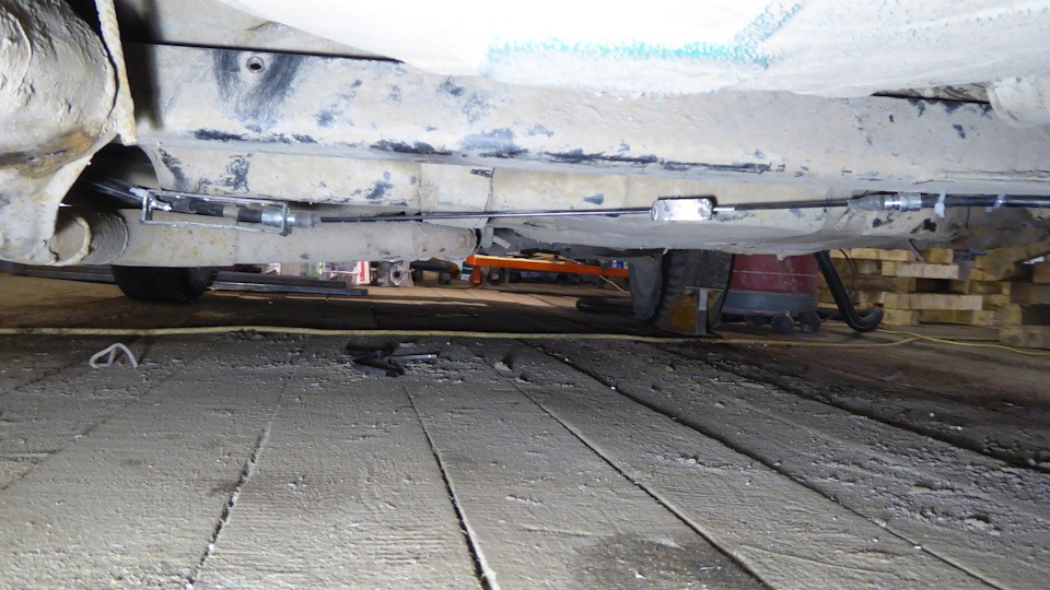

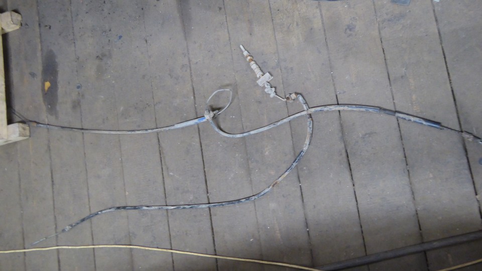

The following work was performed on the handbrake system.
My handbrake was worked very bad, sometimes was not turn off, because a brake cable was old,
and from another car,  presumably from the Lada.
Some people very often offer me a solution in the form of replacing a faulty part with a part from a Lada,
I only think - you have bought a import car for make from its a lada))) No, I,m not like that))
Then after talking with good people, I made the factory handbrake fixtures.
So that was work, which I was made about the handbrake, because it's necessary joint.

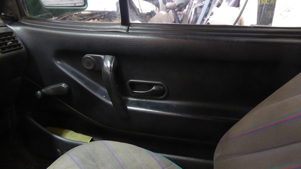

In the April of last Year, I found some elements of the cabin.
It was a very lucky case.

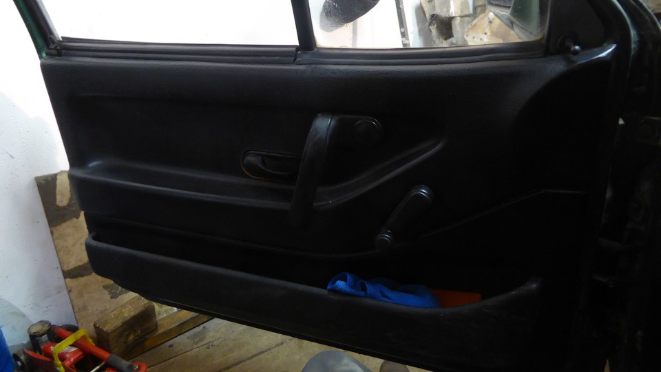

And first of that positions is... - we call it "door card", what is screwed to the door from the cabin.
  They are in excellent condition:

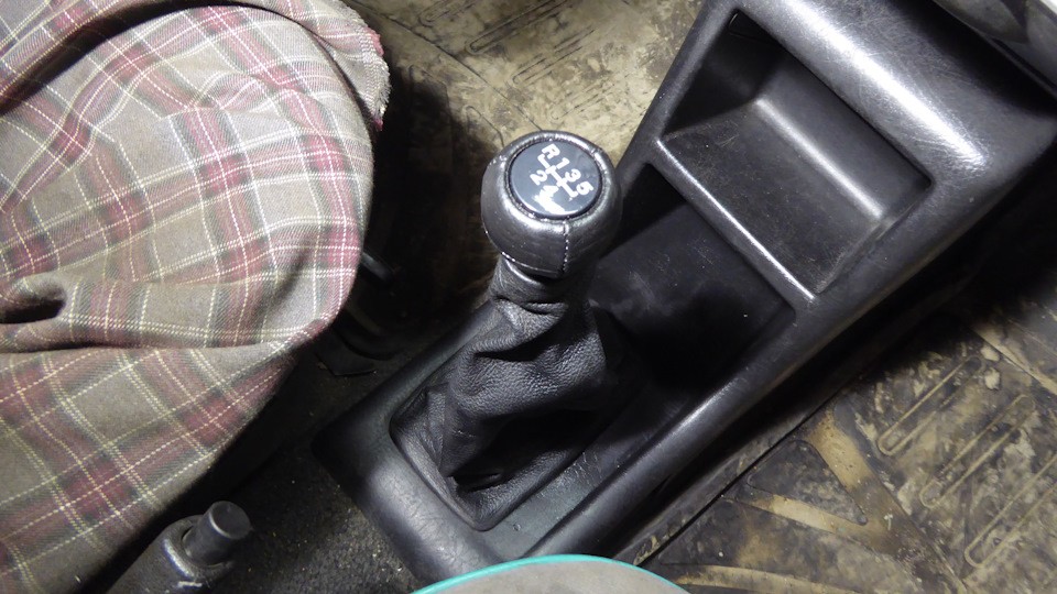

  Also in my cabin was missing a central console, we call it a "beard")) and it was installed with new handle of gear lever:
Then I installed a damping ring on the shift rod or gear gate(I don't know how is correct call).
In advising to all - install this ring on autos, and you will see how it works. Part number: N 901 237 01

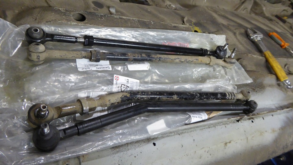

And I have changed a link arms , because alignment technical assistant advised to me:
Link arms(left arm) which was Installed by previous owner , is adapted to tie rod of Audi B3, so it's some resourceful, I think so. But I don't started to find a new tie rod - because a silent block has lost its grip, and solution of this situation is replacement of the rubber detail, which is fundamentally out of stock...

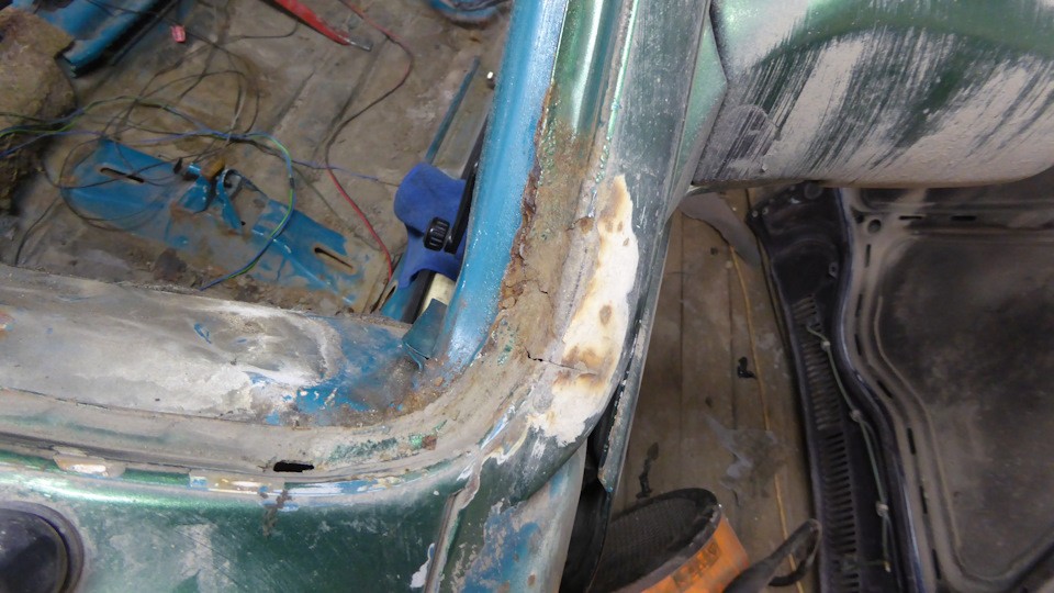

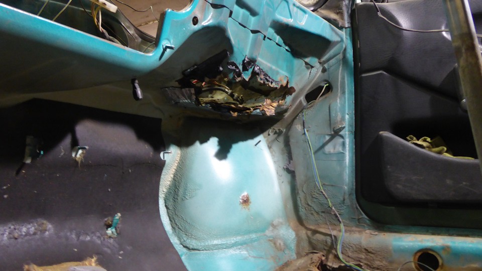

  In November '18 i have run car into garage and knocked down a vehicle.
  Body of my Polo is in sorry state really.
The passenger side have such look:
And next photo is a driver side:
Wheel arches have a local rust, but the bottom of them needs to be changed.
Body was impact In the left side member, in the past somebody has tried to repair it.
So here i finished a exploration of body, next i started a restoration...
