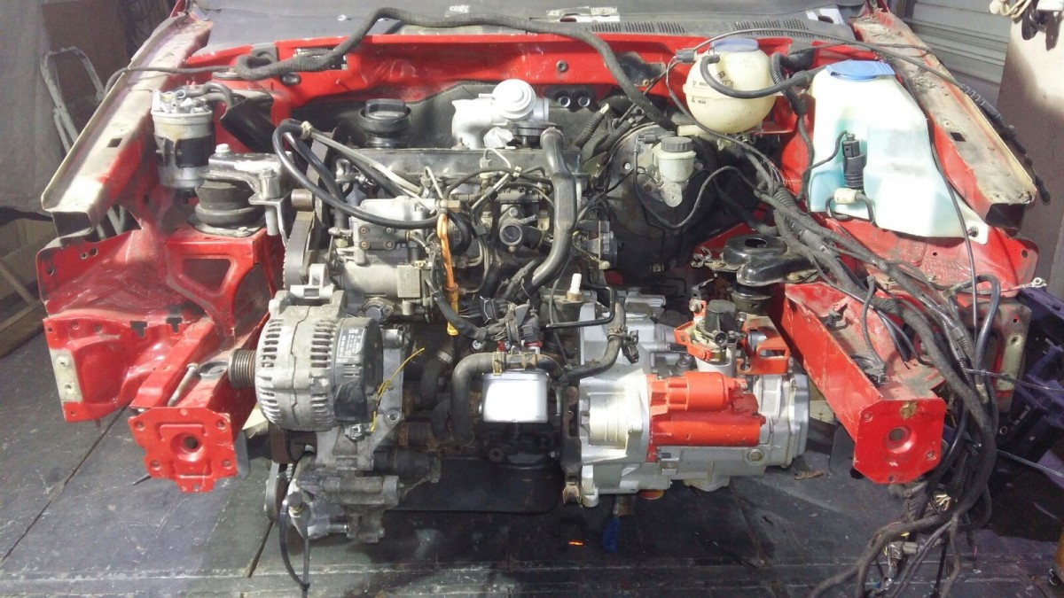

Guys, here some pics of the only Polo 6N 1.9 diesel been delivered to The Netherlands and nowadays the only 6N1 open air with an 1.9 tdi  actual setup 154 hp ... to be changed to 200 hp.
This was the first car of my wife (bought new) and after 190.000 km we thought it should changed to a red dragon with a little bit more power.
So based on the original car with the 1.9 AEX SD we built in the AFN 1.9 tdi engine - Polo Gti interieur - front brakes from the Gti and also the original BBS from the Gti. Our car had 13" and now we are driving 15".

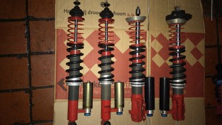

Still to do: Original coilers from ralley Sport to be installed/ axle back from the GTI to be installed/ seat heating to be installed / an original radio (searching)/ the right airbag to be exchanged .... or eliminated (original was only one).
