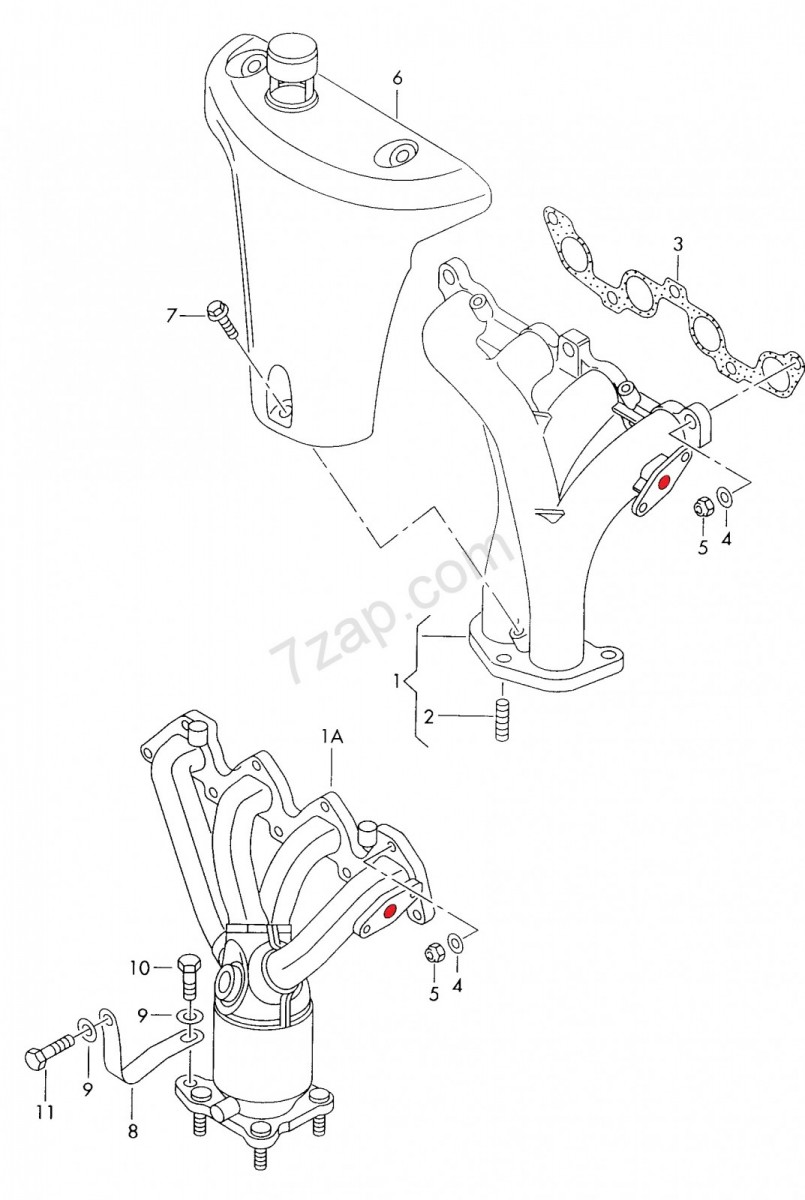

I wonder if the little filter #17 https://volkswagen.7zap.com/en/rdw/polo+derby+vento-ind/po/2001-240/1/133-133011/#17  could be partially blocked not allowing enough vacuum pressure to fully open the valve so giving the EGR Low flow detected ?
From memory on my Ibiza the wiring from the post cat lambda run up to the bulkhead then across by the steering rack then forward to the disconnect, so yeah the lead would need to be a few feet long, but it's quite possible atsome time in it's life someone couldn't be bothered to unclip the full length of the wiring and just cut and spliced it ??  https://volkswagen.7zap.com/en/rdw/polo+derby+vento-ind/po/2001-240/9/971-971018/#61 this is where it should connect too, down at the front of the engine

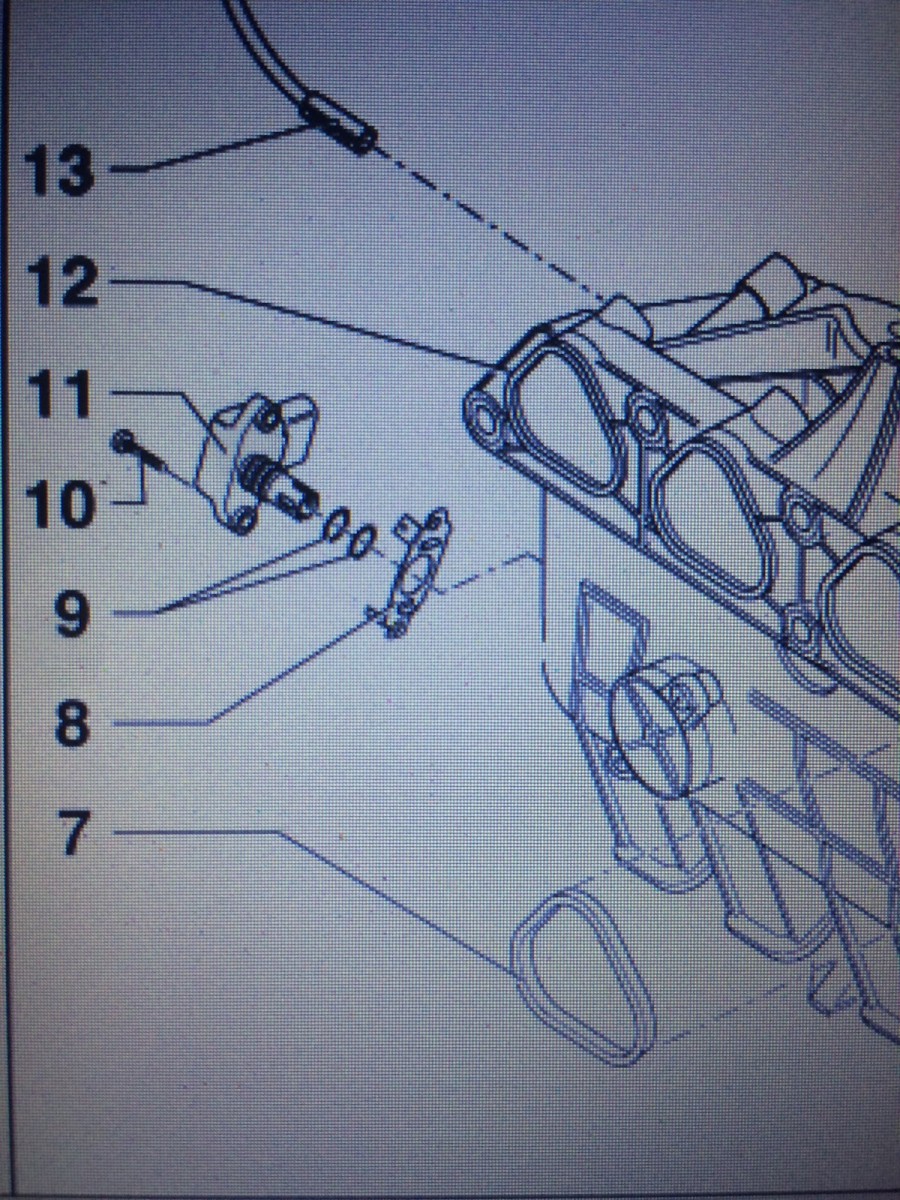

The hole in the mainfold should be good and clear, and though the adapter #35 in the previous diagram
Ok the little air filter is free flowing. Im gunna take egr off tomorrow morning and clean manifold side. Ill splice the rear 02 sensor aswell. Fed up with this bloody thing!
