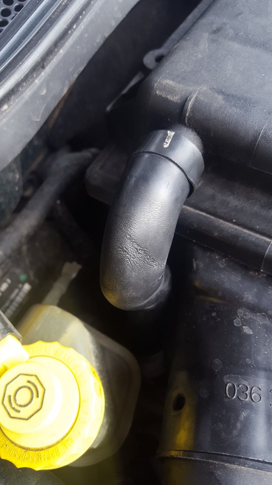

OK that sounds like the heater element (pipe 28a in that last link) they introduced to stop the pipe freezing up, if the oil is on the outside that sounds like it could be split, no chance it's just spilt oil from a top up ?
Yea that looks like mine. With the plug in middle. Yea it looks battered by the airbox. Cant be arsed to pull airbox off again but thr pipe is oily halfway down and ive attached pic of top. You can see condition. Is this likely to be causing my problems?....when i run it to atmosphere car feels abit better just effing stinks (obv)

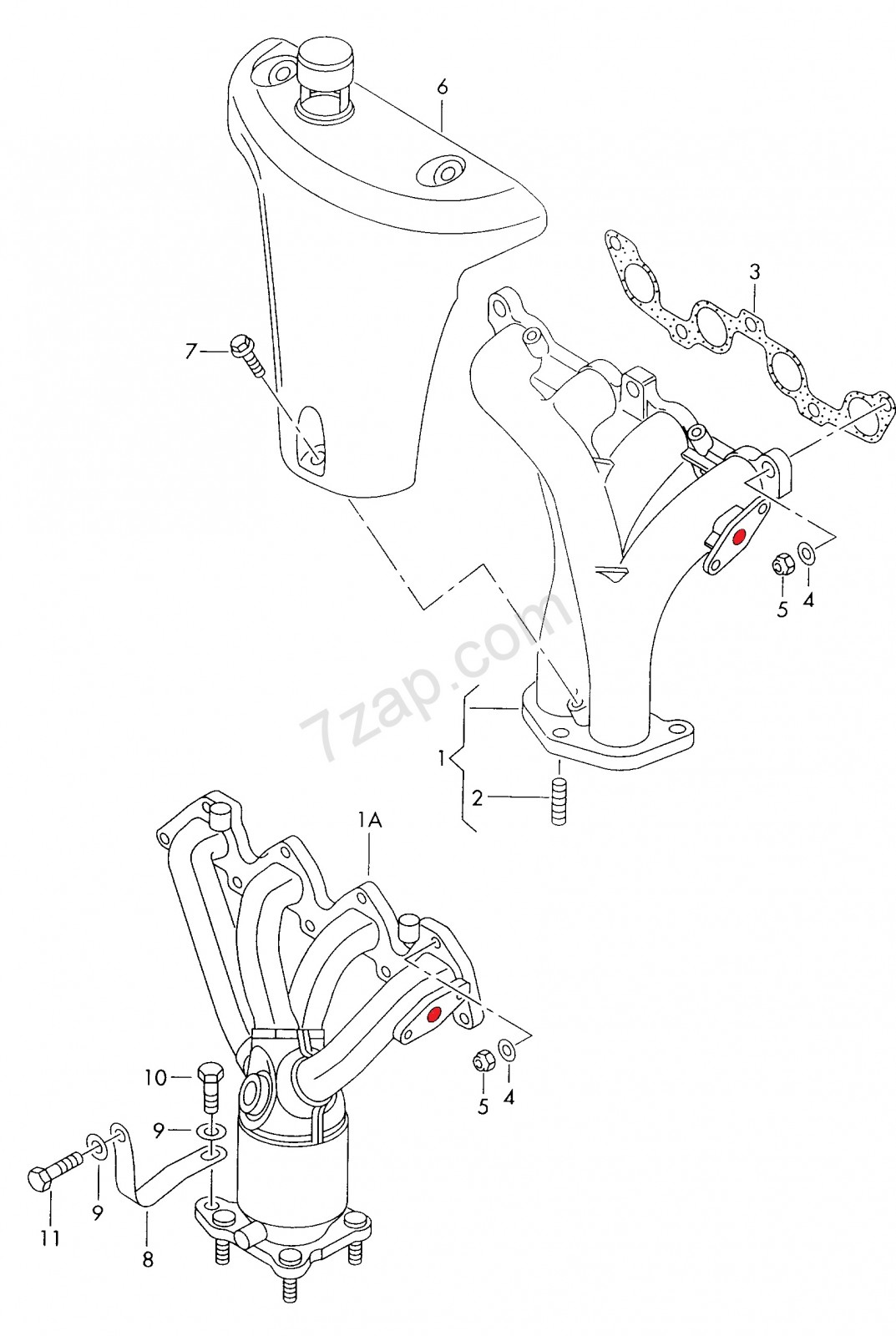

No the hole into the exhaust manifold where that adapter bolts onto it
The area's I've highlighted in red
Yea thats clear too. Sorry my bad explanation.
