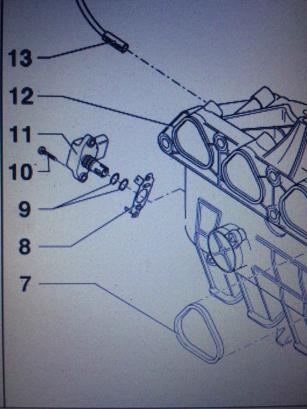

20 min later back on with epc light. P0106. Also car stuttering around 2000 rpm. Im still going to see the vcds guy on the weekend but ia it worth replacing the map sensor? And if so whats best way to access it ( i may have asked previously )
It might just need a clean, it is tight to remove it but it is possible, just 2 torx self tapping screws hold it in and there is an "O" ring to seal it, so if you have JCB shovels for hands you'll struggle if not a torx bit in a 1/4" drive ratchet and you can get on the screws ok, if you do clean it only spray it with carb cleaner, don't use a brush or anything else as they are quite delicate.
