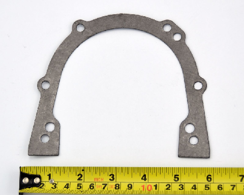

I purchased a genuine elring seal: 028103171B
I purchased also a gasket: 026103181B
I did not use the gasket because it did not fit so i thought because the crank seal had a rubber lip on the inside housing, that they might have updated the design therefore not needing the gasket.
I got the part numbers from: https://volkswagen.7zap.com/en/rdw/polo+derby+vento-ind/po/1998-158/1/103-103005/#15
I also noticed that the actual seal that goes around the crankshaft was in two parts. a thin back seal and a front thin seal.  Not quite sure how you install that. Anyway got a pretty big oil leak.
Pictures below to show what i mean about the inner rubber lip on the housing.
crankseal.png.8e9f5c17e3b70b5e7c5d46ddc69959e7.pngcranksealgasket.png.8754024076ef64f27570cbd6e031f2e5.png

That gasket fits loads of engines. Must be a crush gasket as Haynes wants bolts tightened in diagonal pattern for my engine.
Looks like the holes match. How did it not fit?

just been on ebay. alot of the listing now state the rubber lip now acts as the gasket so no other gasket required.
the reason my gasket did not fit because if you look at the lower legs of the gasket they prize in a little. I was sold wrong gasket shape.
But the fact that I did not use the gasket should not have meant oil leak because the  rubber inner lip acts as gasket.
