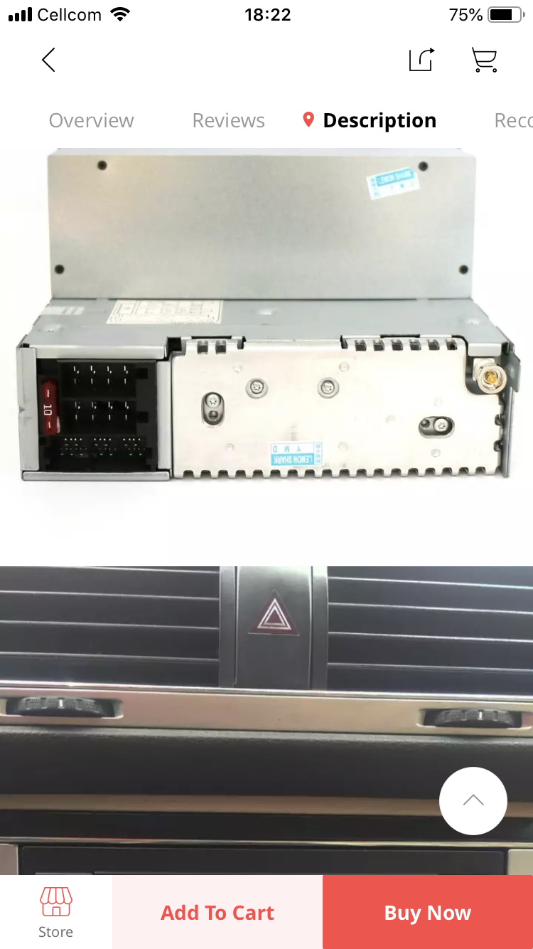

I would like to install the rcn 210 stereo from here https://s.click.aliexpress.com/e/MEjE3lf
but before I’m buying I wanted to know what cables do I need.
1. My car doesn’t have the original stereo, someone install cheap stereo so I will not be able to plug n play( he cut the wires) so I wanted to know the cables that  he’s giving is enough for the installation.
2. About the antenna. I need adapter from my antenna plug to the antenna plug of this stereo. Can someone tell me wich one I need?
3. I only need to connect the 12v, ignition, ground and speakers and that it? Or because of the can bus it will not work properly?

As the the aerial connection that will depend on what has been left in the car ? it might be a "Fakra" connector or a standard VW one ??
It’s the old and standard plug. So which adapter do I need to fit to this stereo?
thanks
By the year of your car, VW were changing the aerial connectors, so if you can get a picture of it and the new unit connector ? then should be able to say what adapter you might need
